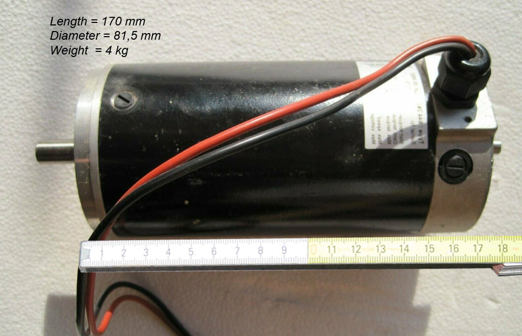

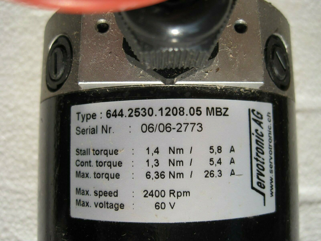

Tommy,
can i use this PWM drives with this babys and BRIH 40D1605A1000 Encoder on a MESA 7i98 Anything I/O Ethernet Controller?
Do i need a Daughtercard for this controller or can i wire it directly to the 7i98
Niko
Niko
