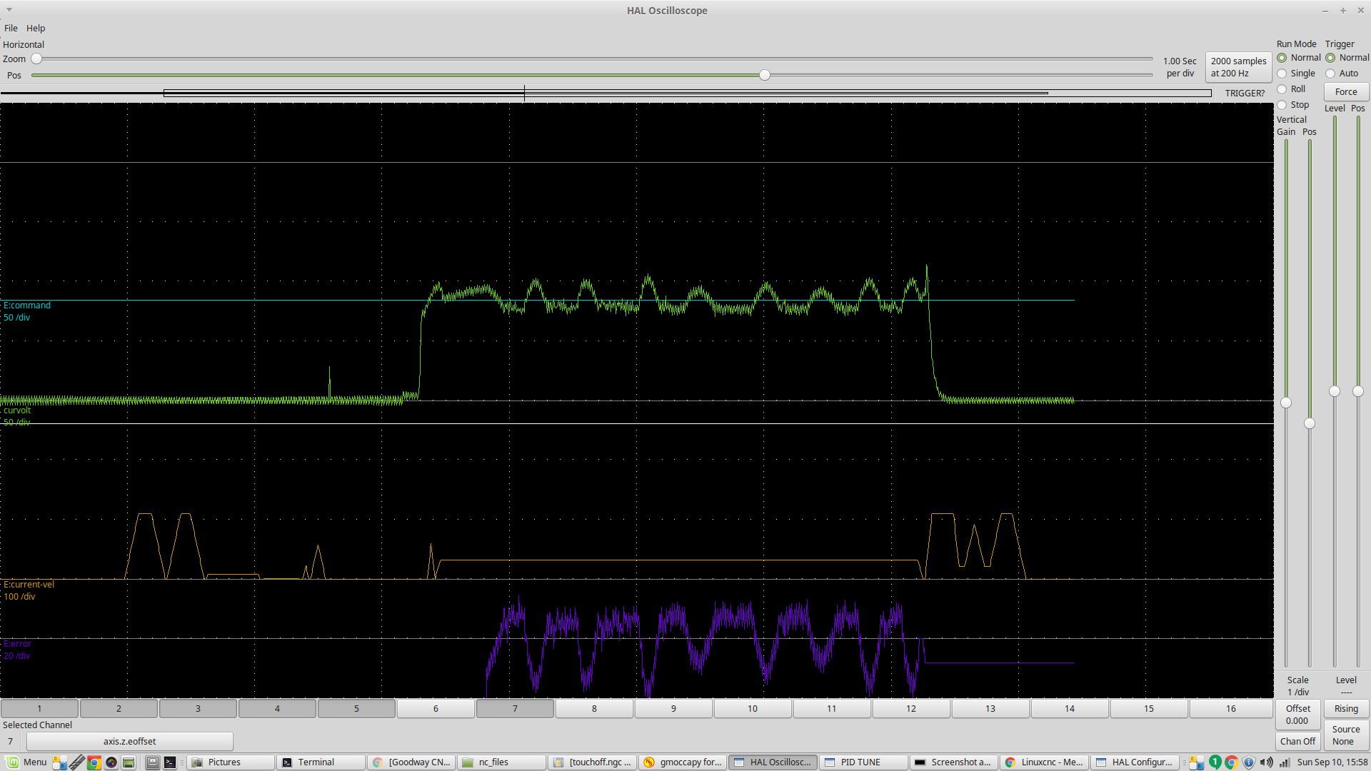

Well, I consider myself very fortunate as Dewey sent me a few emails and wrote about 7 pages of notes on how to proceed with setting up the external offset THC component he's written. So I've reverted to his sim for a couple of nights. The first step was to play until I finally understood what was going on and then copy my ini file config for each axis to the sim ini file. So that meant I now have a sim of my hardware. I also wrote another gcode routine so I could work in metric but still use his sim gcode that was in inches.
Using halscope as set up by Dewey in the sim, you can see the greenline (torch volts) overshoot the setpoint.
After some tuning of the sim, I got this looking better and eliminated the overshoot. Ignore the change in the white line on the left as that is when the simulated torch starts cutting. Its the changes in signals on the right hand side that we ware interested in.
I also played around with some velocity and acceleration settings. They did not seem to make much difference except very slow velocities also caused an overshoot.
So then I tried some of his test routines which varied the setpoint based on various wave forms that peturb the signal. Whilst this is the reverse of what we want to do (vary the feedback signal), it does give some idea how responsive the system is and shows its ability to follow changes in arc voltage.
Here is a sine wave:
And a square wave;
The example Dewey shared with me followed the square wave better than this as there were no curved line segments.

Well, I got the external offset PID control working beautifully!
Dewey has been a fantastic help and with his input, you can see the green line (torch voltage) is quickly pulled down to the setpoint of 85 volts (white line). So stoked. So its onward and upwards from here. What a relief after the hundreds of hours working on this software config.
Dewey suggested that the OFFSET_AV_RATIO should be set around 0.8-0.9 for plasma but this would leave only 10-20% velocity for touch off so it would be as slow as a snail...
I came up with a really cool trick. I was doubled the machine velocities and set the OFFSET_AV_RATIO = 0.5. So this meant that I had 100% of the machine's attention when controlling the Torch Height while the touchoff was also running at maximum speed.
After heaps of testing, I pushed the Z axis up to 110 mm/second but the acceleration settings were limited y the PID. Too quick and the signal became noisy and did not track the setpoint well.
So the trick to this plasma config is to tune your Z axis for maximum performance, create a modified ini file for the sim that reflects your hardware and then tune it to get best performance. Once happy with the way the sim performs, transfer the final sim settings back into your live config. In my case I was good to go!

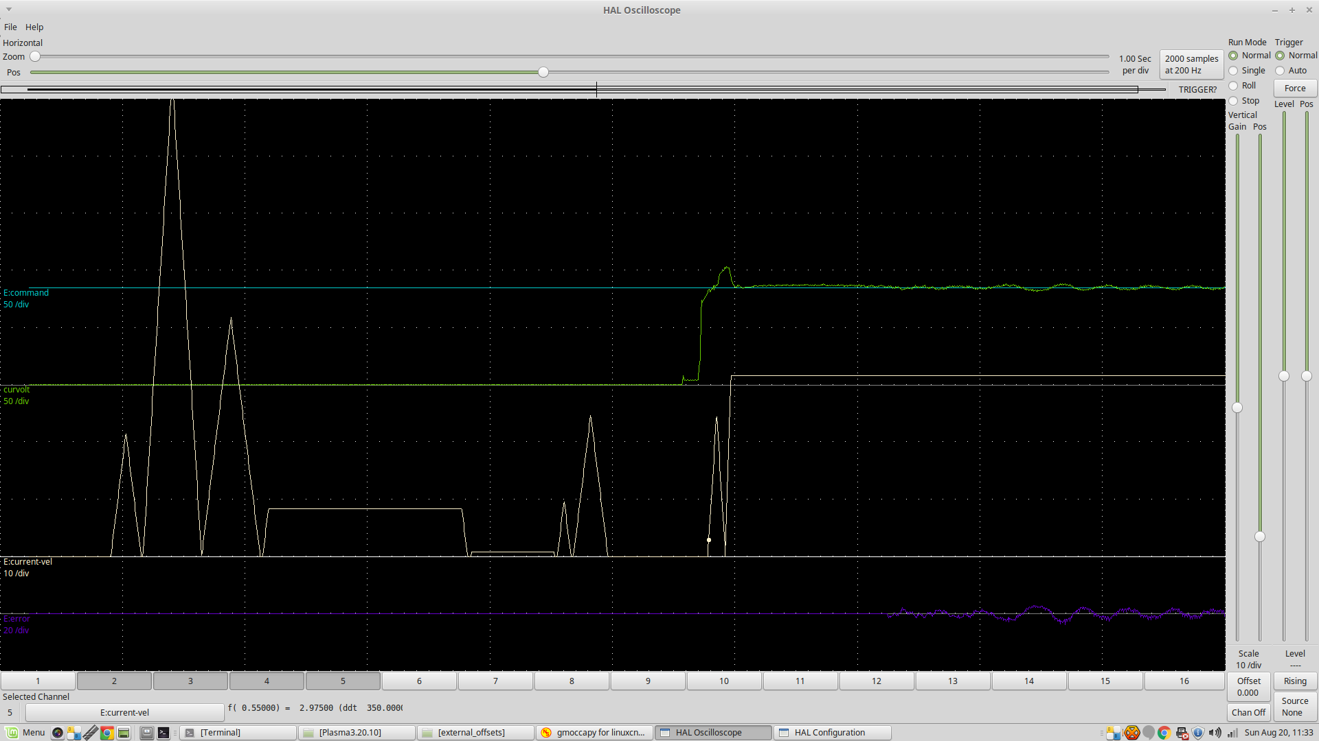

Well some electrodes turned up and a my plasma cutter is back on line. I still have to improve the tuning. Here is one of a few screen dumps I took today. I've marked where the THC is turned on
This is probably a bit more representative of what we want as the torch did not start on the commanded volts this time. There is a bit of overshoot and then it seems to settle down after about 2 seconds. I've got plenty more fiddling to do. I have not tried cutting up and down ramps or anything yet but on one cit the material was quite warped (probably enough for the tip to hit the plate and I ended up with quite a nice cut. I wasn't actually watching the torch, but it must have followed the contour.
One thing I have learnt is that my kerf crossing component needs work as it will crash dive if you run over a void!

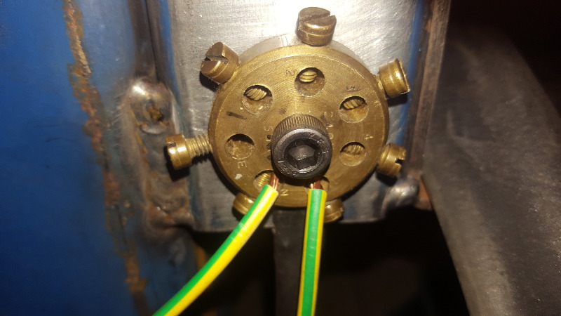

well, I've been pretty quiet on this thread for a while due some setbacks due to noise and an inability to get a functioning ArcOK out of the machine.
My friend Chris donated a very spaceship looking star ground point. I drille dout the centre stud, drilled and tapped the table leg and bolted it on top of the plasma earth lead with an M6 Bolt
According to Hypertherm, I've got quite a few more earth grounding wires to run but so far, I've grounded the gantry motors, the plasma machine and also attached it to an external electrical earth peg. It did seem to reduce the electrical noise quite significantly.
I did get a couple of test runs in but have made no attempt to tune the PID loop. At least its oscillating around the setpoint (rather violently though). I'm sure I'll be able to smooth this out with a bit of tuning.
Any pointers about PID tuning would be appreciated at this point.
