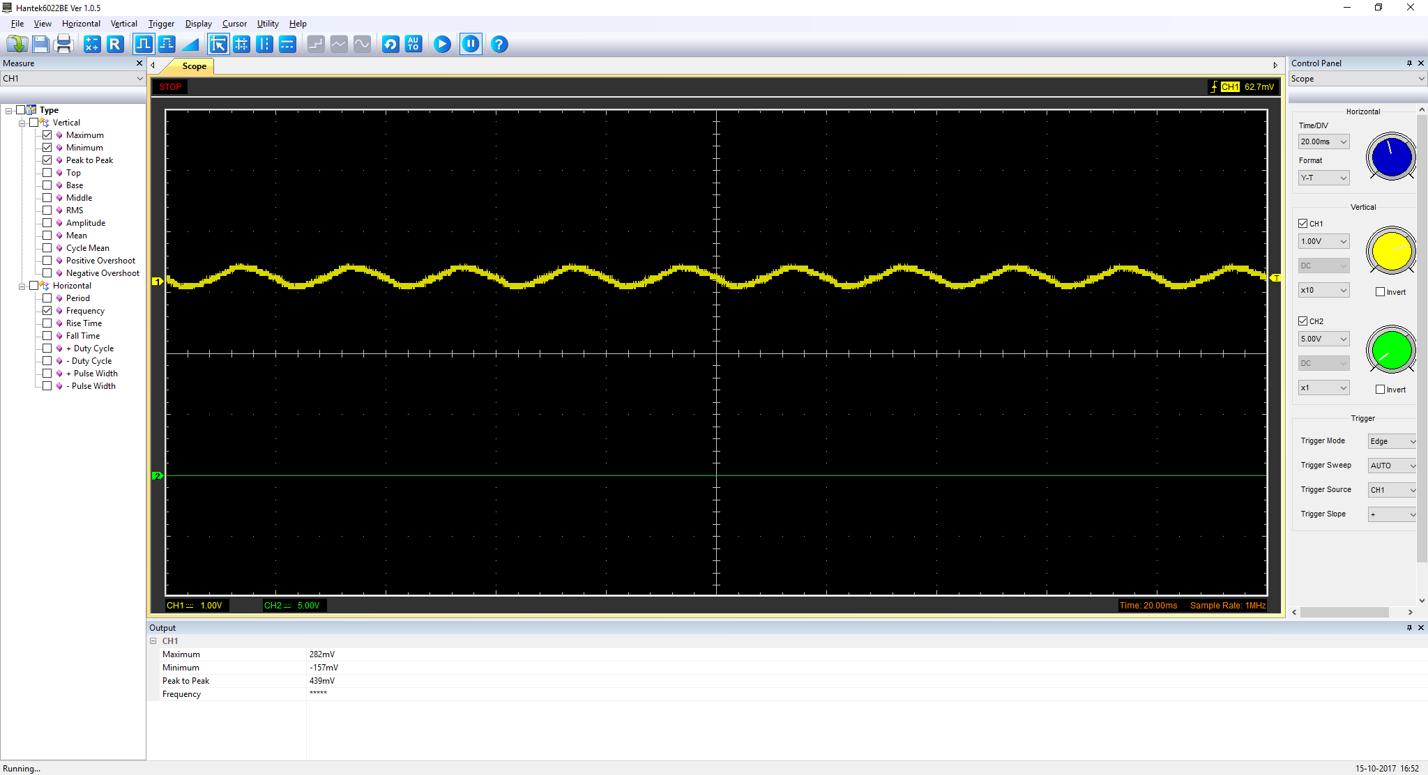

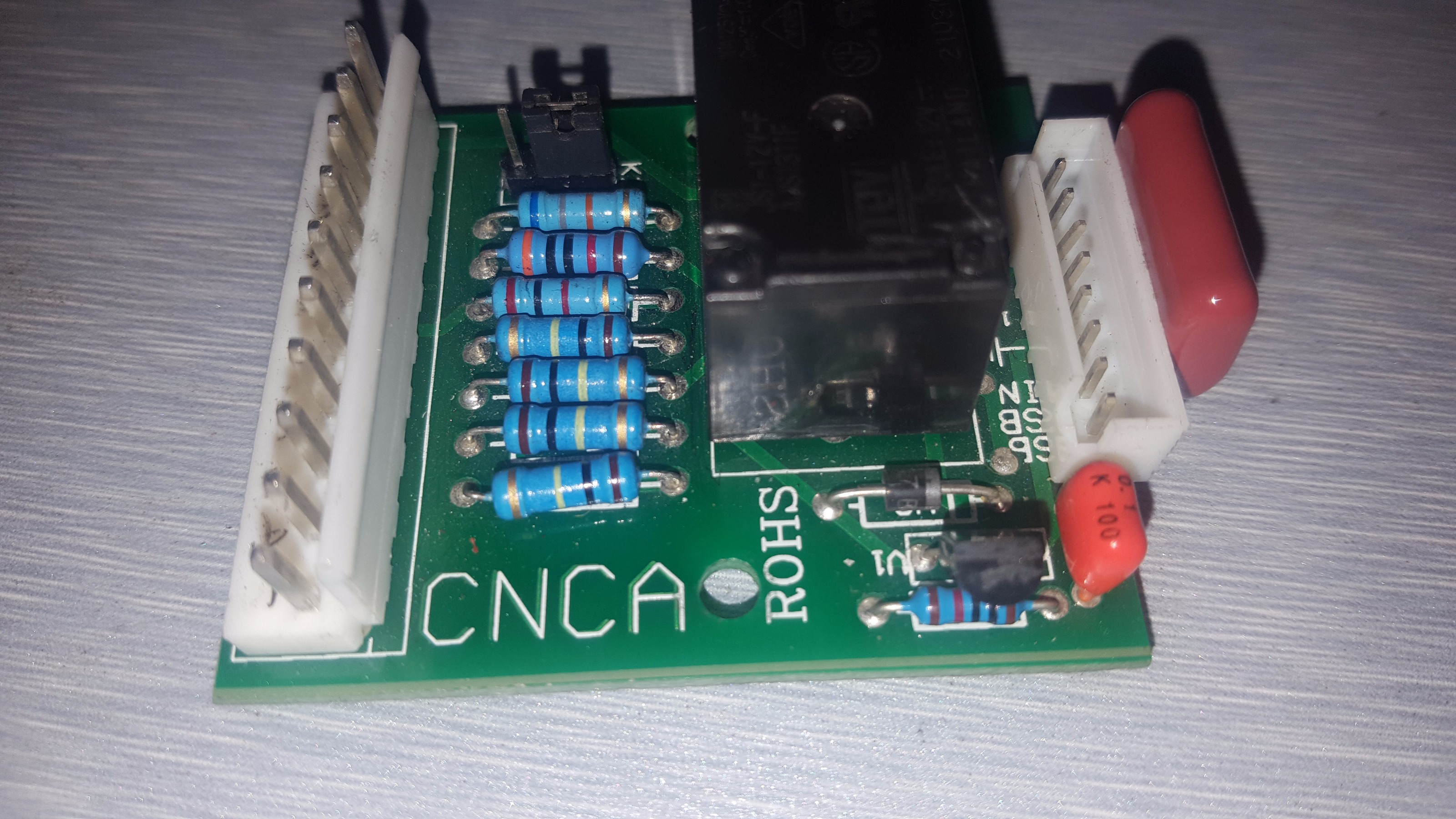

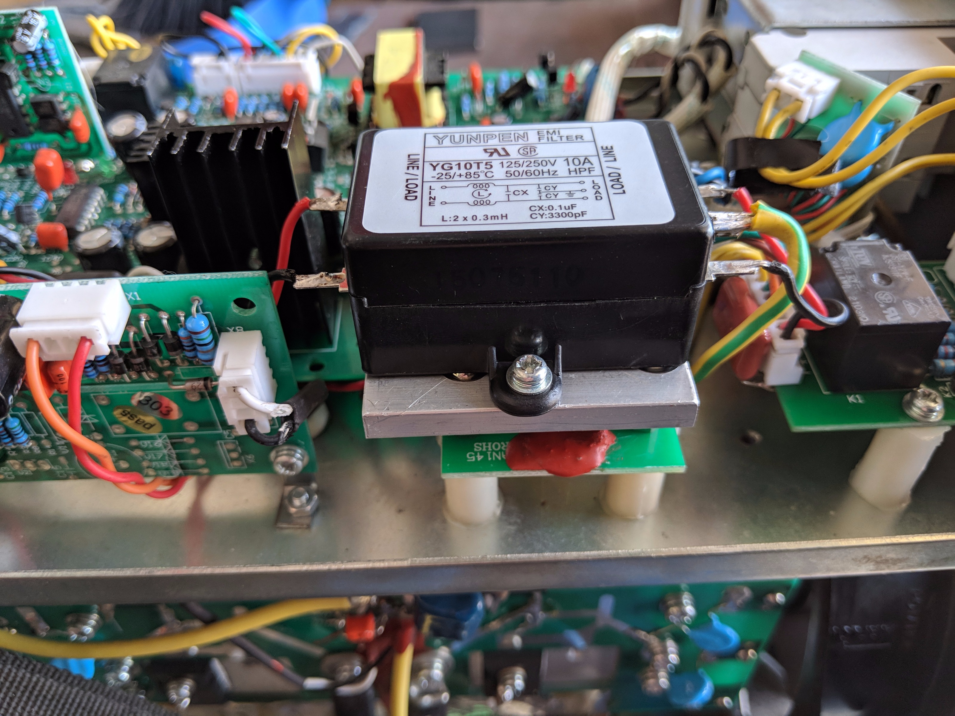

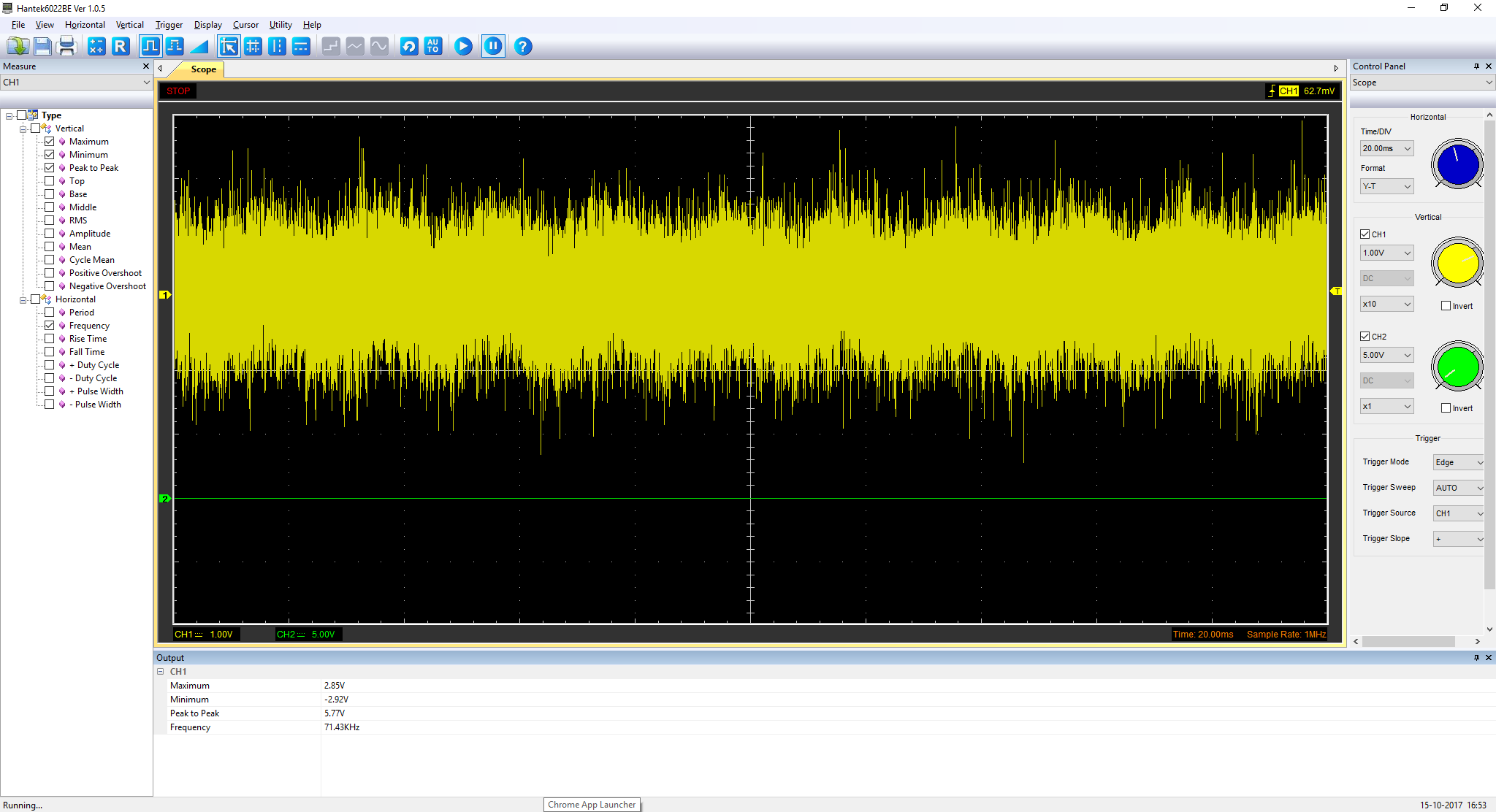

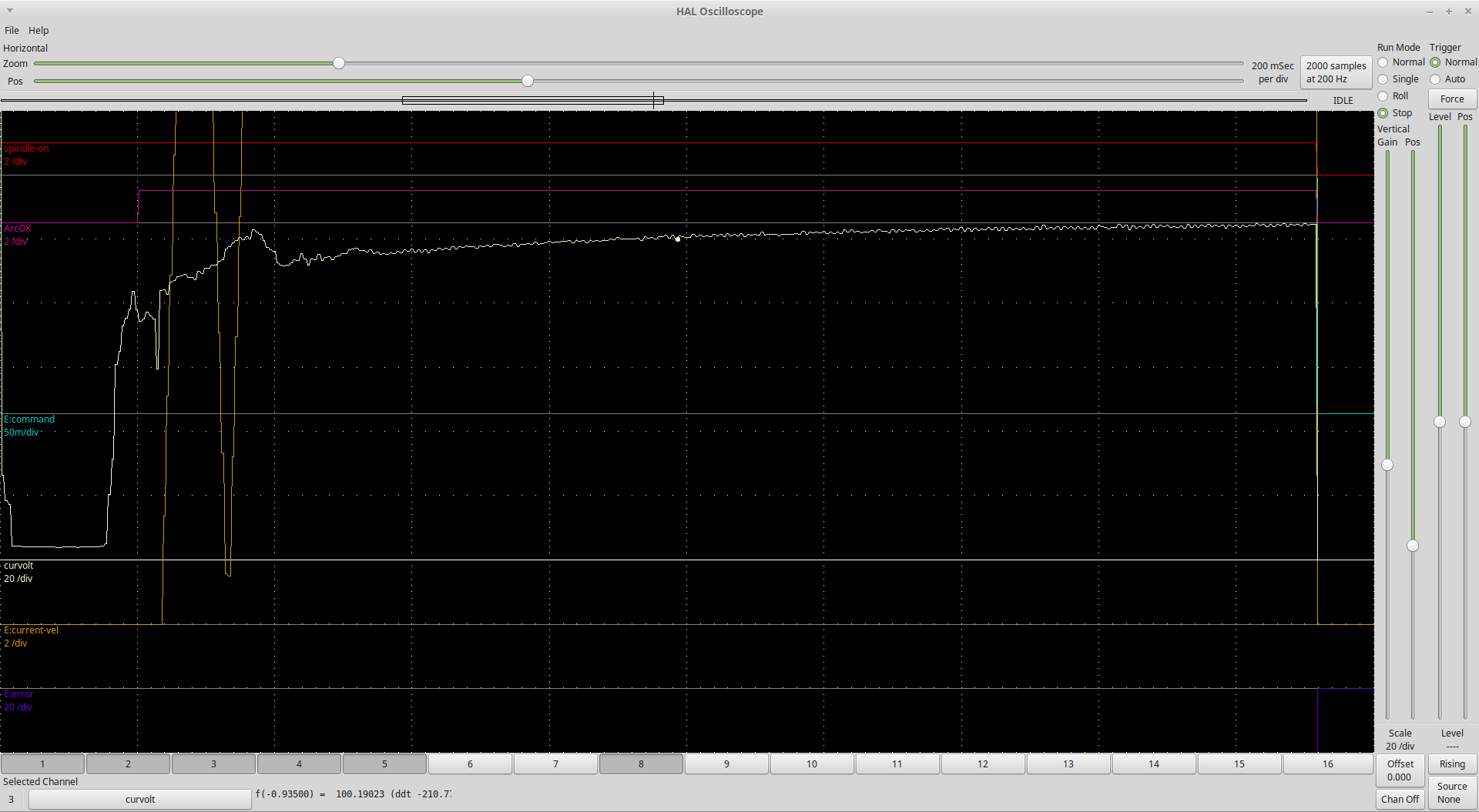

Well I think I've finally got the noisy Torch voltage signal under control. Initially, Everlast suggested I try soldering a bypass capacitor on the raw voltage where it enters the CNC voltage divider board.
This did nothing. So I decided to purchase a cheap USB oscilloscope and measure the divided voltage as it entered the control box. With the control box turned off thetorch voltage had a nice 50 Hz mains ripple
When I turned the control box on, the signal was swamped with noise.
I was pretty disillusioned at this point and a couple of weeks later a mate who knows more about electronics than I do suggested that I install a mains EMI filter on the raw voltage signal. We figured that a 250 volt rated filter would handle 300 volts DC with no problems. This proved pretty easy to mount in the case right over the raw arc wires so it was real easy to snip the wires and solder them in.
While I was at it, I also replace the IEC mains connector on the control box with a EMI filtered version.
And voila, the noise was gone when cutting. I really hope this is a permanent fix!
