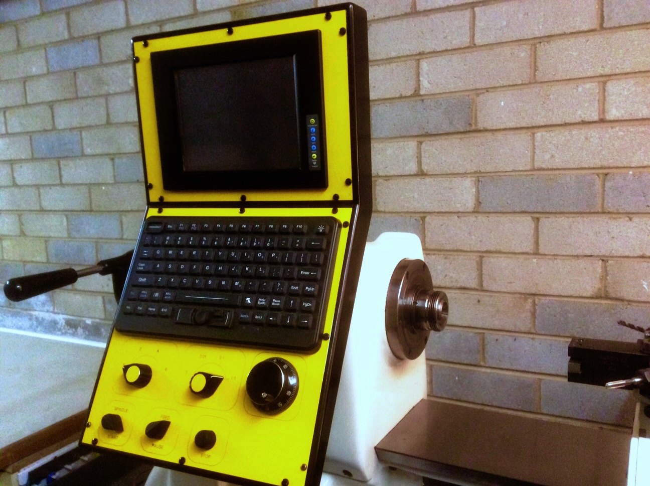

Guys,
After some more delays, I managed to finish a Mesa 7i73 based control panel for the lathe today. The top three knobs allow manual selection of axis and increments, and jogging movements via the manual pulse generator. Two of the bottom knobs are Grayhill optical encoder/switches, which allow changes to spindle speed and feed rates while a program is running, to fine tune machining operations. Two knobs are also push switches, which allow start, pause, step, and resume of programs using, someone else's code
As always, thanks to the guys on the forum for advice on getting it working.

22 May 2019 21:39 #134651
Replied by tommylight on topic Hardinge HC Lathe - CNC Conversion
That looks nice! Well done!

23 May 2019 08:07 #134690
by RotarySMP
Replied by RotarySMP on topic Hardinge HC Lathe - CNC Conversion
Nice workmanship. Would be cool if you could post a Youtube video of it in action.

23 May 2019 08:45 #134695
by OT-CNC
Replied by OT-CNC on topic Hardinge HC Lathe - CNC Conversion
Nice work and cool looking controller. How is it mounted? Is it on an arm? I did mine on my AHC so it can swing out of the way mounted on the right side. I still feel like having to wear a rain coat every time I use coolant as it gets all over the place. Will you be adding some kind of chip shield?

23 May 2019 18:04 #134747
by Skippy1
Replied by Skippy1 on topic Hardinge HC Lathe - CNC Conversion
Thanks guys,
The panel has a bracket on the back, with a 3/4" pin which drops into a hole in the headstock, where the original Hardinge motor speed controller fitted. It can swivel, but not move.
I was considering mounting a removable sheet of 3/8" polycarbonate against the headstock, with a 6" hole to fit over the spindle bearing retaining/labyrinth seal ring. The perspective of the photo is a bit out, but the right hand side of the panel would be behind and protected by the poly sheet.
I'm a bit of a technophobe, and YouTube is a bridge too far for me. If I get my finger out one day, I may get something up, but don't hold your breath.
Cheers, Steve
