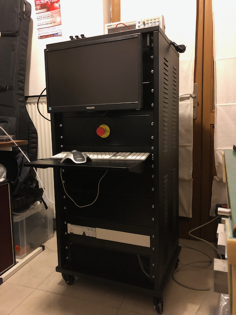

Last month, I have build the CNC terminal.
Its structure is based on Thomann.de 19" rack for musician.
The PC is a 1 unit height by 250mm depth with :
Spindle inverter is driven with RS485 connected to USB
I have installe The live CD of LinuxCNC
For me, this is the hardiest part of my milling machine. I will build the routing table when all the electronic will work correctly.

First full run
Next step : build the router...

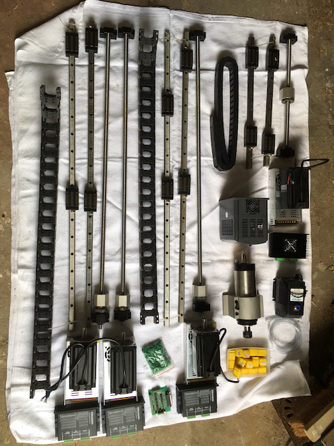

The second picture of this subject show all the hardware that I bought in 2017.
Sliding are mades of 20mm square HGH. Motion is made with d.16 & 5mm pitch ball screen. Link between ball screw and stepper motors will be made with synchro belt with 1:1 transmission. You can see one of the pulley in the above video.

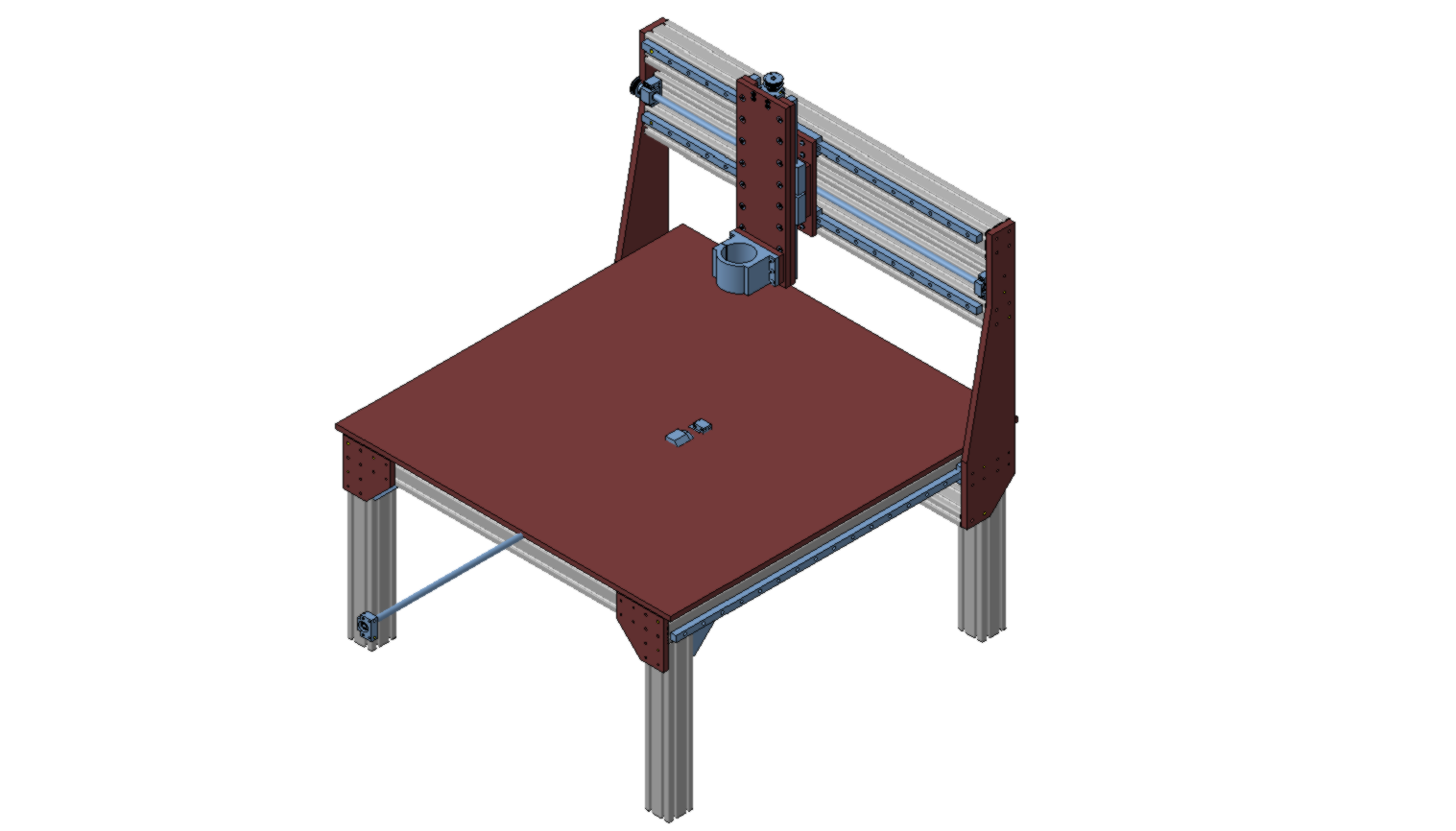

I have drawn my 8th project and I'm not decided of the way to build the frame. It will be probably AL profile ( Motedis ) and AL plate (wood @ for the beginning ?).

very good to start
and as time goes by 8th Projekt you will get into
Q: is there a reason for the leg length
and the HSS86 will get cheeper and cheeper on time
no need to go stepper from now as 4Nm is the same at 10times speed and more control

The legs connect the y-axis to the x guide rails installed on the sides of the table. x ball screws are under the table. the z stroke is 300mm. This explains the length. But this solution does not please me.
