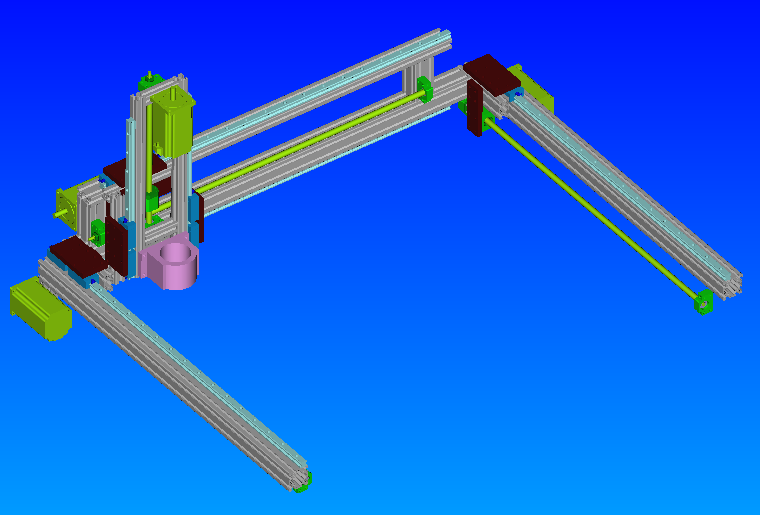

After some month, I go back to the design of the machine.
Because it is now very difficult to instal CATIA on a Mac, I have change design software to FreeCAD and learn how to use it.
I had to go from scratch. The design is in progress.
Here some pictures :

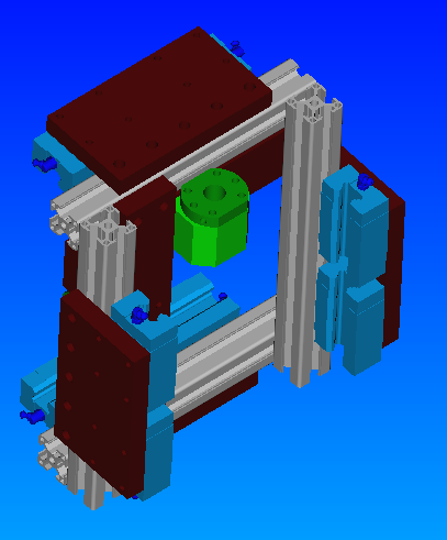

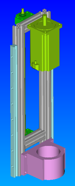

the stem :

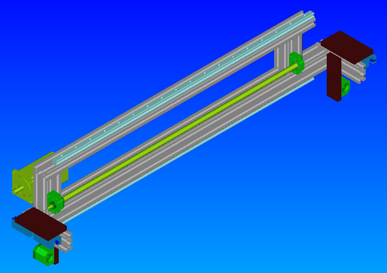

the carriage
the walk-through unit

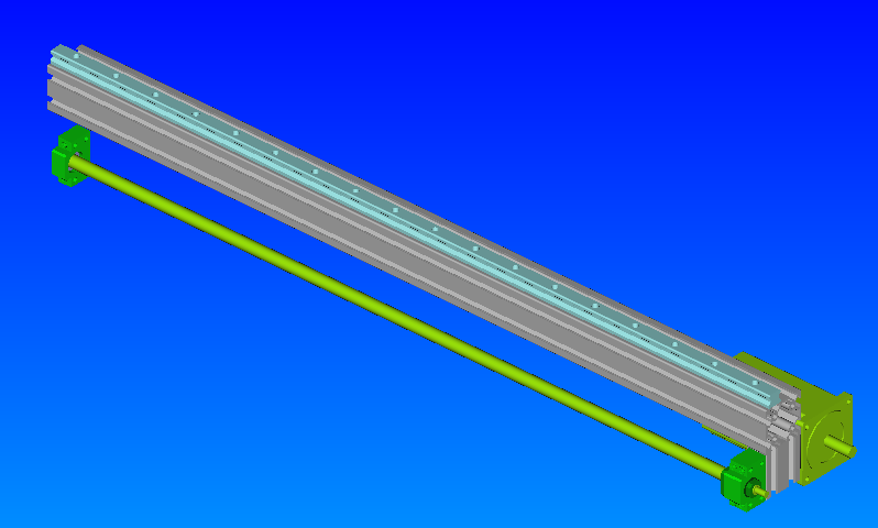

the base (LH & RH)
The base profile is 30x30 with 8mm slots.
for the first build, the dark red plate will be made in 15mm plywood for concrete.
The strokes are now 900x900x300. I have change the title of this subject according to this.
