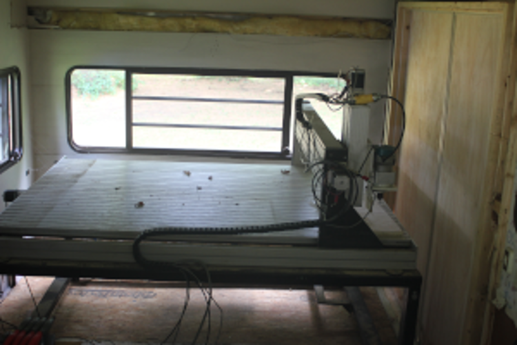

when i first got it, it was just the Techno/ISEL machine itself. the frame, gantry, Perske spindle, and the steel base. it had some servo motors for all 3 axis, but as i could not find any info on them, or their encoders, i opted for steppers, as the motors and drivers were cheaper than servo hardware.
here is an older picture:
it was taken years ago, before i mounted the Perske spindle back onto it (shown with a Makita RF1101 router attached).
the machine resides in the back of a gutted-out old camper. there are some added double doors added to the camper, to the right, so i can put large material onto the machine without having to get it through the camper door. and if i ever have to move the machine out of the camper, they will work for that too.
the control hardware will be mounted in a small rack enclosure i bought just for this reason, and all will be shielded and isolated using adhesive copper foil designed for electric guitar shielding. the power supplies will all be located at the bottom of the enclosure, away from the EMI sensitive parts. i am on the lookout for a plate of copper or aluminum to mount the stepper drivers on as a heatsink, and it will also be tied in to the shielding, to prevent EMI escaping, or entering. stepper driver signal wire will be CAT-5e STP wire, with the drain wire tied to the shielding (one end only, of course). power wires will be twisted in pairs, feeding each driver, and wrapped with shielding foil. the motor wires don't happen to be twisted-pairs, but they are shielded cables.

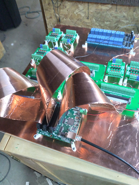

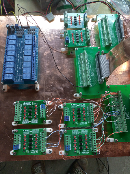

progress has been slow, due to... lack of ambition, maybe.
I have so far selected a mounting board (3/4" birch plywood), and covered the surface in copper foil tape for shielding. i then mounted the Mesa card to it using some L PCB mounting feet. i did the same for the 50-pin breakout boards, and the 5v <--> 24v optoisolation modules (each is 4 channel). the ribbon cables from the Mesa card to the breakout boards have been wrapped with copper foil tape, and grounded to the mounting board shielding. the mounting board, when complete, will have a perimeter of wood wrapped in copper foil tape, and a cover that is also shielded. the idea being that all of the control logic will be shielded, and the wires coming in and out will also be shielded (shield drain tied to the mounting board copper).
next to do, is to connect jumper wires from the breakout boards to the optoisolation modules. these are short runs (3" to 6"), so i may be fine with unshielded twisted-pair wires, only because shielding them will be a PITA. i may shield them in the future, if needed.
the stepper drivers will not be mounted on the control mounting board, simply because the mounting board i selected didn't have as much room as i thought it did. they will be mounted to the base of the enclosure, with shielded cable (CAT5e STP) feeding the logic. the power wires feeding the stepper drivers will be made to be twisted-pair.
now, i have changed my mind on the source of power for the system. previously, the power was a few switch-mode power supplies (120Vac input), as well as a ATX computer power supply (supplying 5Vdc, and 12Vdc), and a 24Vdc wall-wort. what i will be changing to, is rather than relying on 120Vac grid power, i will use a couple 12V lead-acid (or AGM) batteries, kept up with an automatic 120Vac charger, and solar power. this way, the power is stable during a power failure, giving me time to either save and shutdown the machine, or with enough battery storage, keep running. the LCNC computer will have a UPS as well, and eventually a standby generator. so with this in mind, i will use a series of step-up and step-down DC-to-DC converters to get the 5V, 12V, 24V, 36V power buses. the only thing that will not get power, will be the spindle, so likely i won't keep running, but will save and pause, and enable a resume button when the power is restored via either grid power, or from the standby generator. so i will need to wire a relay to the grid power, and connect it to activate the E-Stop on power failure.
as for shielding the control enclosure, my choices are to either cover the inside in copper foil tape, or use sheet metal screws to bond the painted panels together. the screws may be easier, but i think the copper foil may be more reliable. i will have to think on that portion.
i also have plans for this spring/summer to move my machine from the old gutted out camper, to a to-be-built shed. working inside the old camper has a lot of disadvantages, mainly lack of room around the machine. with the larger shed, i can also feed it with a sub-panel, and 6AWG wire from the main power panel, as opposed to the 10AWG wire feeding the camper. this will enable more available power for a larger dust-collection system, rather than the shop-vacuum i have currently.
i hope to have the control mounting board more complete by tomorrow, and i will try to remember to take a few pictures. the shiny copper foil definitely adds to the appearance.

Not a huge amount of progress, due to lack of ambition, but i am almost done the control board wiring. i have not added the shielding walls to the backer board yet, nor have i made the shielded cover. i was going good with shielding the wires, but on the many short wires between the Mesa board's breakout boards, and the 5v to 24v opto modules, i resolved myself to just twisted pairs. the relay board really should be shielded from the rest of the controls. perhaps i will just add a shielded partition to isolate it.
thought i would add a couple pics of my slow progress.
~Travis

made some progress today. i installed the control board into the cabinet, and made some test power hookups with both the 7i80HD-16 and the LCNC computer connected to the remote LAN out in the shed. they talk, and work with the signals correctly! well, i did have to invert some outputs, but when i did, all was well in the kingdom.
my next stage will be to connect the stepper drivers, and the homing signals, and see if i can make some first moves (for the 7i80HD-16).
this may not seem like huge progress, but with all i have going, it is moving along well.
i also still have to make the shielded surrounds and cover for the control board, but when my wiring is completely done, then i will know better where to make the openings for wires.
i have not connected the machine to the control board yet, as i wanted to make sure i would be sending it the correct signals, before i hooked it up and broke something. when i had things up and running, i used my digital oscilloscope to visually verify some signals from the stepgen signals.
as i was unhappy with the number of switching power-supplies cluttering up the bottom of the cabinet, i am changing to a different plan with the power. i will likely use some buck-boost converters to get my stable 5Vdc and 24Vdc from a single 12Vdc switching power-supply. so all power will be in a different cabinet, leaving three 36Vdc power buses, and a 12Vdc power bus to power the whole machine. the buck-boost converters may not be very efficient, but i had them on hand, along with a 12Vdc PSU, and the three 36Vdc PSUs. but the cables between the power and control cabinets will be reduced from 17 (ground, 5, 12, 24, 36, 36, 36) to 5 (ground, 12, 36, 36, 36).
Question, the 36Vdc switch-mode power-supplies, can they all connect in parallel, or will they screw with each other? if so, i can reduce from 5 to 3 power wires from the power cabinet.
the 36Vdc PSUs are 10A, and my steppers call for about 4.5A under max load. so i rounded up to 5A, and doubled the current capacity, just in case.

You can safely run 3 axis with 4.5A motors/drives from a single 36V 10A power supply.
