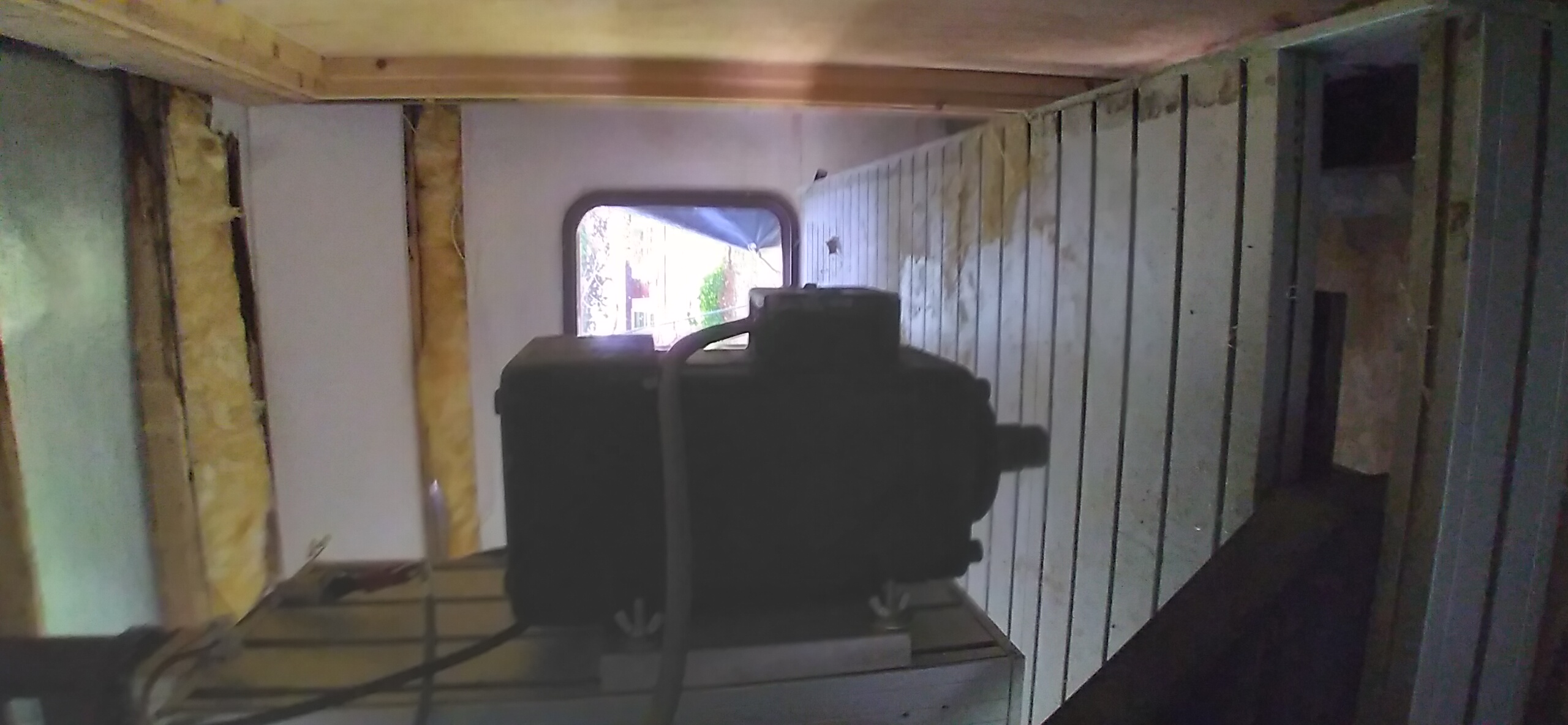

Haven't updated in a while... i discovered, via the LinuxCNC Discord, that my steppers were wrong for my machine. so i replaced them with some more correct ones. they are less current, but far more speed and stability than the old ones.
I ran the tort.ngc (the torture test), included with LinuxCNC, and did a YouTube video of it.
it seems to perform MUCH faster, and seems stable at 210 IPM (versus less than 100 IPM before).
I am thinking too, rather than making a 3D printer add-on, i will instead save up for a ATC spindle, and go that route.
www.amazon.com/dp/B091CM4JJ7/ is what i had in mind.
i also did a more accurate measurement of my machine movement. rather than just checking an inch, i set a tape measure right on 5 inches, under a pointed bit, at machine Y0. i ran:and watched as the machine came to rest right on 35 inches on the tape. after the first 1" measure test, i was delighted to see it was right on the money.
more about what i had in mind for the ATC spindle...
for a vacuum system, i plan on the nozzle reaching under the gantry, and the hose coming up and out the back. this would interfere with the tool-change, so why not have the tool pockets up front? or even a front mounted carousel or pocket chain thing.
the way i would do that is to home the machine behind the pockets, and offset the machine zero. so if my pockets are 3" in front of the machine zero, then i simply move Y to -3 to collect the tool. i may even automate a tool cover over the tool pockets, or spring-load a lid that is simply bumped out of the way by the Y axis getting in range (an option...)
depending on the spindle snout size... i think it has about a 4" diameter. so i could space the pockets every... 2.75" roughly speaking? so if i have 40 inches of X axis, that is 14 pockets, and i could use a pocket space for my tool-length sensor...
besides, this way i can better watch the great action of the machine working, and the tool changes.
the advantage of the tool pockets in back is it makes use of the wasted space under the gantry. could go either way i suppose.
and if i have more than 14 tools to load... i may build a conveyer chain with pockets in it. this would have to go in back of the machine due to it taking so much space. but that would be so very expensive... $$$
right now, i have to figure out how to come up with the $2600 for the ATC spindle and VFD. then i can wory about how i will load it with tools.
i don't know how long the quill is on a BT30, but i hope i have the machine height to load one into the ATC. i really need to re-do the homing sensors on my machine so i can get more use out of the Z-travel and such. that way i will know if i have enough to pick up a tool without the Z-axis box hitting my tool pockets. that too would determine if i rear-load or front-load. with the new speed of the machine, i am not worried about the travel time anymore.
what i am working on for the new Home sensors is to use Hall-effect sensors (digital/open-collector) with an opposing magnet. the magnet will be shunted by a piece of steel vane, to trigger the home location.
with the ATC, i like the looks of tool holder fingers.. but i could also just drop the tool into a tapered (for centering) hole, with clearance in the center for the collet and tool. my largest tool is a spoilboard surfacing bit, and i will be milling/routing wood. so mostly V-carve bits and end-mills.
anyway, just wanted to update.

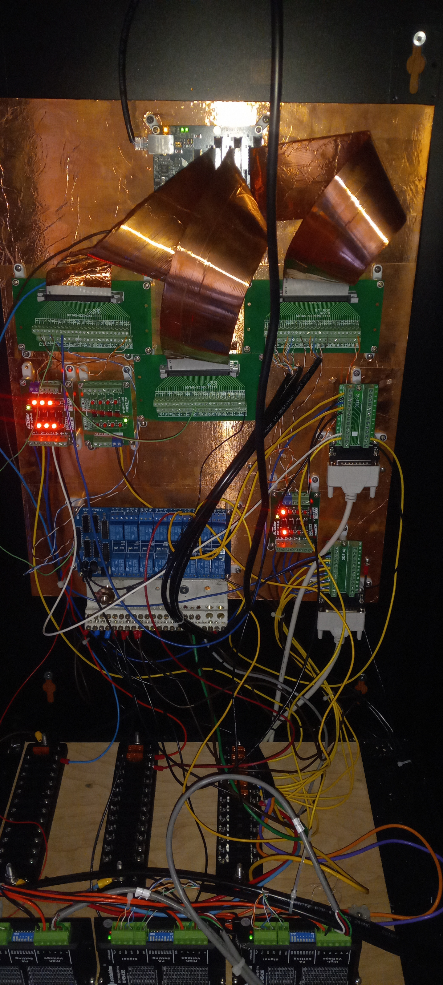

Just yesterday, i received shipment of a complete set of inductive proximity switches for home and limits. now i just have to figure out how i want to mount them. the plan is to mount them tangentially to the path of the target flags. i will be making the flags from some 5/16" angle steel i happen to have kicking around. i figured for separate home and limits, so i got 10 switches (3 axis, +1 extra), but i then realized i could make the home also a limit switch, and save 4 extras (always good to have extras, in case one fails at an inopportune moment.
as i hope to be able to do a little aluminum milling (wood primarily), i will have to shield the switches from aluminum chips.
only thing i am not yet sure how i will do, is capture cutting coolant from the table, so it can be filtered and recycled.
at first i was thinking i could just use the dust vacuum to clean up the aluminum chips, but i realized that without coolant, i could ruin my end-mills.
my thoughts there, are to build a wooden tub, of sorts, that i can mount T tracks into for work-holding, and sidewalls just as high as machine clearance allows, to capture flung coolant, and chips. the wood will be sealed with epoxy, or something similar. though this idea is not set in stone. open to suggestions, having never milled aluminum.
but back to the Ind. Prox. switches... the coolant tub should keep the Y axis (along table, forward and back) clear, depending on how i mount them. the X axis (along gantry), i will mount on top of the gantry, and the flag will be welded onto the 1/4" steel plate that the Z axis mounts to. the Z axis will mount on a tab welded to the side of the same steel plate, and the target flags will be mounted to the z axis box side. the switches for home/min-limit, and max-limit will be spaced apart so as to not interfere with each other.

Just upgraded my stepper power supply from 36Vdc, to 48Vdc. not sure if it is better yet, but it sounds smoother during rapids. ran the tort.ngc torture test twice, and a dummy NGC file, and no noticed issues, or excessive stepper warming. test was without a cut load, just the weight of the spindle.
i hope to make more progress on the machine this summer, but who knows. money is a lot tighter, and space around the machine is even tighter than that, as far as working around it.
i have some T-nuts and nylon bolts to mount my spoilboard down, though i think i will change plans with the nylon bolts, as far as holding power. the spoiloard needs to be within the working area, so it can be surfaced, without leaving high edges. my new plan, is to use plywood, with a perimeter cut down to 3/8" to 1/4", and bolt it down outside of the working area, so it can be more secure. but more importantly, no risk of machining the bolt heads.
i also have some T-track hardware, for attaching jigs, and so forth, but i would need to add compatible T-track, as i have found the existing T-track table to be smaller width slots than the hardware i have. i could grind down the edges of the T-bolts and T-nuts, but that would be a PITA. one option would be to surface the table-mounted spoilboard, and flush-mount some aluminum T-track in that, and use it for non-through-cut jobs. then i can mount scraps of wood on top of that as needed when i make through-cuts, or just sandwich a scrap of 1/4" plywood under the work-piece, when i clamp it down. i would just have to make sure my through-cuts are less than the 1/4" protective plywood.

I have been working to improve the wiring in my control cabinet. so far i have replaced the un-fused power taps with fuse blocks, and replaced the separate scattered grounds with a single ground block (my method of a star-ground).
my next task will be to route the wires a little better, and clean up the arrangement of connections between the control box and machine, via the 25-pin parallel port cables. i have a enclosure for the machine-side junction box.
Replied by travis036 on topic about my 48" X 48" X 5" Techno/ISEL woodworking router build

thinking of yet another re-wire... why you ask? when it works you ask? because the wiring is hap-hazard and hard to debug, is the answer. i have made so many changes that my schematics no longer correlate to my wiring, and that is not future-proof for the next guy.
my plan this time is to actually have rules i want to follow, and to label everything. then i want a master book that tells what every wire, relay, and junction is for. yeah, it may take longer to get back up and running. but it will be safer, and reliable. no more wires twisted together and taped up in random places i forgot about.
also, i need to make a way to lube the machine. take this last video i did of my machine:
