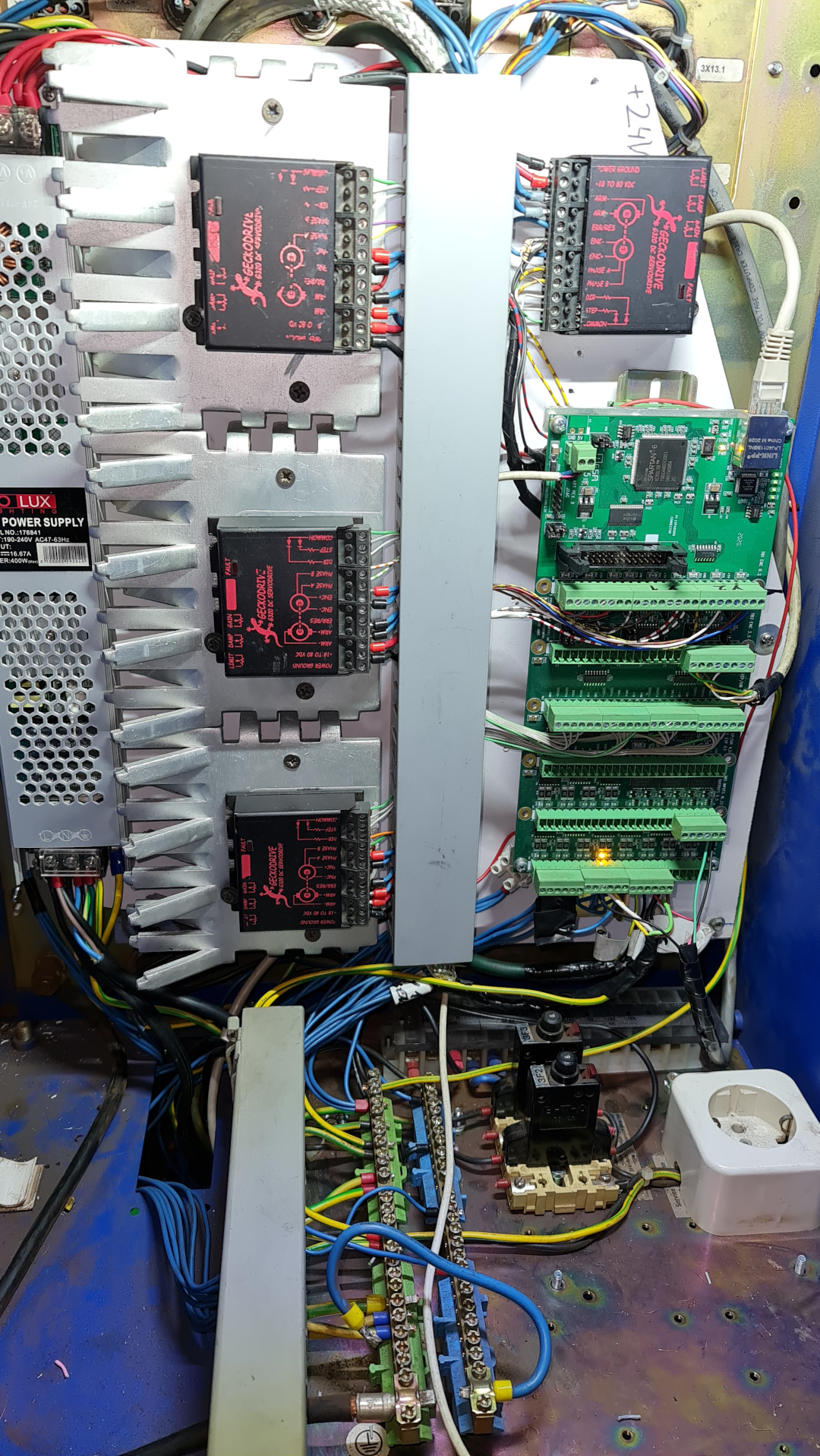

done quickly !!! What gear ratio are you using for the z axis? I put a small reducer but it has a small backlash and deceives the thcad... I'll have to put the toothed pulley and belt

I used the existing DC servo motor and reduction, yanked out the tacho and bolted on an encoder. Also added another Gecko G320 as can be seen in the pictures to drive the Z axis.What gear ratio are you using for the z axis? I put a small reducer but it has a small backlash and deceives the thcad... I'll have to put the toothed pulley and belt

your reducer will be zero backlash being expected for plasma with thc I think. I used the reducer from a miller spoolmatic torch... i have a dc motor with 512ppr encoder and mesa 7i30, i will do the reduction with pulley.

How much does the torch move up or down from that backlash?
The weight of the torch should be enough to keep it always pressed against the teeth, so i see not reason for it now working, at any backlash amount.

the backlash is about 0.12mm about 1 volt of voltage. at low gain it works ok but is slow to respond, if you turn it up a little it starts to rock up and down. the next few days, I put the pulleys and via the reducer, I'm sure I'll solve it.

Took the drives from the smaller machine to my shop, found out the wiring for everything, mounted the Mesa 7i77 on one side of the drive box and 2 power supplies to the other side as the drives need 24V and +-15V to work, Mesa 6i25 is on the PC, installed everything inside the existing console but it is getting tight!
Had to cut the motor, encoder, and sensor wires and reroute them to the console, so today a lot of wiring ahead.

Wires are cut, a bunch is removed, the drive box with Mesa 7i77 and 2 power supplies attached to it is also installed inside the existing console, PC with Mesa 6i25 installed and everything wired and tested, so today was encoder wiring and tuning day!
Took some running back and forth over the machine to disengage and engage the Y2 motor twice, but all three drives are tuned and running!
Was a good day for tuning, also managed to tune the Mazak X and Z motors drives.
Tomorrow more "removing cabling" and extending one of the encoder cables, i cut it to short, shame on me, then removing the existing Z axis motors (has 2 Z axis), trying to shoehorn a stepper motor, add a drive for it and another power supply, wire in the THCAD... hmmm with 2 to 4 hour days, to much???
