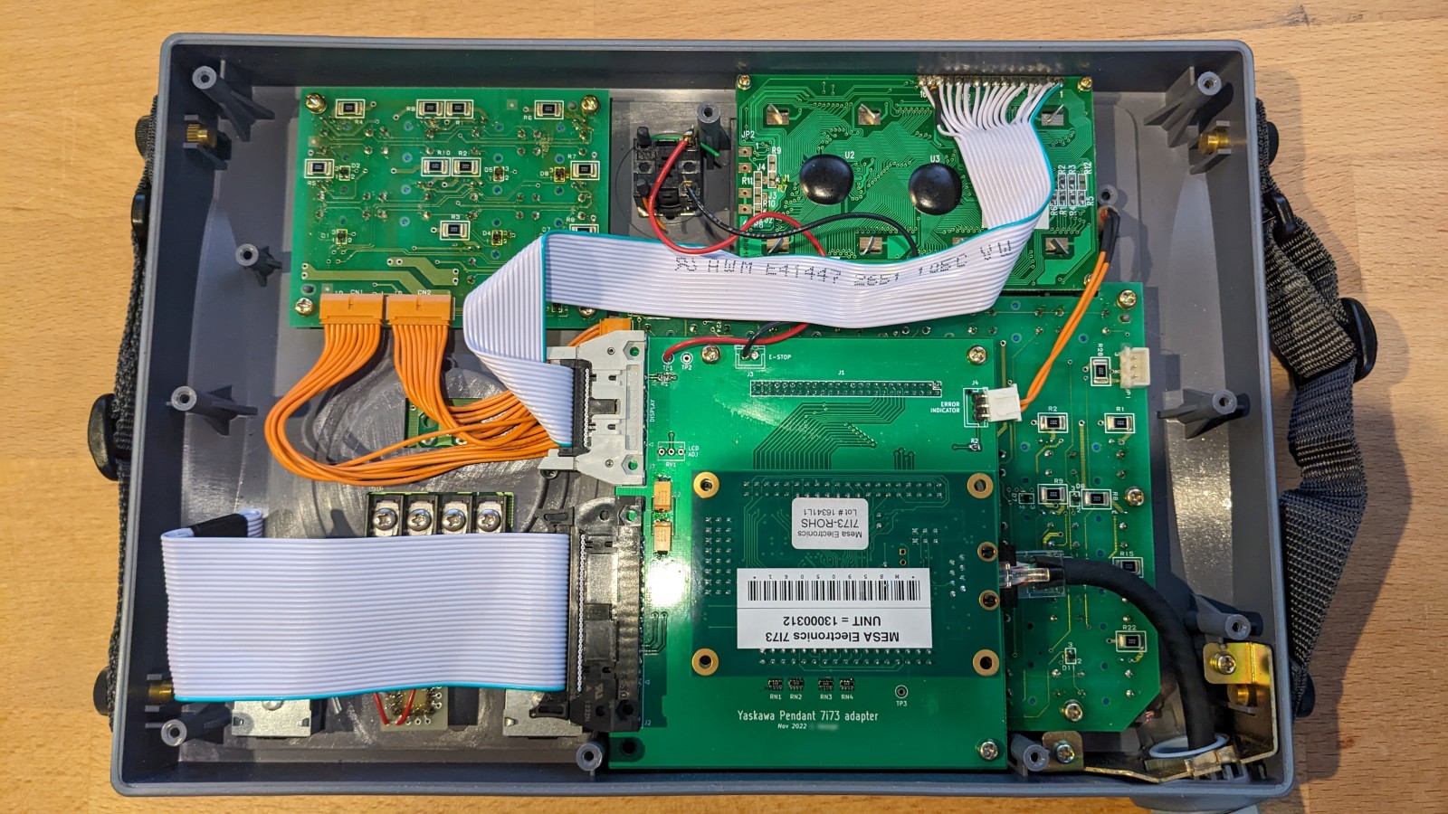

I designed a PCB to adapt the 7i73 to drive the keypad. With the 7i73 in 8x8 keypad LCD mode, there are 16 digital inputs, which I connected to the SRO, FRO, axis select, MPG and e-stop. Since my machine only has three axes, I did not wire the '4' and '5' positions of the axis selector. OUT0 from the 7i73 is used to drive the LCD's backlight. The 'CNC Alarm' LED is separately wired, so I have it driven by the FAULT output of the 7i73.
Here is the inside view of the pendant with my adapter board and 7i73. One can see the existing wiring with the gray ribbon cables (I designed the board to not require those cables to be modified).
My board has a couple of goofs:
1. The polarity of the diodes in the key matrix was such that the row drivers from the 7i73 would not work. This is because the 7i73 uses open-collector outputs for the row drive, and depends on an external pull-up. I had thought the 7i73 would actively drive the row outputs. The fix for me was to replace all the diodes on the keypad with reverse-polarity types. The original diodes were common-cathode SC-70 dual diodes, I had a bunch of common-anode diodes in the same package, so I replaced them and it worked ok. I also revised the board to exchange the row and column drivers, so the diodes should not need to be modified.
2. I had wired all eight row drivers to the keypad. It turns out that rows 6 and 7 are grounded on the connector, so I had to cut the traces.
3. The second connector to the 7i73 had a couple of pins connected to ground that should have been connected to +5V. I worked around this by removing the corresponding pins from the connector.
4. The connector for the alarm indicator was a bit too far 'south', the wire was stretched tight as you can see in the picture above.
5. While the digital inputs all have pull-downs, one end of the e-stop switch is grounded. Fixed in the v2 board by connecting to +5V.
I've fixed the goofs above and have included the KiCAD project with schematic and board file, if anyone would like to replicate it.

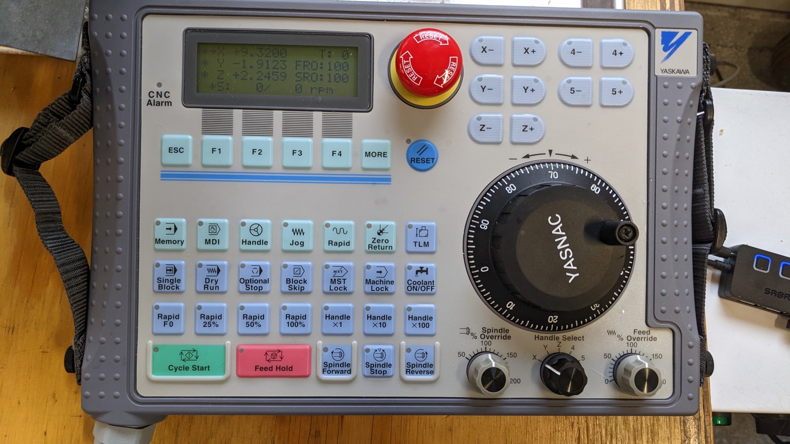

Here's a picture of the completed unit:
The original pendant came with a cable with a multi-pin round connector on the end. The entry into the pendant is through a strain-relief grommet. I replaced this with a coiled CAT5e cable from Amazon:
www.amazon.com/dp/B082PHY38G
The cable is quite nice, it has a TPE jacket and seems quite sturdy. Had to cut off one of the RJ45 connectors before it would pass through the grommet, though.
One drawback of the design is that the LEDs are not driven. The LED row/column pins are broken out to the J1 connector (pins 27-39). I connected the rows to the same signals as the keyboard rows via some 1k resistors, and the columns to the OUT1-OUT5 signals. However, without a firmware update, the 7i73 won't be able to drive the LEDs. The original board had +24V available, so the LEDs have correspondingly large (2.2k) dropper resistors. With only 5V from the 7i73, those resistors would need to be replaced with 470 ohm parts.
Another issue is that the digital inputs all have 1k pull-down resistors. This was done to avoid modifying the original pendant's wire harness, where the SRO, FRO and axis selector switches are wired to +5V. These pull-downs conflict with the 4.7k pull-up resistors on the 7i73. Ideally, they should be removed, though they seem to work OK even with both resistors in place.
