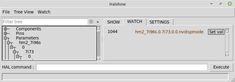

When adding setp nvdispmode 1064 the error appears: pin setp nvdispmode does not exist. I think we must add a component that generates this pin.
- Posts: 18122
- Thank you received: 5337
23 Nov 2023 20:46 #286381
Replied by PCW on topic Yaskawa RP-Y01-2ZI pendant with 7i73
You need the full name, for example on a 7I96S with a 7I73, it would be
setp hm2_7i96s.0.7i73.0.0.nvdispmode 1064
Note! You should do this with halshow or halcmd, not in a hal file:
Also note that NV parameters do not take effect until you power
cycle the sserial device. NV parameters should be treated with caution
since some can brick the card

Thank you for your support. The 4 x 40 LCD display works well, I recognized it without problem.

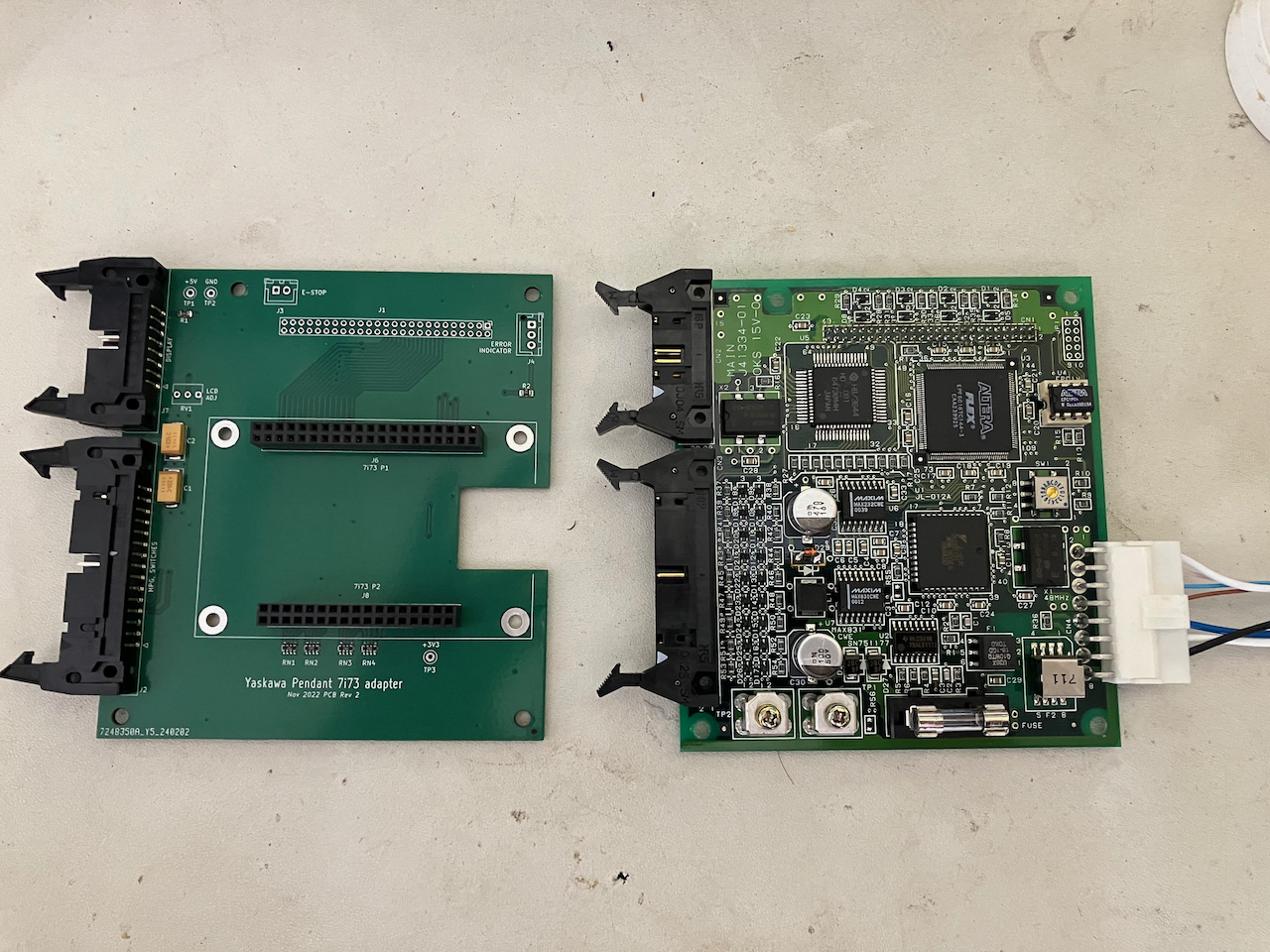

Hi all,
I just pulled the trigger on one of the Yaskawa pendants that radar_macgyver posted about, as well as a 7i73.
Big thanks to radar_macgyver for the work in the board design and revision. I'm in the process of figuring out KiCad and some a couple of the online pcb manufacturers to get a board made.
I saw that the topic here hasn't seen a lot of activity recently, and was hoping to see where folks were at with it, and maybe pointers on sourcing the pcb, or purchasing a spare from someone who had extras made.
@MikeRomill: If you're seeing this did you ever get this set up?

Well, my mostly assembled boards came on Friday and I finished assembling and integrating over the weekend. It was my first time ordering a pcb online, and I'm blown away at just how quickly and cheaply you can get boards made overseas. 5 PCBs, 2 mostly assembled, and all in hand 8 days after ordering for 50 bucks. Wow!
I had just the top sides of the boards assembled due to price and component availability. Soldering went pretty smoothly.
Took a little while to get the config files properly adjusted for my setup. The 7i73 seems to be on smart serial port 1, not 0.
I haven't looked into it further, but my keyboard matrix rows and columns were reversed from the original config.
And I'm not sure if it's a bug, but my panelui.ini wasn't being picked up until I renamed it to "_panelui.ini" with the leading underscore. My python is pretty rusty but a quick glance over the source changes on github didn't reveal any obvious changes that would cause that behavior.
All in all, the device is working exactly as radar_macgyver described, and I couldn't be happier.
Radar if you find your way back to this forum, thank you so much for all the effort and sharing it all with us! I'd love to learn a little more about how the LED circuitry and work on a board revision that could drive them, possibly with a set of mosfets and bringing in extra 24v.
The cable that came with the pendant has sufficient conductors in it to land 8 on the 7i73, plus 2 for 24v/ground, plus 2 for the e-stop if one wanted to go that route. There are 3 thin conductors in the cable that are unused and cut back, so stripping the cable further back and crimping/terminating would be required.
Mike- as I mentioned I got 2 boards assembled. If you're interested in either a populated or unpopulated board to get yours moving along, I'd be happy to get one to you for what it cost me.
I'm uploading a photo of the new board side by side with the original pendant board it replaces in case any one is curious. Otherwise there's not much more to add photos-wise that radar didn't already include.
If I make any improvements to the configs or board design in the future, I'll be sure to post them here.

Hello Malcom,
Thanks for tracking me down on the eevblog forum
Sorry I can't seem to get notifications working on this forum.
The LEDs on the board are driven as a matrix, with the rows separate, while the columns are shared with the keypad. You can verify that the LEDs operate by applying a voltage between the KP_COLx pins and the LED_ROWx pins. My recollection was the LED_ROWx pins must be grounded, and the COLx pins connected to VCC, but in the switch from PCB rev 1 to rev 2, I could have flipped these around. The keypad/LED board does contain FETs that switch the +24V to the columns of the LEDs, so one needs to provide a supply voltage to the LED board (pins 1 through 6 and pins 45 through 50) before testing. Wish I kept my notes from when I reverse-engineered the board...
You'll note that the LED_ROWx pins are connected to the KP_ROWx pins through a resistor network, the intent being that if the 7i73 scans the keyboard rows by pulling each one low, and also drives the COLx pins simultaneously, the LED will light up. Admittedly, this is quite a kludge, a much better way would be to maybe use a pair of registers to store the ROWx output bits from the 7i73 (gated by, say, the OUT1 and OUT2 pins) and drive the LED_ROWx pins with one register and the KP_ROWx pins with the other. The normal keyboard scanning routine will continue to drive the keyboard and LED's column inputs. By switching on alternate cycles between OUT1 and OUT2, the keyboard and LED matrices are scanned.
For either method to work, the 7i73 must have firmware loaded so that it is aware the I/Os are used as part of a scanned matrix. This would need the help of PCW or someone else who has the firmware for the micro on the 7i73, plus exposing the resulting 6x8 inputs to LinuxCNC.
You shouldn't need +24V, you could instead replace the SMD 2.2k dropper resistors on the Yaskawa board with lower resistance versions, and tie together the +24V and +5V rails (resistor 'R4' on the board).
