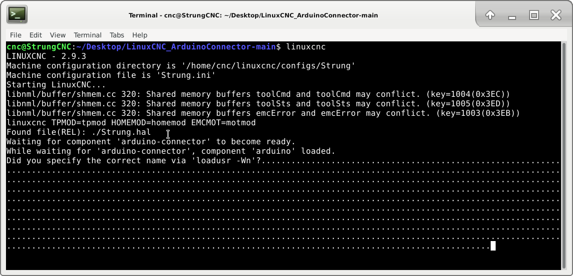

Replied by COFHAL on topic Arduino IO Expansion
I'm trying to use LinuxCNC_ArduinoConnector V2, but it's not very clear how to install this new version. I initially used install.sh, then loadusr arduino-connector, but an error appears. I included the instructions in the hal and ini files, but nothing happens when I run linuxcnc.

by tuxcnc
I remember that program name must be the same as component name, so if component is "arduino" the program must be "arduino" too.
But "arduino" is bad name, because is widely used for many things, so it should be renamed to unique one.
Replied by tuxcnc on topic Arduino IO Expansion
Yes, it works, but is not solution.Edit: i got it. Just rename the file from arduino-connector to arduino with loadusr -W arduino and it works.
