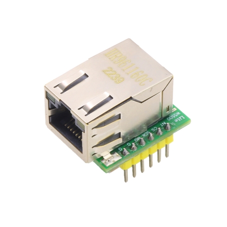

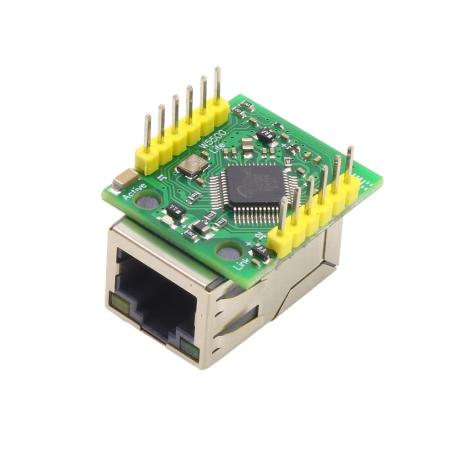

It is possible to solve the problem related to distance and speed by using a spi to lan converter similar to the module below
And it had a real time component
www.amazon.com/HiLetgo-Ethernet-Network-...Z820io/dp/B08KXM8TKJ
Last edit: 03 Jan 2025 08:48 by Ehsan_R.
- Posts: 1200
- Thank you received: 426
03 Jan 2025 10:29 #317943
Replied by Cant do this anymore bye all on topic Arduino IO Expansion
No it’s not a SPI to Ethernet converter.
It’s a chip that has an SPI interface and implements a, for lack of a better description, a network stack.
A micro controller connected to it still has to setup network related things, monitor it for received data and other such tasks.
So no it does nothing to increase the distance between SPI devices.
I suggest you go to the wiznet site and learn what that device actually does. From memory they use the 5500 device.
