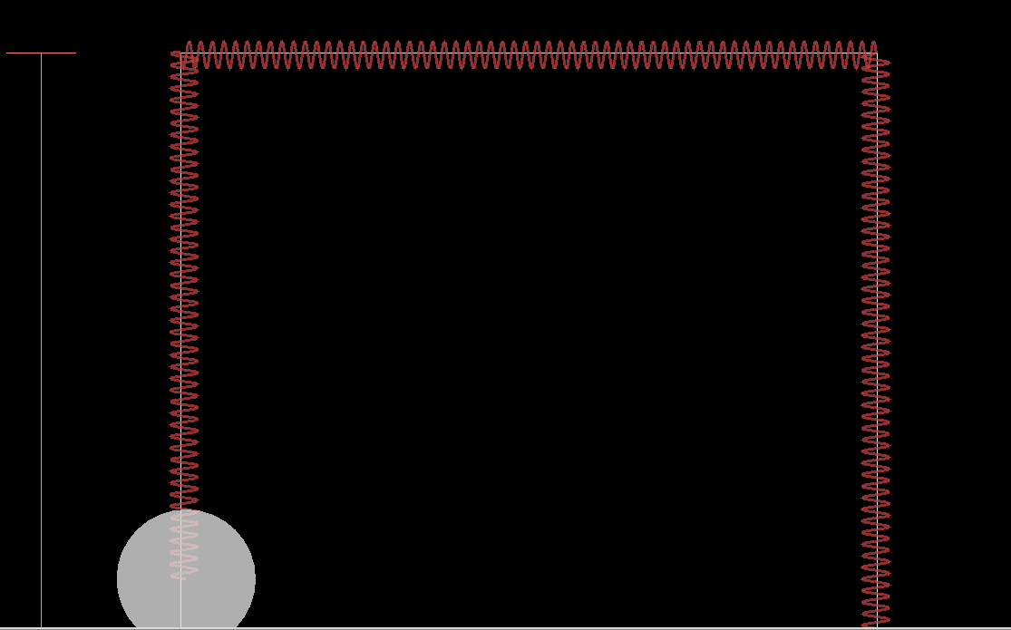

01 Jun 2023 08:41 - 01 Jun 2023 09:26 #272631
Replied by Aciera on topic 4 Axis CNC MIG welding, weavy stuff problem
I played a bit with getting a 2D weave:
Does not look too bad for continuous paths. But as usual the problems hide in the details.
[edit]
One problem is to reset the siggen at the right moment to get the weave centered over the tool path. This also needs to be done in corners. Just resetting the offset to zero might cause joint following errors on closed loop machines.
[edit]

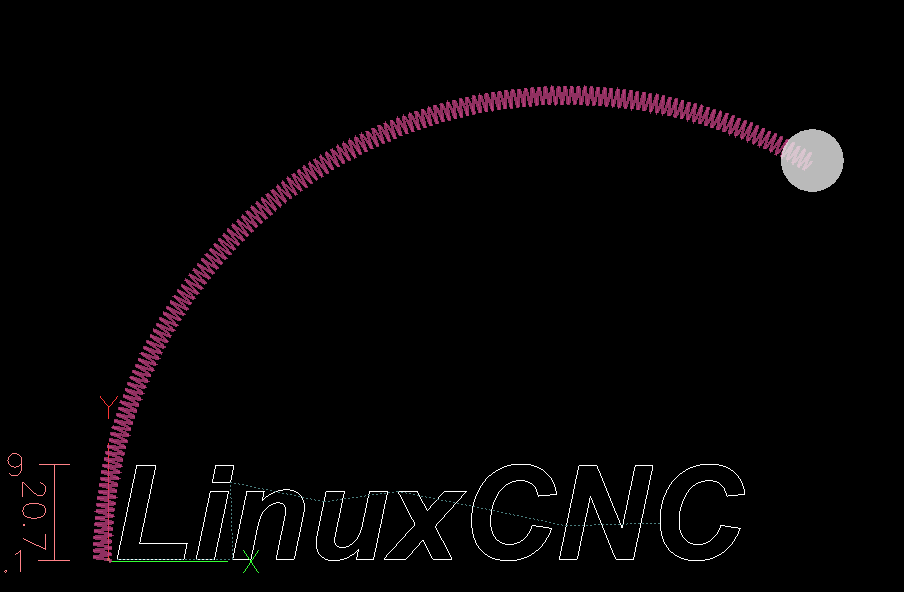

01 Jun 2023 16:41 - 01 Jun 2023 16:45 #272643
So, I've cobbled a sim config together. Make sure you install the weave.comp first. ie something like this (or with sudo on a deb install)
halcompile --install configs/sim/axis/external_offsets_test/weave.comp
Mind you I don't often write programs so it's all a bit crude and rough around the edges. But it might be usable. Start the sim config, home and start the example program.
- there is some interaction between feed rate and siggen frequency, if you play around with the frequency using the side panel you can get circle weaves instead of sine.
- I'm sure there are other pitfalls but I have run out of time.
