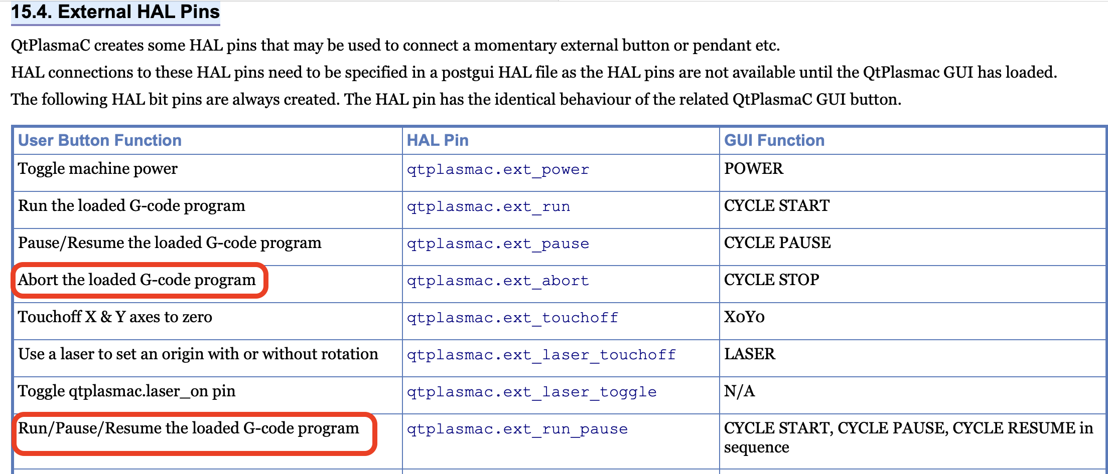

It may be easier to use two of the existing external hal pins rather than using runstep.hal.
Warning: Spoiler!
  • rodw
  • rodw's Avatar Topic Author
  • Offline
  • Platinum Member
  • Platinum Member
10 Sep 2024 01:24 #309809 by rodw
Replied by rodw on topic Showstopper Plasma Cutter retrofit
Warning: Spoiler!
Thanks, that is long standing years old work by Todd right when I started my initial Linuxcnc build you are consigning to the tip!
I need to review the pendant.hal. QTplasmac must use some more of halui. I wrote a component  to enable the buttons  to jog in directions + and - at slow and fast speed enabled by ~ so it must be in there as the rest I used for years.
It would be helpful if the docs had a list of signal names and extenal pins QTplasmac uses for those of us who want to use linuxcnc features unfettered by the GUI.

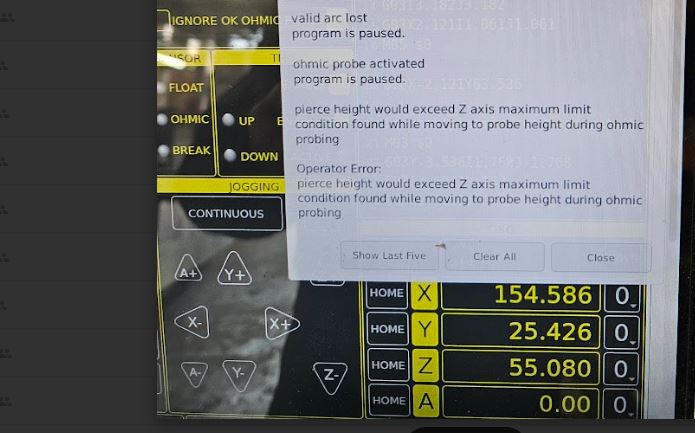

10 Sep 2024 01:28 #309810 by SteveatSteelCut
Replied by SteveatSteelCut on topic Showstopper Plasma Cutter retrofit
Does all of this have to be sorted out before running?I tried cutting a few tests just to see if I can run before at this stage.It seemed to be working, I was just changing some of the speeds in the material settings and now it is not happy to probe. I even restarted qtplasmac and still the same thing.I find it strange that I don't know how anything has changed but it is unhappy. I even changed the speeds back that I had changed and it didn't help.
