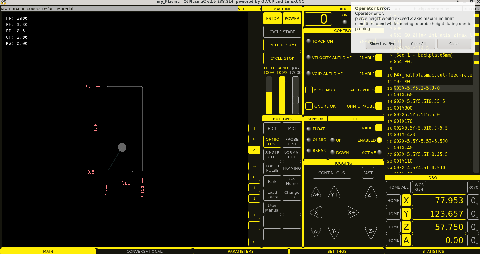

Hey guys,
back to the same problem as before.
We successfully cut a few files and then we got the same error with the height would exceed z axis max limit.
Tried to disable the torch and start program: Same error.
Loaded the last successful file that we cut and tried cycle start: Same error.
Closed qtplasmac, restarted, homed etc. Loaded same successful file that we cut: Same error.
Any suggestions?
I am wondering if the g code filter is a problem. Creating g code from hypertherm nestmaster and running it through a filter.
However it doesn't explain it working a few times in a row and then failing. I have also tried changing to different material setting that I have saved and running the program again to see if it helps.
Any suggestions?
- SteveatSteelCut
- Posts: 17
- Thank you received: 4
10 Sep 2024 23:39 #309869
by SteveatSteelCut
Replied by SteveatSteelCut on topic Showstopper Plasma Cutter retrofit
update I turned ohmic probe off and it worked again.
If I try and use ohmic probe I get the same error.

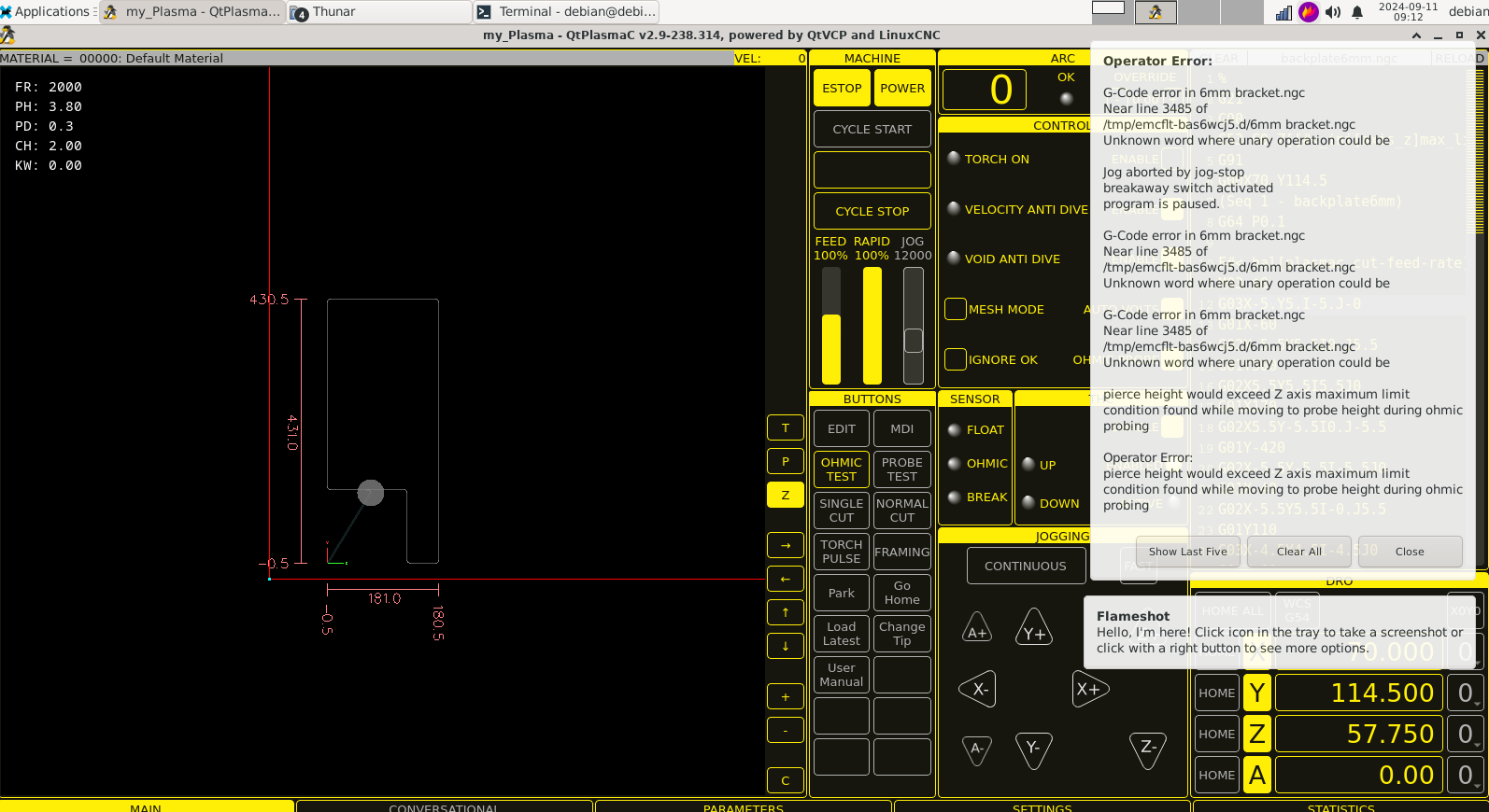

Hey guys,Still getting error messages for pierce height exceding z axis max limit.It's weird because it went away after deleting the .var file... But now I tried the same process and I still have the error. The only way I can get it to work is to disable ohmic probing.Also my pendant jog speed is really slow, maybe 100mm per minute. I have been looking in pendant.hal but I can't work out how to change it. It looks a bit different to the code that I find on the forums.
