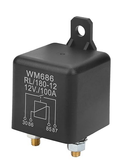

But you do do that, right? Disconnect the leads to the tip and the work lead?
And then you have an electric circuit you can use for ohmic sensing. And before starting and cutting you restore the leads to the tip and the work lead.
That will work.
Throwing out an idea, just a simple battery disconnect relay perhaps?
That will work.
