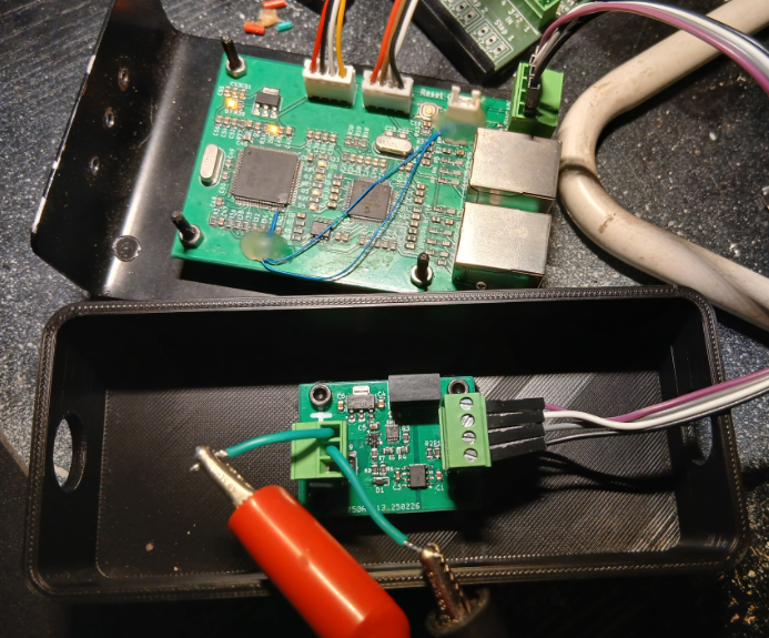

Got the new version, built and tested. This one works as well, no big difference from the previous version.
Maybe the linearity is a bit better, it goes to zero Volt now when there is no voltage.
View from initial test.
