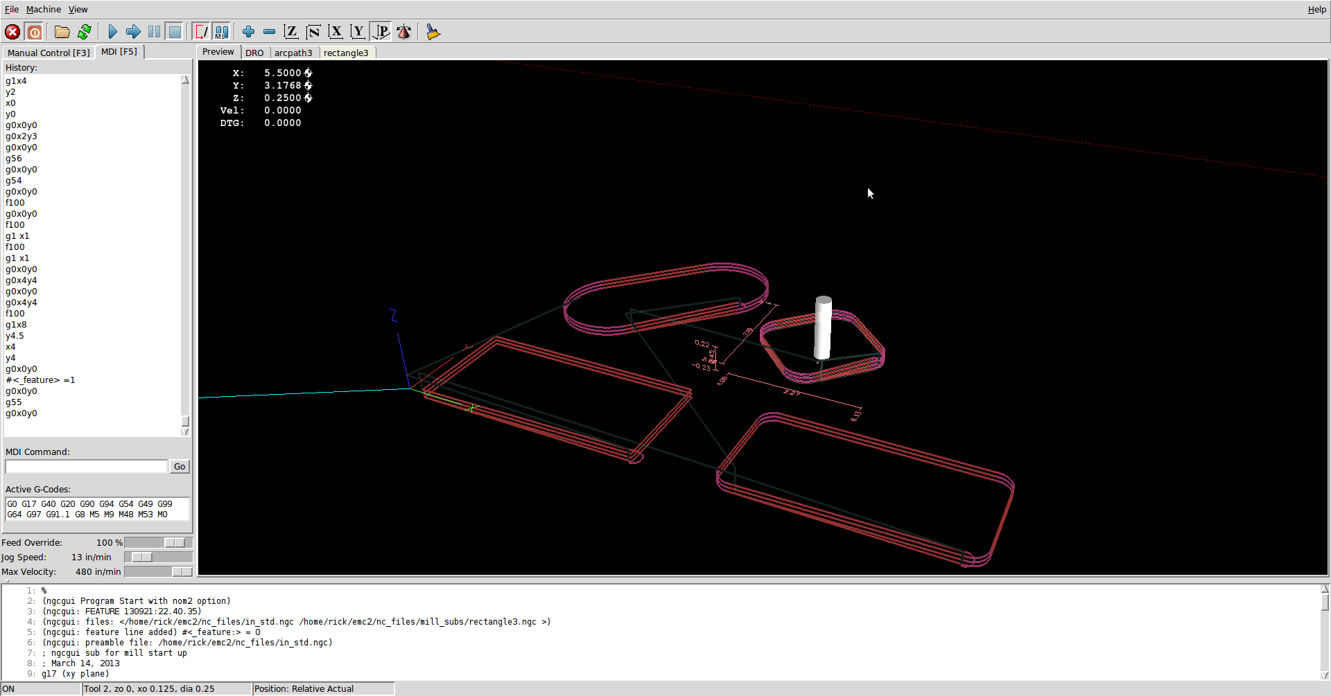

rectangle3 for mill / router was created by Rick G
For rectangles on the mill / router with square or radius corners.
Uses cutter radius compensation, multiple pass for deep cut.
Rectangle can be rotated.
Cuts inside or outside of path, clockwise or counter clockwise tool path.
Location of rectangle set with X start and Y start.
X start Y start is lower left of rectangle before any rotation
Select Main and Temp coordinate systems.
Uses check_cord3.ngc and M110
Newer version below.

Here is a newer version, This one you reference from the center of the rectangle.
#17 and #18 are the coordinate systems to use for the sub.
On a mill you might have more than one vise or work area, the first uses say coordinate systems 54 and 55, the second may use 56 and 57. If you always work in 54 just ignore them.
Rick G
