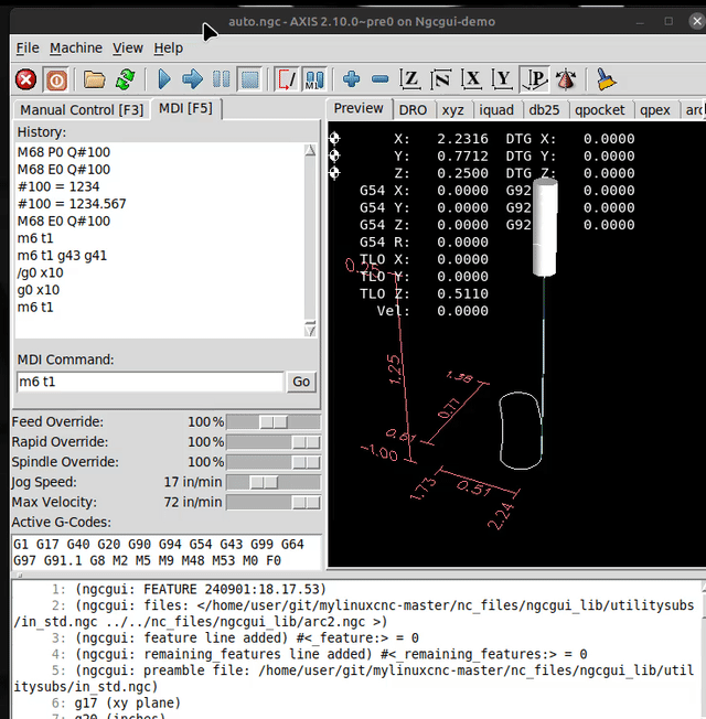

I am now using qtdragon with linuxcnc 2.10.0 and have ventured into the ngcgui programs. Arc1.ngc and arc2.ngc (arc2 calls arc1) are not adding tool compensation (g41, G42).
The solution is to remove the backslash from 4 lines 266-274 in arc1.ngc.
They should read as follows:-
The file is located in ~/linuxcnc/nc_files/ngcgui_lib
You will have to be root to edit this file. I.E. sudo nano arc1.ngc
g42 ;# cutter compensation right of path
o<ifi1> else
g41 ;# cutter compensation left of path
o<ifi1> endif
o<ifi0> else
o<ifi2> if [#<dir> EQ 2]
o<ifi2> else
g42 ;# cutter compensation right of pathThe file is located in ~/linuxcnc/nc_files/ngcgui_lib

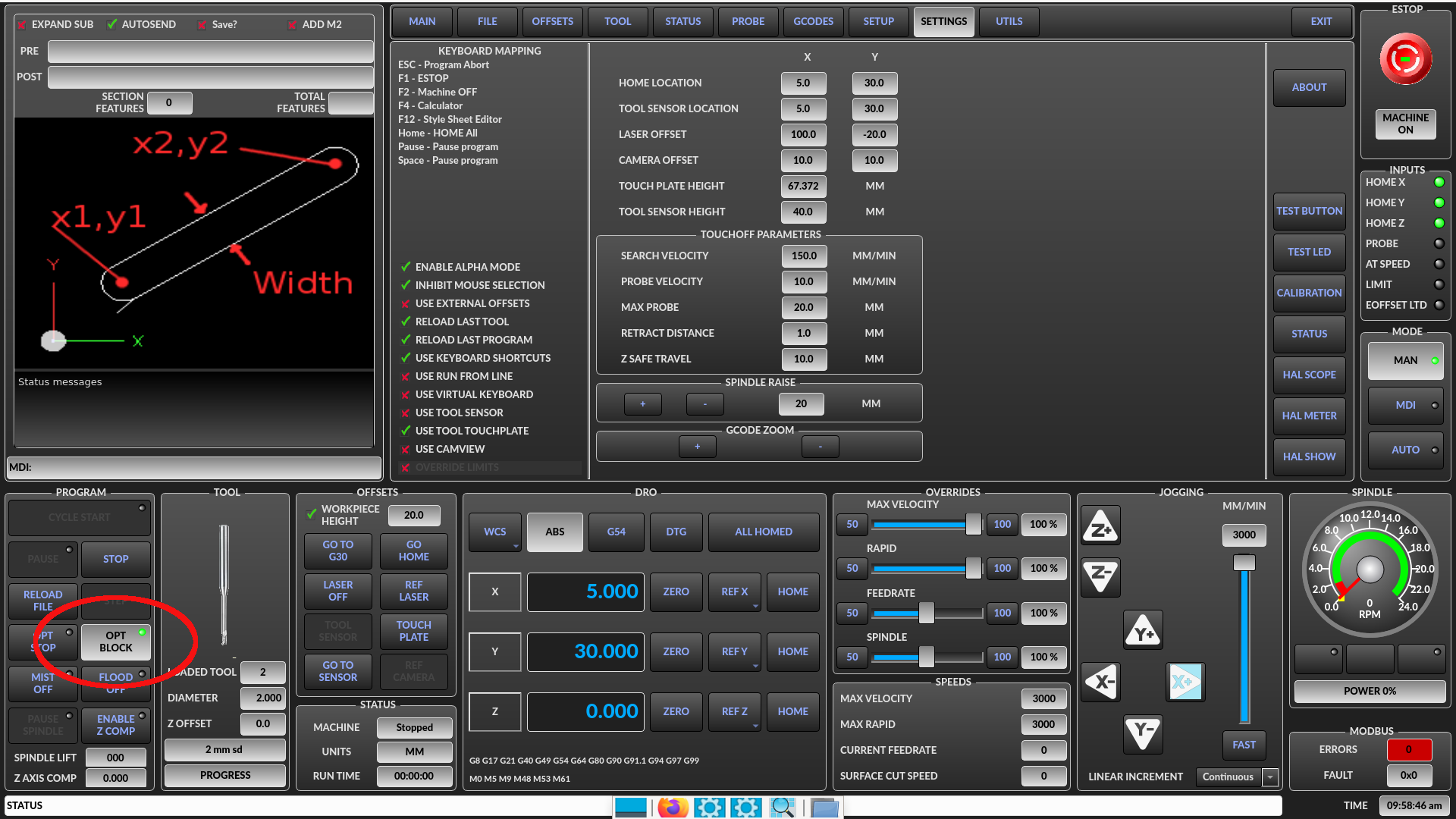

28 Sep 2024 09:07 #310949
by chrisfairbrothern
Replied by chrisfairbrothern on topic NGCGUI arc1 and arc2 are not adding a tool offset
Ok, point taken thank you. It s the opt block button in qtdragon.
