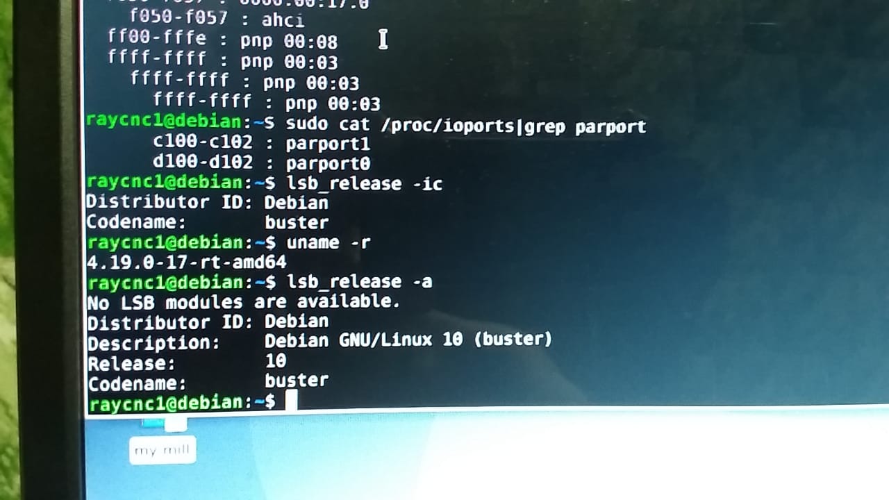

24 Jul 2022 10:49 #248162
by rajsekhar
Replied by rajsekhar on topic 4th axis tangent to path XY
Hello friends,
I need to use tangential and decided to make a trial for "tangentkins.c"
I got the file. But, as I am not a computer expert, please guide me how to install.
My Linuxcnc version is attached in photo.
- Thank you received: 4654
24 Jul 2022 18:43 #248190
Replied by andypugh on topic 4th axis tangent to path XY
"sudo halcompile ---install tangentkins"
Should compile and install it. But it doesn't work very well.

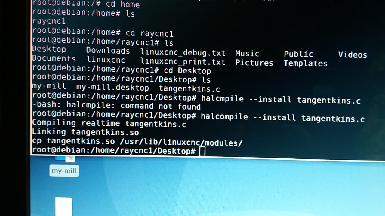

25 Jul 2022 01:55 #248213
by rajsekhar
raycnc1@debian:~$ sudo halcompile --install tangentkins.c
[sudo] password for raycnc1:
File "/usr/bin/halcompile", line 1508, in <module>
main()
File "/usr/bin/halcompile", line 1492, in main
shutil.copy(f, tempdir)
File "/usr/lib/python2.7/shutil.py", line 139, in copy
copyfile(src, dst)
File "/usr/lib/python2.7/shutil.py", line 96, in copyfile
with open(src, 'rb') as fsrc:
IOError: [Errno 2] No such file or directory: 'tangentkins.c'
raycnc1@debian:~$
the above result happened while installing.
which folder tangentkins.c should be placed to succeed?

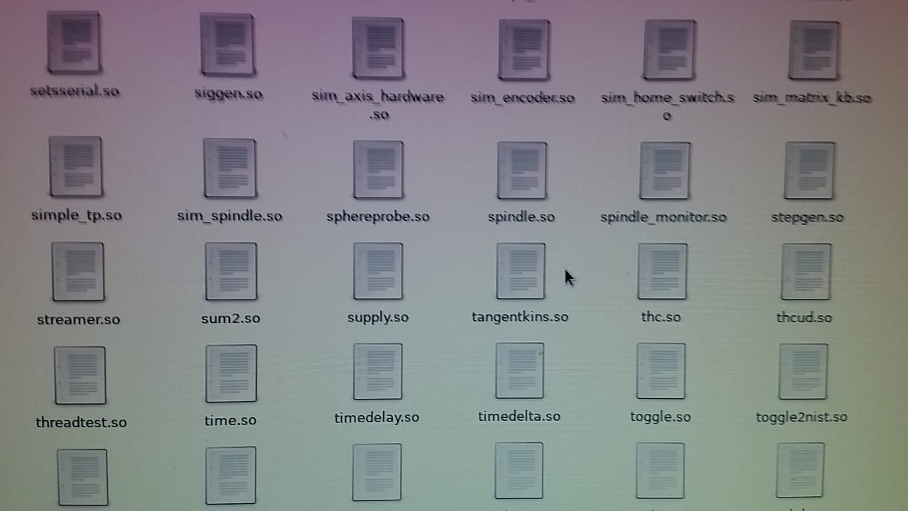

25 Jul 2022 07:56 #248224
by rajsekhar
Dear Andy,
I finally installed tangentkins.c and tangentkins.so generated (photo attached).
My machine is a XYZA configuration. Actually I modified tangentkins.c (attached) to C axis before installtion. But no Ca xis (joint 6) pin shows.
what to do next?? Kindly help.
