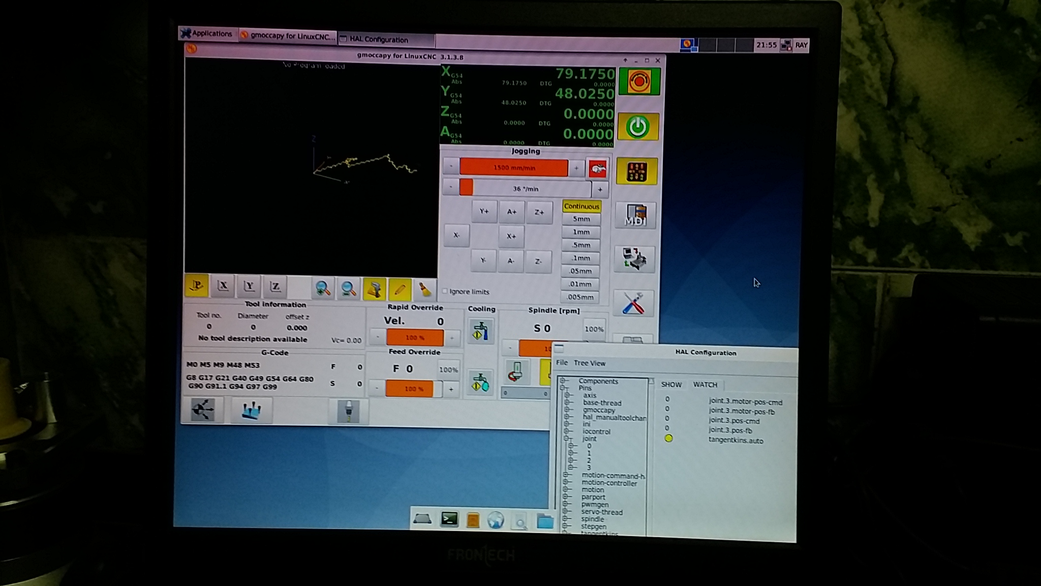

26 Jul 2022 16:28 #248344
by rajsekhar
Replied by rajsekhar on topic 4th axis tangent to path XY
Please refer the attached photo.
No change in joint.3.motor-pos-cmd pin.
- Posts: 19896
- Thank you received: 4648
26 Jul 2022 16:43 #248351
Replied by andypugh on topic 4th axis tangent to path XY
Does it become non-zero if you jog A?
