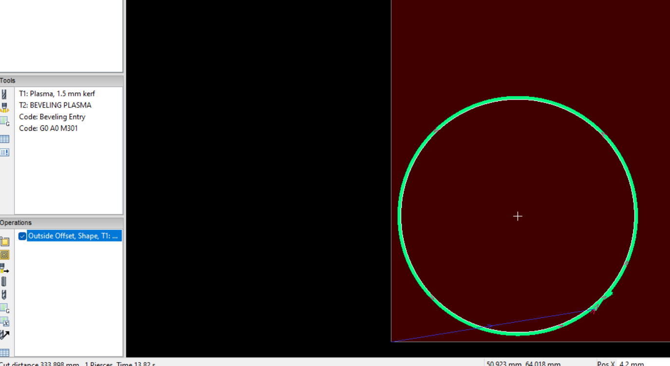

My hardware design has been made so that Rotating the C and B axis doesn't interfere with the TCP.
C is a direct vector to the tip of the torch at cutting height of 3mm.
B is a direct vector to the tip of the torch at a cutting height of 3mm, tilting around 45º so it's similar to some 5 axis boring machines.
SheetCAM is being a very useful tool for trying to come up with a solution for this, just not good enough yet.
Maybe G93 inverse time will be useful for this, but I haven't figured out how to put it to work in SheetCAM, so i'm still trying with regular G94.
XYZ, C and B all home perfectly and position the machine at 0,0,0,0,0 (vertical, straight C)
rotating B axis to -30 or +30 will produce bevels of this angle (with a snippet code, different tool, or other technique it's achievable to insert this)
-> THC off can be done with snippet code.
-> I would like to be able to increase the CutVoltage here by a bit but i can just have it OFF for now.
-> Interfacing with Amps digitally could be done with M67 M68 but not with my plasma.
-> Slowing down feed with the following code on bevels can be done automaticallyM67 E3 Q60 (reduce feed rate to 60%)
G3 I10 (the hole)
M67 E3 Q0 (restore feed rate to 100%)
On a small arc of 1mm, or a straight 90 deg X/Y angle, I can make the torch follow with the C axis being tangential with the knife post processor adaptation.
What I can't do, is make a bevel on an ARC (conic holes, large circle with bevel for weld prep, etc) , because the velocity of moving C will not be in agreement with the velocity of moving X/Y.

04 Mar 2024 09:28 - 04 Mar 2024 09:30 #295118
by santy
Replied by santy on topic Re:4th axis tangent to path XY
So, with some changes to the post, this was my achieved code for a Circle with Beveling tool.
If someone needs the post proccessor i can upload
;end material setup
M301 (M300=Stop Tangential Movement) -> DISABLE the C axis motor from the start
G0 X88.674 Y14.391
M3 $0 S1 (plasma start)
M67 E3 Q100
G0 C56.2500 #this movement doesn't take effect because the C axis motor is OFF
G1 X88.6735 Y14.3913
G0 A30 #after Leadin, the A axis tilts torch 30deg
M300 (M300=Start Tangential Movement) -> trigger output to turn ON the C axis motor
M67 E3 Q70 (slow speed to 70%)
M(xxx) (disable Torch Height Control)
G0 C56.2500 #First movement while beveling
G1 X91.4514 Y18.5486 #Leadin continues
G3 X91.451 Y18.549 I-36.451 J36.451 C-45.0000 #Does an Arc, where it expects to synchronize the speed of the xy to C??!
G0 C33.7500 #After the arc finishes, orients C axis to leadout tangent direction
G1 X95.6087 Y21.3265 #Leadout
M5 $0 (force plasma end through my snippet code)
G0 A0 C0
M301 (M300=Stop Tangential Movement) -> DISABLE the C axis motor after C0 finishes
Mxxx (Enable Torch Height Control)
M5 $0 (plasma end)
