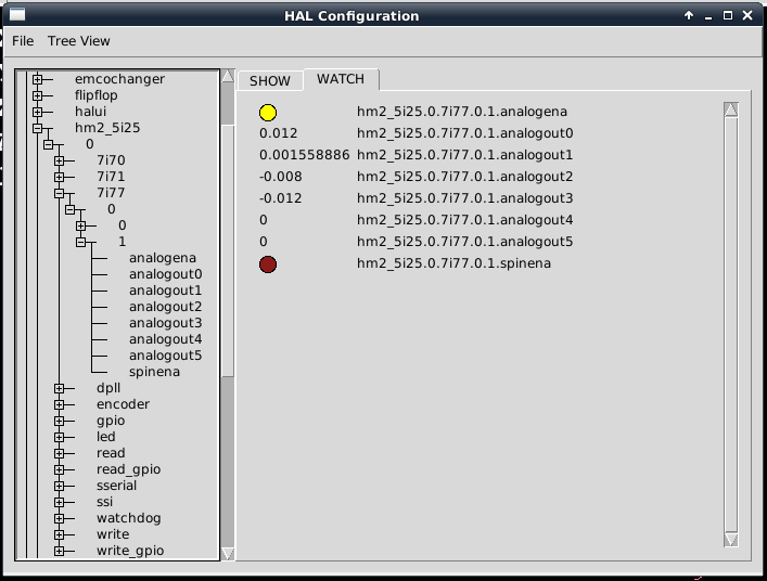

===Open the "Show hal configuration" from the "Machine" menu in Linuxcnc, navigate to "pins", "hm2_5i25", "0", "7i77", "0", "1" you should have the image below:
===Plug only one connector with "enable" wired and check if it functions properly enabling the drive when you press F2 on Linuxcnc, also watch the "hm2_5i25.0.7i77.0.1.analogena" on the window as shown above, you should see the LED change color. If it works, plug in the next one, if not, reverse the wires on the plug and test again, repeat for each drive separately. While checking this also check the DRO, if the servo drives are working properly you should see the DRO slowly changing while the drive is on.

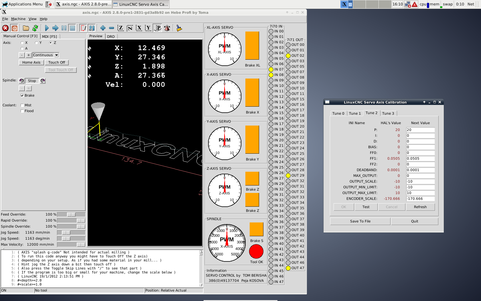

===On the calibration window, you should set the ff1 to 0, add something like 0.00001 to the dead-band field, leave the rest as is, meaning everything at 0 except the P value. Do this for all the axis. Press OK and "save to file" on the "calibration" screen.

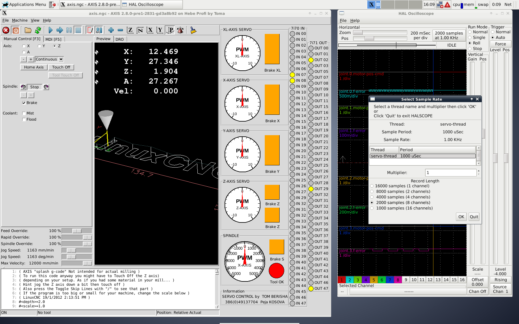

===If you get the above window when you open the "hal scope", just click OK.

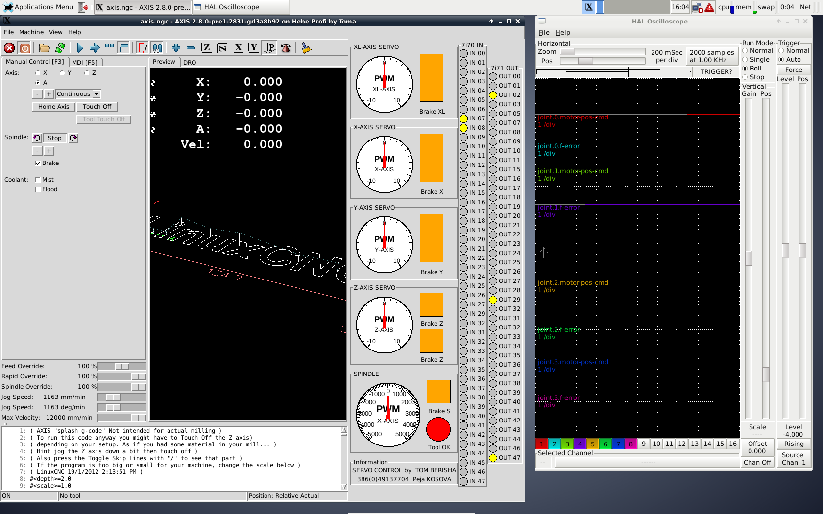

===Open the "hal scope" and "calibration" from the Machine menu, arrange windows so you can see "hal scope" and "linuxcnc" up to the DRO part at the same time, best way to do this is by moving the Linuxcnc window to the right beyond the visible area till the DRO part and the "hal scope" on the left side of the screen. On the "hal scope" press "1" at the bottom left and chose "joint.N.motor-pos-cmd" by scrolling down, press "2" and find and choose "joint.N.f-error", set it at "auto" and "roll" on the upper right corner.
I set the halscope for all the axis at the same time and save that configuration in the same folder where the config is, that way after restart i can just load and press "roll", as in the below picture.
===In Linuxcnc enable with F2 and very short press in one direction for the axis you are tuning while watching the scope. You will see the "joint.N.f-error" line jump all over the place. Do a very short jog and leave it, go check the motor for vibration, or even better, use a mobile phone with an accelerometer app and place it on a moving part on the machine so you can see the vibrations of the machine on the phone screen--- to much vibration->lower the P value, no vibration->increase the P value on the "calibration" window for that axis. Test again with a short jog and check for vibrations. When you get it to the point where you can barely feel vibrations with your hand on the motor, leave it at that P value and move on to tuning the FF1.
when changing values on the "calibration" window, do not forget to press "test" after each change and "cancel" after the test and before you change any value
===Tuning FF1 requires a bit of care and a lot of attention to details on the "joint.N.f-error" line on the "hal scope". Start with a low value of 0.01 and try to move the axis slowly with short presses on the keyboard, while watching the "joint.N.f-error" line on the halscope. Change the value to 0.5 and do the same as above. Based on how fast the line of "joint.N.f-error" went up or down during the 2 tests, chose the value that caused a slower rise or fall and add or lower the FF1 value.
Example:
say the 0.5 value had a slower rise or fall of the f-error line on the scope, put 0.4 and test again. If the move of the f-error line was slower, lower it a bit more say 0.3 and test again, it it was faster, increase it a bit to 0.45 and test again.
End of example
===Repeat that procedure making smaller and smaller changes to FF1 value as required, soon you should see a nice horizontal line with really small changes and move the axis without causing a fault.
===Now increase the jog velocity to 500mm/minute or 20in/minute
Repeat the above procedure again with really small changes of the FF1 value until you can jog back and forth without error and with a nice horizontal line on the scope.
===Increase the jog velocity again to twice that, repeat the above procedure.
===After several minor adjustments you will have a smooth and fast moving axis with a nice nearly flat f-error line on the scope and stopping on a dime ! If you have a bit of oscillation at the start and the end of a move on the scope line, try to add a REALLY small amount of FF2, 10 times smaller than FF1 at least, or lower.
