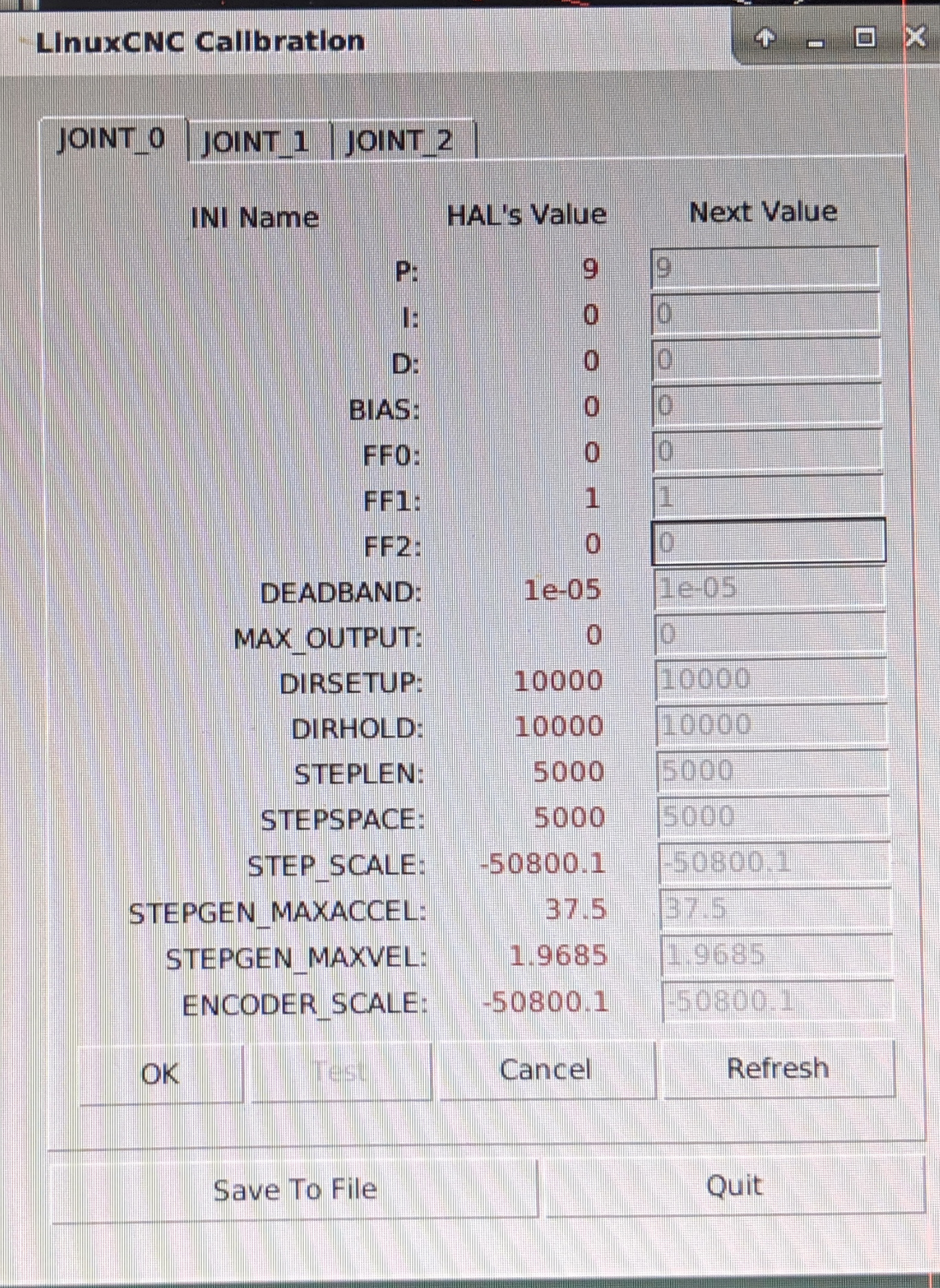

Good call! I have Max error in there for sure. Are these other lines other than Max error ok to have?
setp pid.x.maxoutput [JOINT_0]MAX_OUTPUT
setp pid.x.error-previous-target true
setp pid.x.maxerror .0005

26 Aug 2019 03:49 - 26 Aug 2019 04:05 #143189 by Type_Zero_Design
Replied by Type_Zero_Design on topic Servo Wiring and Tuning detailed How To example Mesa 7i77.
So I made the suggested adjustments and this is where I'm at currently. When I jog the error jumps up and then stays fairly consistent, then as soon as I let off jog it drops back in line. Identical but opposite reaction in the opposing direction.
Adding additional P causes it to go into a condition chasing a tenth back and forth. Adding any more then the .75 FF1 causes a overshoot in the opposite direction when I let off the jog.
I have attached a video of the scope results.
photos.app.goo.gl/GH7n5Lm8qcZPwpeL7

26 Aug 2019 04:15 #143190 by PCW
Sounds like FF1 is not dialed in
It should be set to within 1/10 1%
Too much FF1 means motion leads the command
Too little FF1 means motion lags the command

28 Aug 2019 04:28 #143393 by Type_Zero_Design
PCW,
Yes I have servo machine with encoder feedback using step/dir.
Currently I have gone through and set all my PIDS and FFn to 0 as Tony recommend in his tutorial and adjusted my P up until I got oscillations after joging and then backed down until they cleared.
Then I started running FF1 bring my error in to be inline.
Currently though when I get FF1 high enough to get my Error in line, after releasing the jog I get osscilations as shown in the video in the link here: photos.app.goo.gl/eiimAkZXWb9CGVqG6
Also attached are the current running settings that were running in this video.
