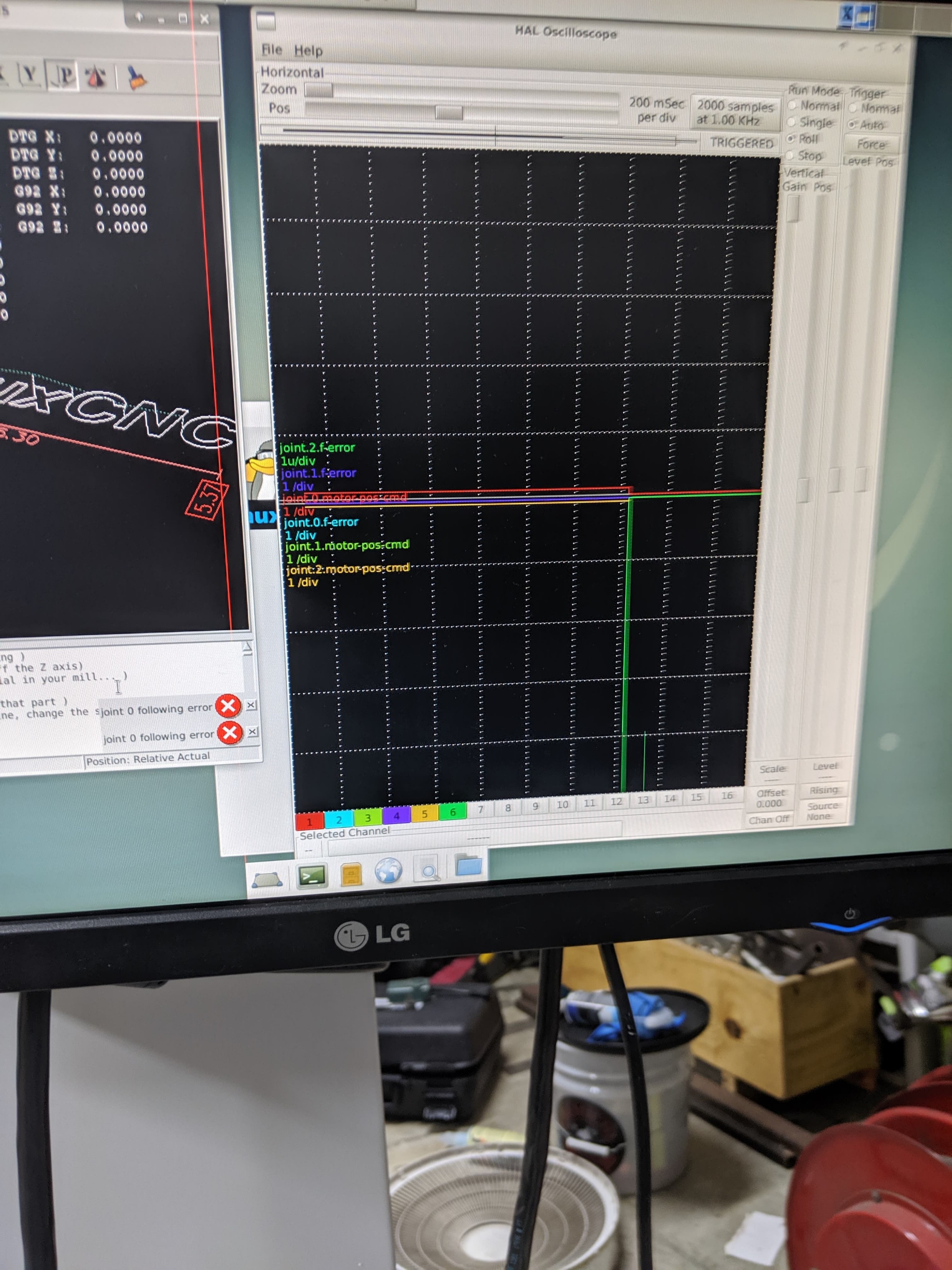

Ok Guys, Good News!
I finnally got the opportunity to get back on the machine again and with all your help I think I got my .HAL and .INI straightened out.
So DRO seems to be working appropriately (shows movement when moved by hand w/o drive enabled) , table movement on indicator matches the DRO movement on screen.
So now opening halscope, Ive run into a few things.
1. How do you get the the display to be bigger in the grid? You can see in my attached photo that the channels are very small and hardly visible.
2. I dont seem to have the lines similar to yours but i'm not sure if thats related to the view in hal scope.
- Posts: 12156
- Thank you received: 4149
19 Aug 2019 05:24 #142471
Replied by rodw on topic Servo Wiring and Tuning detailed How To example Mesa 7i77.
Play around with the sliders on the left and the scale sliders at the top to zoom in.
- Posts: 21957
- Thank you received: 7478
19 Aug 2019 10:22 #142482
Replied by tommylight on topic Servo Wiring and Tuning detailed How To example Mesa 7i77.
Hmm on the right ?!?!Play around with the sliders on the left and the scale sliders at the top to zoom in.
