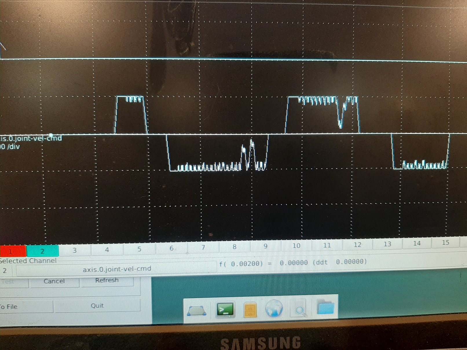

14 Nov 2020 09:38 #189308
by viesturs.lacis
Replied by viesturs.lacis on topic Servo Wiring and Tuning detailed How To example Mesa 7i77.
I am trying to tune servo loop based on this tutorial. What I see during the process is that as I jog the motor and release the arrow button, motor should decelerate and stop. At the moment of key release there is a sudden drop in velocity, which then resumes and after that the motor stops, see attached picture. Is that related to PID tuning or is that a lag in GUI or something similar?

14 Nov 2020 10:11 #189314
Replied by tommylight on topic Servo Wiring and Tuning detailed How To example Mesa 7i77.
Are you tuning the old Yaskawa drives with encoder feedback from the drives to 7i77? Those should be very easy to tune, just set the P value till the motors start to vibrate then lower it a bit so there is no or very litle vibration, then add FF1 a bit. Leave everything else at 0 excpet the deadband.
That should be it, it literarly took 5 minutes to tune all 3 axis last time i used them.
Make sure you have the drive enable wired to LinuxCNC and working correctly before everything else.

14 Nov 2020 13:26 #189330
by viesturs.lacis
I have 7i48 for servo control, but other than that - yes, it was pretty easy to tune motor for X axis. The table is too short to safely jog it at 45m/min, while looking at PC screen... Now I have to sort out missing encoder signal from Y motor.
BTW can you share some suggestions for controlling the VFD? At least some hints about wiring and pinout on VFD control signal terminal?

14 Nov 2020 18:23 #189358
Vhat VFD? Any schematics ?BTW can you share some suggestions for controlling the VFD? At least some hints about wiring and pinout on VFD control signal terminal?
