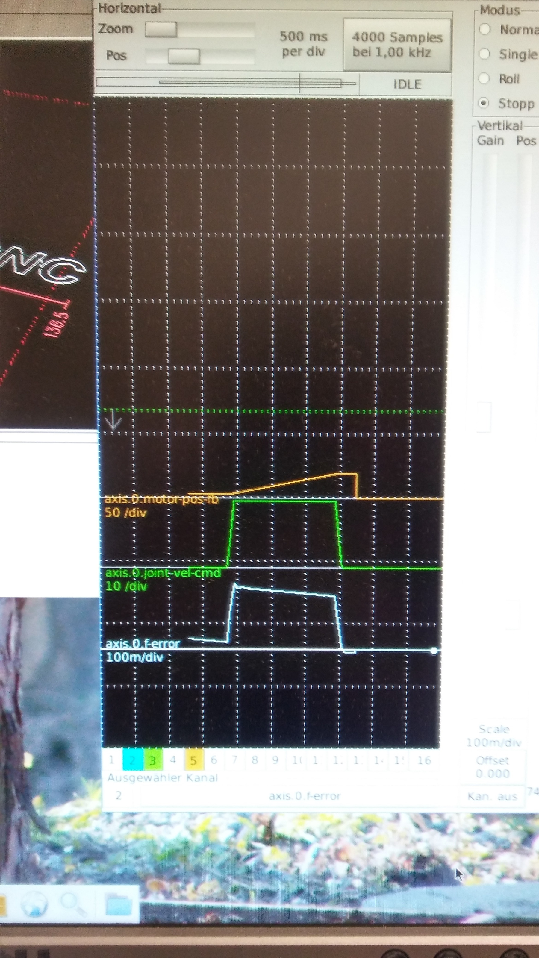

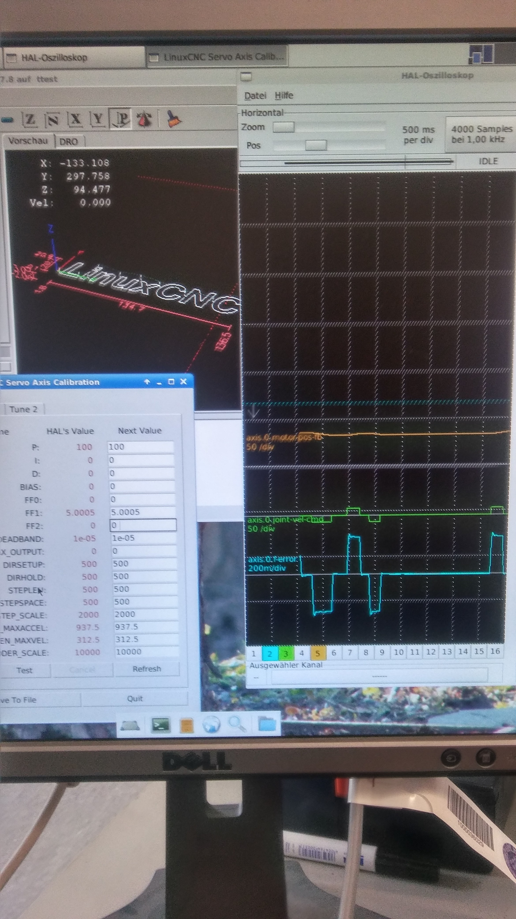

So If I use the Ecoderfeedback to close the loop I always get following erros when I accelerate to fast. I also tuned PID and FF1 to reasonable values. But the max velocity is only 1000mm/min. In an open Loop system I can run 15 000 mm/min without problems.
The reason for this slow travel speed is in my opinion the encoder feedback which causes a f-error. I think the motor can't accelerate as fast as needed. But reducing the acceleration means that the axis only reached a maximum velocity of maybe 3000mm/min. (The axis travel is only 400mm.
The Probelm is that I need to close the Loop with LinuxCNC to synchronize my Axis.
I hope you can help me accelerate much faster in the closed loop system.
Here to pictures of the tuning of my X-Axis

Replied by PCW on topic how to synchronize two servomotors
FF1 seems really wrong here
If the encoder and step scale are setup properly so encoder position and stepgen position are the same,
FF1 should be 1.000
FF1 should be 1.000

No, if the scales are set properly, FF1 _is_ 1
This means without feedback (only feedforward), the PID output will command the correct
stepgen velocity
That is, if you command a move at 100 mm/sec, and FF1 is 1, the PID output will command the stepgenerator
to generate a 100 mm/sec move even before any feedback is applied. This is the same whether you close the loop
using the stepgenerator feedback pin or use an encoder for feedback
