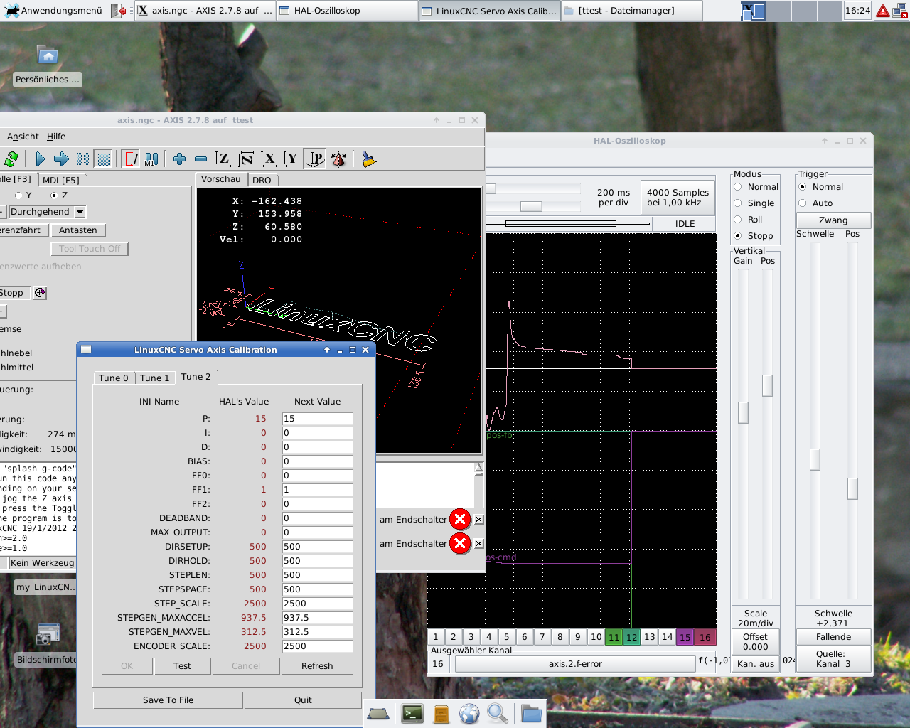

thanks that was defentiv one mistake (y is stepgen6 and y2 is stepgen 7). So know I still get following errors.
I discovered. that one motor rotates backwards. Also this motor has under calibration (in axis) no encoder feedback. If I change the sign. (y stays - ; y2 becomes +) than both motors turn in the same direction. But there still must be an error. Imidetly after moving the y-axis I get either following error 1 or 3.

The first thing you are going to need to do is get the encoder feedback straightened out for each joint.
It might be useful while setting things up if you can see the DROs in Joint mode. To enable that, in your ini file under the [KINS] section change the Kinimatics line to
KINEMATICS = trivkins coordinates=XYZY kinstype=BOTH
Then the joint values will be shown in the DRO.
DO NOT try to jog the y axis joints while in joint mode. As they will not be slaved together in joint mode and doing so will rack your gantry.
Just remember to take that out after the machine is setup so you can't rack the gantry.
With the drives disabled, push the gantry and see if the DROs for both Y joints moves correctly.
Then make the nessisary adjustments to the scales for those joints. (assuming the encoders are wired up and working correctly.) Also be sure that you have the right encoder connected to Y1 and Y2. (that they are not crossed)
