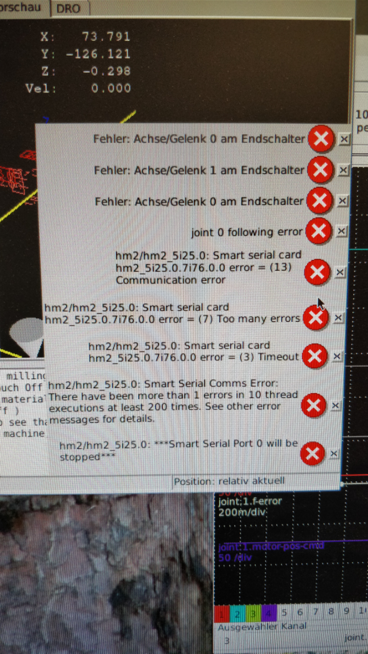

04 Jul 2017 16:55 #95366
by Jasper 3
Replied by Jasper 3 on topic how to synchronize two servomotors
- Posts: 18103
- Thank you received: 5326
04 Jul 2017 17:28 #95367
Replied by PCW on topic how to synchronize two servomotors
Look like you have lost communication with the 7I76 card
The combination of joint following errors and sserial errors suggests there may
be a problem with 7I76s 5V since that affects step/dir outputs and sserial communications
04 Jul 2017 18:03 #95368
Replied by andypugh on topic how to synchronize two servomotors
Which version of LinuxCNC?
Does dmesg give you a Smart Serial version number?
- Jasper 3
- Posts: 35
05 Jul 2017 08:24 #95379
by Jasper 3
I power the 7i76 via FPGA card. so you suggest to connect an external voltage?
I run the 2.8 prerealese but also had this problem under version 2.7.8
I'm not sure what you mean "Does dmesg give you a Smart Serial version number?" can you tell me where I have to look at?
