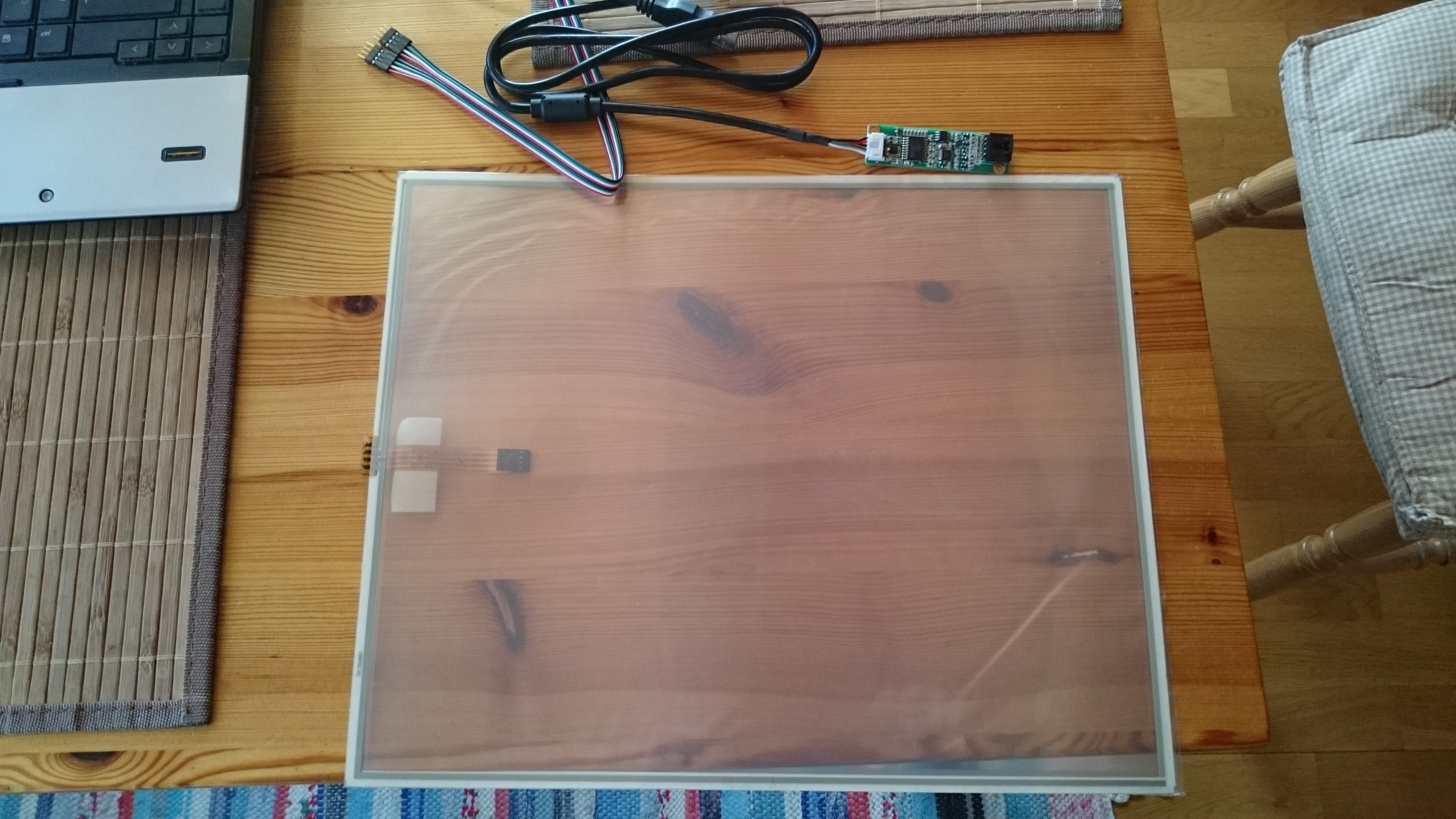

4 wire Resistive touch panel with EETI Controller 5V USB Interface
goo.gl/7h5QGv They say it works for Linux.
Does anybody have any experience of above touch panel add-on that works with 2.7.11/12 ?
This might be at better solution than trying to find a complete LCD Touch screen to a resonable price.

- tecno
- Posts: 1850
- Thank you received: 127
27 May 2018 12:34 - 27 May 2018 12:35 #111186
by tecno
Replied by tecno on topic Touch panel question
Everything takes time when you have health issues, been once again suffering from those bloody kidney stones so that puts one on hold
Above from painful yesterday.
Anyhow I have today installed Xinput Calibrator on my laptop for testing and voila these touch foils show up as eGalax.
Will make installation on my monitors, that will take some effort as the frames has to be opened and these foils attached to the TFT.
Anyways I am a happy camper as they work directly out of the box. Here a link to my supplier
hainatouch.aliexpress.com/store/group/Th...2.0.0.76af41cf8AIlN2
