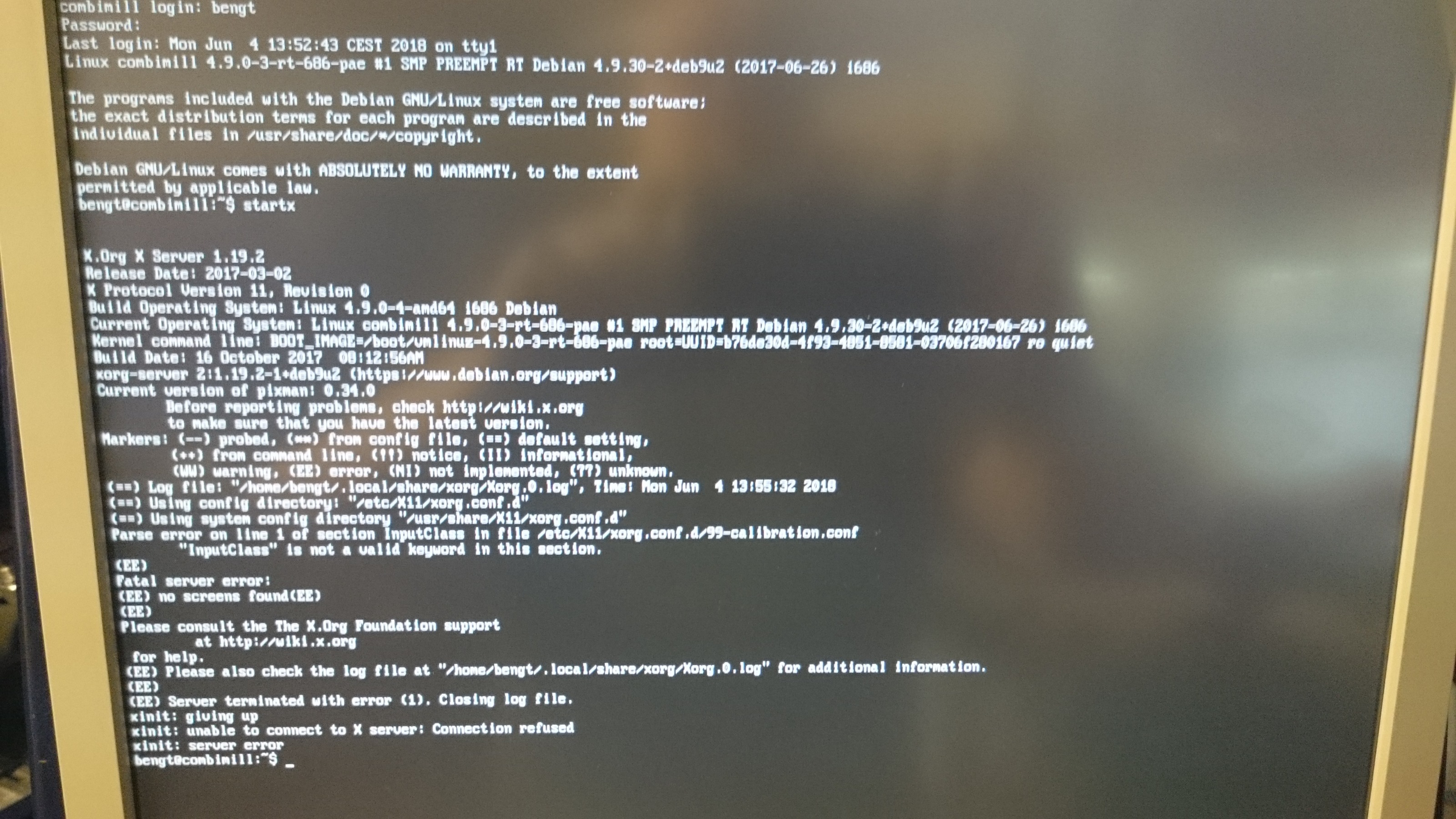

Managed to install MC and edit my conf file (Section was missing)
Section
"InputClass"
Identifier "calibration"
MatchProduct "eGalax Inc. USB TouchController"
Option "MinX" "63487"
Option "MaxX" "2662"
Option "MinY" "4373"
Option "MaxY" "62314"
Option "SwapXY" "0" # unless it was already set to 1
Option "InvertX" "1" # unless it was already set
Option "InvertY" "0" # unless it was already set
EndSection
Anyhow whatever I put in "InvertX" "1" or "0" I still get same behavior that is X is inverted, touch left cursor is right.
Any hints??

- Posts: 19888
- Thank you received: 4647
04 Jun 2018 21:13 #111624
Replied by andypugh on topic Touch panel question
I have ended up putting the stuff directly in Xorg.conf
I think that 99-calibration.conf ought to work in the Xorg.conf.d directory but I haven't tried it.
