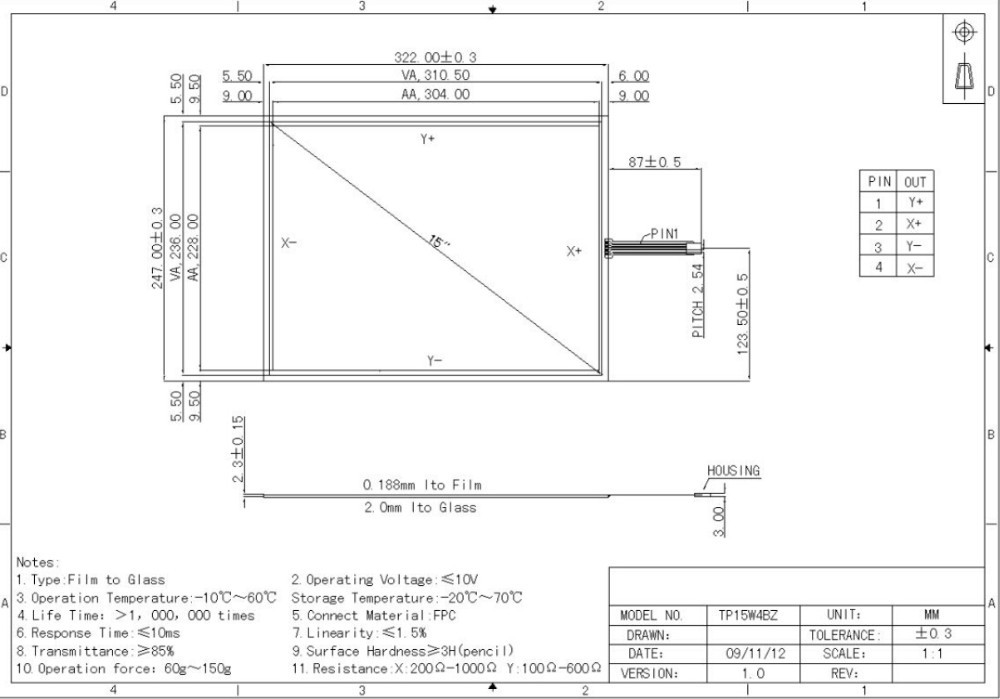

03 Jun 2018 14:58 #111509
by tecno
Replied by tecno on topic Touch panel question
Solved the issue with another 17" 4:3 10USD monitor.
But now I have following problem with touch on lathe. I do calibration and set numbers in 99-calibration.conf file
I point left bottom and cursor goes upper left, whatever I do SwapXY or mirror X or Y still same problem.
Assume X is left to right and Y is bottom to top, can I just swap numbers I got as I do have the touch installed with 4 wire going out on right side instead of left as in picture from factory. This to have easy way out for wires.
Any pointers are more than welcome.
Cheers
Bengt
Cheers
Bengt

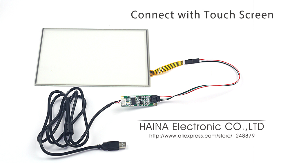

- Mike_Eitel
- Posts: 1051
- Thank you received: 183
03 Jun 2018 19:17 - 03 Jun 2018 19:20 #111538
by Mike_Eitel
Replied by Mike_Eitel on topic Touch panel question
I'm not absolutly sure but i think you can/shoud swap the four cable conector between screen and controller. I believe that way you swap x versus y.
And i remember having had problems with calibration in stretch. Reported it here. Search for "Touch" and "Stretch". Around beginning of the sehr.
Mike

- Mike_Eitel
- Posts: 1051
03 Jun 2018 20:14 #111545
by Mike_Eitel
I'm not sure, but i think i inversed once these two black plugs.
But sorry, don't know anymore if that inversed x and y.
If not, try my aproach in the sw.
Good luck
Good luck
