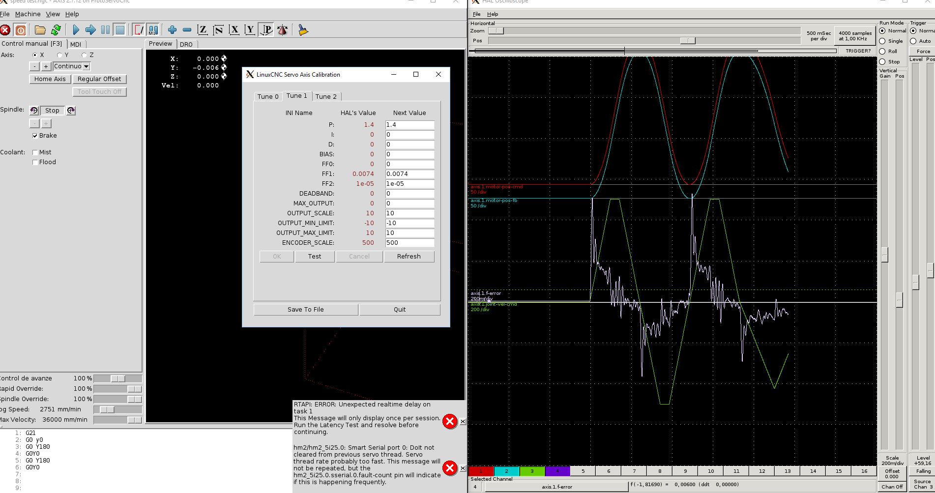

Im in the middle of a major reconstruction of my main cnc, mainly to seriously improve rapids speeds since its main use is to drill pcbs and need fast as can get (or pay) point to point movements
Im switching from some nema23 3NM steppers with a gecko G540 to leadshine EL5 400w servo/drivers (except for the Z, its still a stepper until I can pay for another servo)
Also had a 5i25 and now I added a 7i77, and 7i78 to control the remaining stepper and the new spindle, a westwind m320
So far, the best calibration I could get its the one on the image, please notice there Im testing at crazy high speed, and it seems that it could achive more
I had two questions:
Mainly, what do you think about those results showing in the scope? Can that be improved?
The second its about those warnings and how to solve them .
Thanks a lot!

My guess would be that your drive does not have its velocity loop tuned optimally, This should be done
before tuning LinuxCNC's position loop.

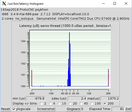

As a test can you run:
latency-histogram --nobase --sbinsize 1000
While moving windows around, running videos etc for a few minutes, and post a
screenshot here ( latency-histogram has a screenshot button and puts its screenshot
image files in /tmp/latency-histogram/ )

Thanks PCW!
here is the requested screenshot.
I tried to disable ACPI in bios, but afterwards LinuxCNC freezes the machine (mouse responds but nothing else), attempting to run the command latency-histogram --nobase --sbinsize 1000, also freezes the computer.
Nonetheless I can run these simple commands:

You have nearly 2 milliseconds of latency. This poor latency must be resolved either by choosing another PC or finding the cause I still think its likely that you have some power management features enabled in the BIOS or perhaps have a SMI issue (SMI issues show up as periodic latency spikes)
This post details some of the things you can do to reduce latency on a similar vintage CPU:

Are you sure you have disabled all power management in the BIOS?
Disable Cstates >1
also disable legacy USB
2 MS delays really suggest power management issues
It may also be a bad hard drive (do you see error messages in the kernel log?)
