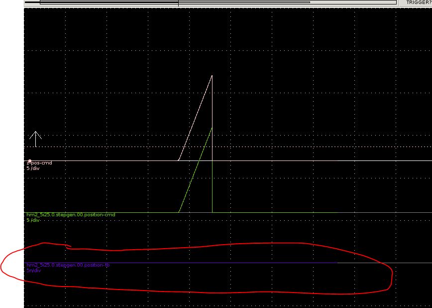

another noob trying to tune the servo
- Posts: 18103
- Thank you received: 5326
20 Sep 2018 21:01 #117824
Replied by PCW on topic another noob trying to tune the servo
Those changes are necessary but not sufficient...
Looks like you don't have the stepgen enabled

20 Sep 2018 21:06 #117825
by Psykhon
Replied by Psykhon on topic another noob trying to tune the servo
there is definitely something odd here, please look the attachment

20 Sep 2018 21:08 #117826
Not really very odd, thats expected if the stepgen is not enabled

20 Sep 2018 21:18 #117827
by Psykhon
As allways you are completely right, the problem was that the 7i78 doenst have enable signals, so I had to use one of the 7i77 outputs:
net z-enable <= axis.2.amp-enable-out
net z-enable => hm2_5i25.0.7i77.0.0.output-00
but forgot to:
net z-enable => hm2_5i25.0.stepgen.00.enable
but forgot to:

20 Sep 2018 21:40 #117828
Yeah stepgens need to be enabled just like analog outputs
Actually you can use 7I78 step/dir outputs as enables if a 5V signal will do
(just dont enable all the stepgens, and the unused stepgen pins will revert to GPIO pins)
