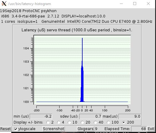

19 Sep 2018 22:27 #117769
by Psykhon
Replied by Psykhon on topic another noob trying to tune the servo
It was the SMI!, after unsuccessfully tried to recompile the smi module to accept the ich10 chipset, just downloaded the smictrl tool and this was the result
9 us with 9glxgears runing, I guess this is more than ok right?

20 Sep 2018 00:03 #117771
Replied by PCW on topic another noob trying to tune the servo
That's great, you probably can do without the isolcpus as that will just slow down the non-real time processes and make the CPU sluggish. Even 20-50 usec of latency wont have any noticeable effect on LinuxCNCs performance.
(as long as you are not generating steps in software for a parallel port setup)
