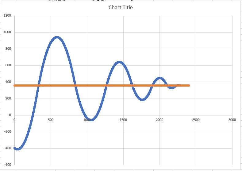

Unfortunately that made no difference -
I tried from 0 to 10000 - see below - with:
Home all. M100 G01 C360 F10000. Goes to 360deg fine. M101 G03 S500, then M05.
Then M100, and the C axis tries to go back to the 360degree pos, but oscillates, quite fast, 3 or 4 times, slowing down and getting there.
The rate of oscillation and time to dampen does not change for any values tried as below

06 May 2021 13:50 - 11 May 2021 10:05 #208110 by NoJo
That line [setp pid.c.maxoutput [JOINT_2]MAX_OUTPUT] : is present in the HAL file.
HALScope plot of -Pid.c.command and Pid.c.feedback - attached
Command is orange, feedback is blue, trigger on pid-c-feedback
X scale in millisec
Setup:
Home all > M100 > G0 C360 > M101 > M03 S500 - spin for 5 sec or so > M05 .
Then M100.
C_axis oscillates trying to find the 360deg position.
The command is set at 360,since C was at 360 before the M101. It looks like when the mode is entered (M100) , since the command is at a big number already, its seen as a big step change.
Also did a HALscope capture of Pid.c.command , Pid.c.feedback and Pid.c.coutput.
not including a plot here - output oscillates as does feedback, but 180deg out of phase

12 May 2021 00:07 #208607 by PCW
On the oscillation, you are not going to have much luck tuning the C axis
without using FF1 (FF1 should be 1 if the scaling is right)
12 May 2021 07:40 #208611 by NoJo
Thanks for commenting PCW..
I suspect however it is not that 'simple'....
There is a lot of lead-up in the preceding half dozen or so posts which you would need to read to understand what the problem is.
The C axis IS in fact currently 'well' tuned - when in C-axis mode ( M100) , any rotational move is very well controlled, totally stable, no overshoot, nice deadband of 0,05deg and rock solid. So the loop is fine - ONLY with FF1=0
here is probably a summary of the path getting to this status..
Initially any setting of Pgain between 3 and 0.001 was still unstable, with P>1 being very bad. Small changes in angle <5deg were 'reasonably' quick and almost stable, so this had to be related to the magnitude of the position change.
Looking at how the PID controller output is structured, the Feedforward term (FF1) would appear to be the culprit since it is multiplied by the command derivative - this forms part of the PID output, and since the change in command is large and instantaneous ( say from 0deg to 360deg), the contribution could be excessive.
I set FF1 = 0 to verify, and it works...the angular changes (G0 C0, G0 C360, etc) are rapid, stable, with no discernable overshoot at all.
There was a slight wobble around setpoint, but Deadband was set to 0.0 - and so since I have a 4096 ppr encoder = 0.088deg/encoder line, I set Deadband to 0.05 and now it is dead still around setpoint.
The problem is not while in M100, but , after Homing all axes and then enabling C and moving it to a setpoint and then moving C off that position in spindle mode, doing some machining ( that is, M101) mode in this setup, and then activating the C axis with M100 again - the system moves the C axis back to the last C Axis position, and this move is unstable - you would need to read the previous posts to follow the reasoning and attempted solutions - it does not really have anything to do with 'tuning' the PID - remember that the spindle/C axis motor is an internally closed loop step/dir servo.
This is another exerpt from a previous post..
It is as though there are some PID parameters not being used in that initial move to setpoint angle? ( when setpoint and current position differ and we do M100 - a step change)
( Andy responded with some ideas here)
Yes, that's right. When you switch to C-mode the position-feedback to the PID will be (for example) a million degrees, and the PID output will be correspondingly very high. This _is_ a step change in input to the PID.
Then the index-enable does it's thing and the position-feedback becomes zero, which is a second step-input.
You can probably calm this down by using pid.c.maxoutput, set that to 400 (it wants to be just a bit more than the max velocity in C axis mode).
It's 'those' step changes that are the problem, and the loop cannot be 'tuned' to manage those situations - a different approach is needed for that initial C_axis activation where the current position and setpoint differ greatly, ie, a step change. For that situation, in my initial tests, I had FF1=1 and the spindle went berserk during that switch to C mode ( M100)...
And what that approach might be is somewhat more complicated than I can manage!
12 May 2021 12:48 - 12 May 2021 12:48 #208621 by PCW
FF1 is required for decent performance of a velocity mode control loop
Fixing the initial move when returning to C mode may require different
PID tuning but that should not compromise normal C mode operation.
You should be able to reduce the initial error by making sure that C is at 0 before
switching to spindle mode, clearing the encoder before switching back to
C mode and then re-homing to index.
The step when index occurs should be masked by the PID (so FF1 is not relevant)

12 May 2021 14:55 #208626 by NoJo
It is difficult for me to try explain - I am an amateur wrt HAl and the deeper functions Andy is implementing, so I cannot comment intelligently wrt the way the functions are implemented. My posts are far to verbose in my attempt at getting the detail across, and then the reader is overwhelmed by my guff and loses the essence of my problem...or loses interest.
I am not inexpert in PID control loops , however , but in the aeronautical world - flight control and autopilot systems for military jets and large UAV's - PID's are PID's no matter what application, so I am no out of my depth there.
The issue here is not really a PID problem.
As Andy said :
This method works here largely because you are using step/dir drives with an internal position loop. It wouldn't generally work so well for a VFD or similar.
The result is a fully functioning, stable, well tuned C axis. It positions well, fast and is critically damped.
it does NOT work with any FF1 of note...I suspect because the loop is closed inside the servo..
The issue is that there is a step change ( and this is how I see it - this is NOT a PID issue, but one of how the function is implemented)
resulting from the enable of the C axis while there is a big delta between actual and required angle. This feeds the C_Axis PID control loop which is not tuned for such step changes and will never see such changes while it is enabled and working normally.
Why I said this implementation may need adapting is because the homing of the C axis is not to the encoder index - the current mechanical position of the axis is taken as home = 0 : everything is reference to that thereafter, which is acceptable.
The C axis does not move mechanically on initial HOME, since Z and X are active, and M100 is inactive, so the axis will not move.
But the home makes the Caxis DRO=00, and the axis takes that position as 0 as well.
A 'step change' in commanded angle in a G0 C360 ( say from 0deg), for example goes through the PID and is well controlled and stable, well damped and fast.
I fail to understanding why that works, and why the 'step change' during a M100 selection with the commanded and actual angles different, by a similar amount, does not work - it is obviously because the PID is not initialised in the same manner, or something, but I cannot see how - I do not fully understand Andy's C axis implementation , obviously!
12 May 2021 15:09 #208629 by PCW
The step generator is running in velocity mode therefore FF1=1 is required for optimum performance, this is not in question. The best solution would be to eliminate the step position commands (or rather step differences in commanded and feedback positions)
Do you clear the encoder before changing to C axis mode?
A G0 command is not a step change but obeys the motion acceleration and velocity constraints
12 May 2021 17:20 #208633 by NoJo
I can post a video if you wish of the operation with FF1=0 and FF1>0 - I am quite sure of this...ANY positive value for FF1 and the axis, in normal C axis movements, ie, G0 Cxx or G01 Cxx Fxxx becomes increasingly unstable.
If FF1=1 the axis is violently unstable - with halmeter of Pid-command and Pid-feedback not showing signs of converging- at least not in the 5 second realm! With FF1=1, there is no value of Pgain that even begins to tame the axis... reducing FF1 and things calm down - with FF1=0 there is no more instability, unless you make Pgain to high of course.
Pgain is presently 0.1 - make it 1 and it is VERY unstable.
If FF1 must be = 1 , then there is something else lurking in the implementation that is a problem...
I don't know if the encoder is cleared - I think my understanding of how the implementation works is inadequate, and so my explanation as well.
After power on, HOMING the axis accepts the current axis position as zero( DRO=00) - I presume that implies the current encoder count, not the encoder index position, etc. It does not first move the axis to the encoder index position - I presume it just takes the encoder value as the homeposition.
Then with M100 enable the axis, and since the current position and commanded position are the same ( zero), there is no movement.
Now a G0 C270 moves the axis in a controlled manner to 270deg. Moving to any other angle is similarly well controlled.
Then a M101, and M03 S1000 ( for example) - moves the spindle ( and encoder) elsewhere, since the spindle is spinning at 1000rpm.
Then M05 - stop spindle.
NOW - the spindle is not where we were before at the last G0 Cxx move, so an M100 tries to get the spindle back to that last position -NOT the encoder index position with a move to the last position. IAW, the spindle does not do a 'home to index' and then rotate to required angle - it just moves to the required angle directly, but oscillates...If the delta is small, maybe less than 10degrees, the movement is gentle, with overshoot.
So I do not know how that is achieved - it is one of the things I wished to ask Andy to explain in depth..somehow the present encoder count and last encoder count before M101 must be kept and subtracted, or something...??
