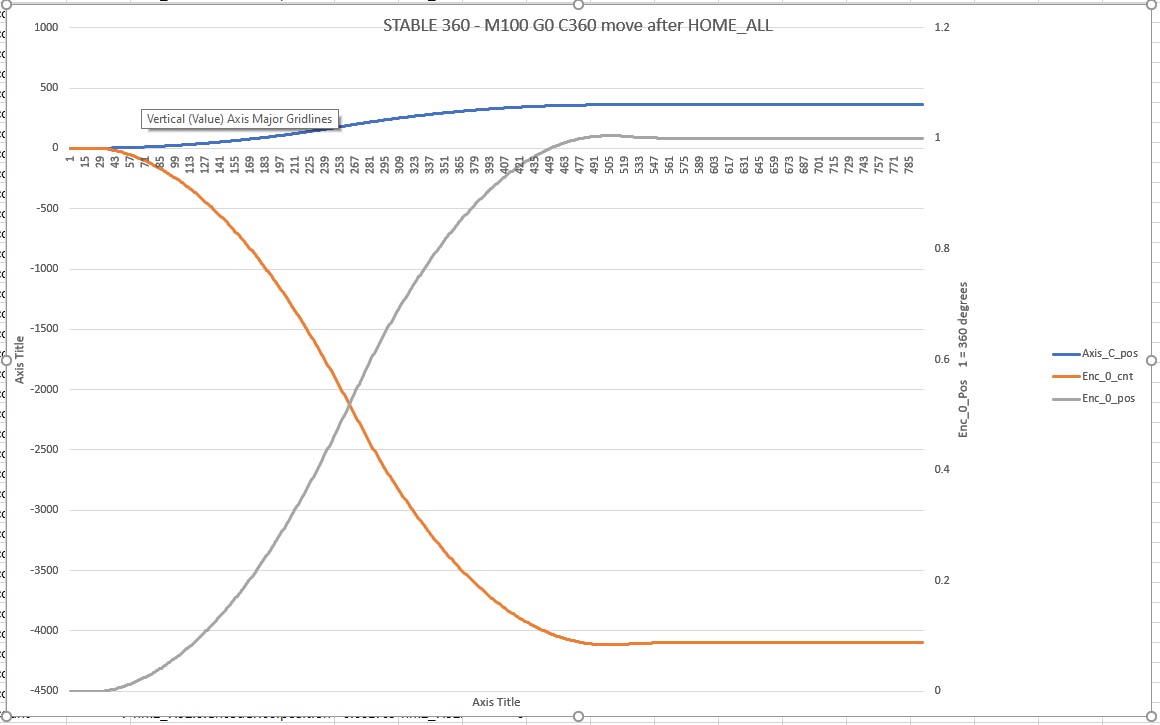

Ok for you and Andy, I did a few Halscope plots - that is tedious! Transfer the log file windows, excel, screen capture, etc, etc..
I set up the scope to capture:
axis.c.pos-cmd
hm2_7i92.0.encoder.00.count
hm2_7i92.0.encoder.00.position
I also opened a few Halmeters:
pid_c_command
pid_c_feedback
Procedure:
After starting LCNC I HOME_All, then the column 'user input' are the commands/mouse clicks I execute.
The resulting values of the parameters are then shown the the same line as the user input, for that input.
user input	7i92enc.pos	7i92enc.cnt	pid_c_cmd	pid_c_feedbk	DRO Value
HOME_ALL		0		0		0		0		0
then M100,
   G0 C360		1		-4096		360		360		360
				[see halscope Stable_360.jpg -	move to 360deg was stable]

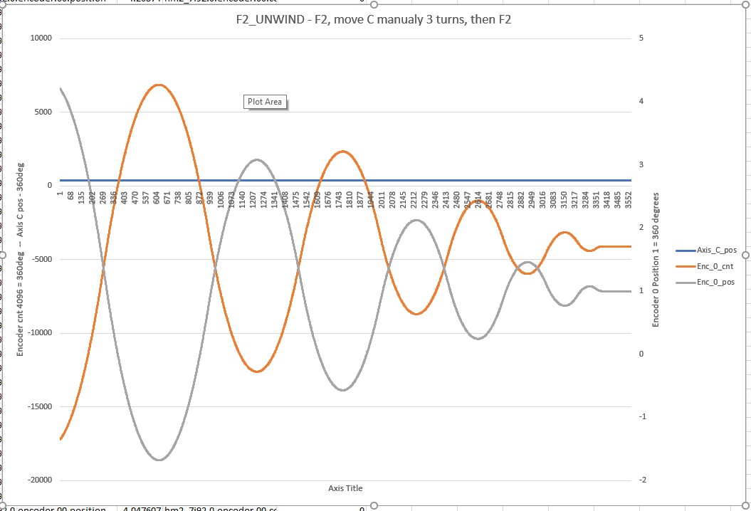

Then F2
Move C 3 turns
     Manually		4.33		-17739		1559		360		360
  Then F2		1		-4096		360		360		360
				[see halscope F2_Unwind.jpg : When axis enabled-F2
				it unwinds the 3 manual turns first -wild oscillation
				DRO did not change during manual move of C axis]

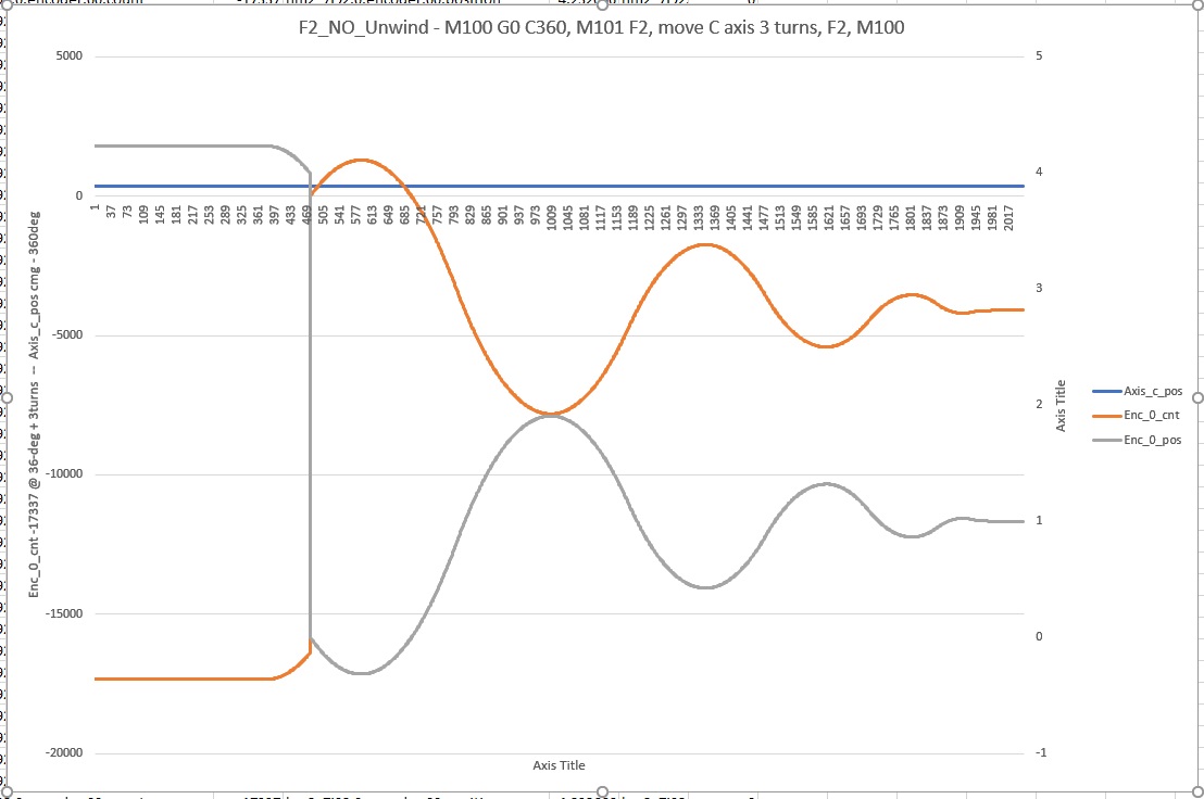

 Then M101, F2
Move C 3 turns
     Manually		4.23		-17339		1523		360		360
 Then F2, M100		1		-4096		360		360		360
				[did NOT unwind the 3 turns, went to the 360deg pos, oscillated
 				briefly, and stopped. NOTE : DRO did NOT change during all
				 of this see Halscope F2_NO_Unwind.jpg]
Leave as above, M100
is active, C@360

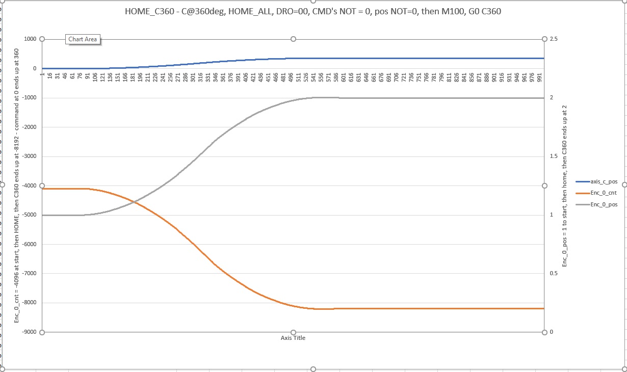

then HOME_ALL		1		-4096		360		360		0
						[ NOTE - DRO went to 0 during HOME _ALL, but
						 pos, cnt and cmd remained as they were]
Now G0 C360		2		-8192		720		720		360
						[Now the DRO is correct, but the encoder pos and

1. Encoder counts are not used so there no point in plotting them.
really only interested in encoder position (position feedback)
and position command

If you disable the axis (F2) and move it, or M101 and run the spindle with M03 Sxxx, then M05, then M100 again, it will oscillate till at position - for seconds. Thereafter, as above, ALL further moves are stable and clean.
(NOTE - I have tamed that oscillation with your suggestion of pid.c.maxoutput = 5, and increased max_vel and max_accel., but this is just masking the issue).
To an extent you are always masking issues with PID. You have to find a compromise that works in all conditions.
Something that might work would be to set the pid.c.maxoutput to a low value in the M100 script, wait a few seconds, and set it back.
I think that inserting
halcmd setp pid.c.maxoutput 1
sleep 2
halcmd setp pid.c.maxoutput 10
Might work.
