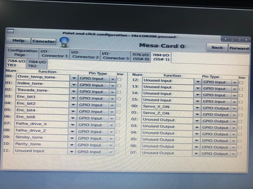

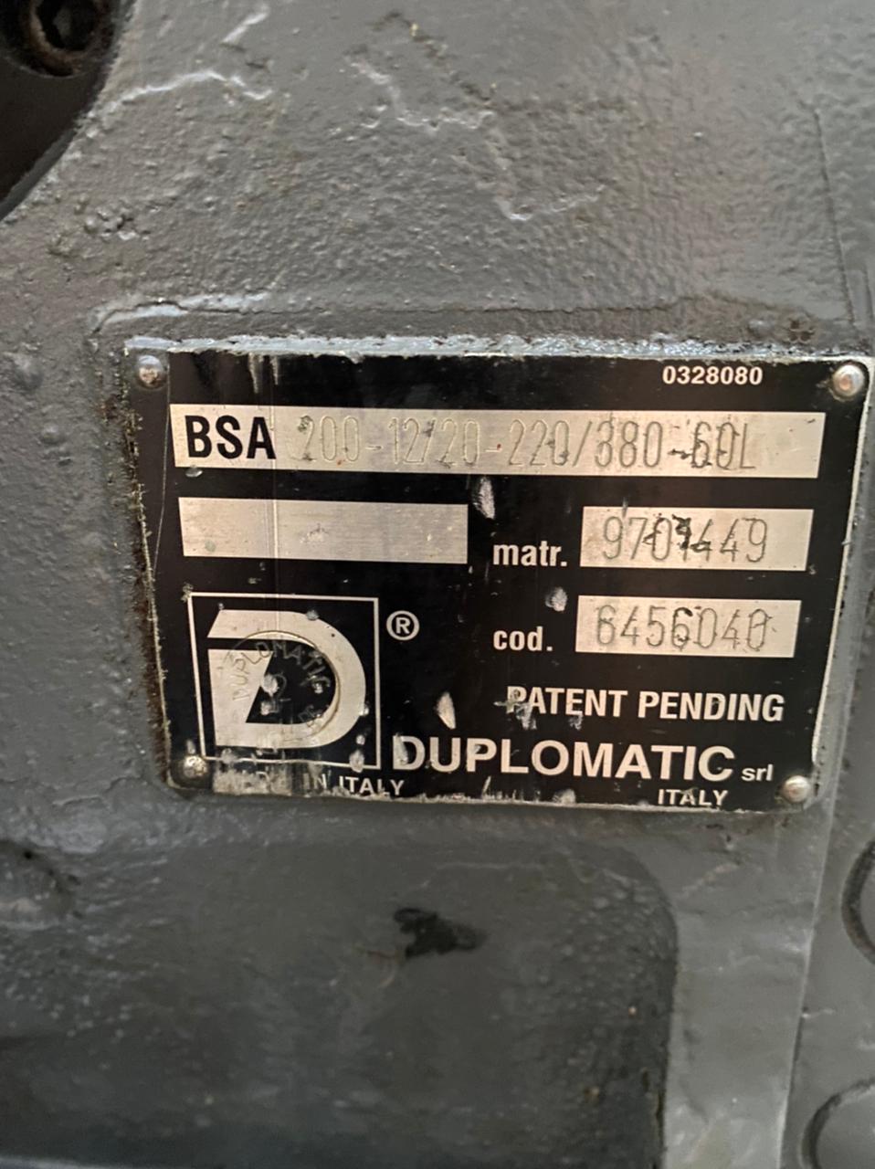

- Ingo
- Posts: 114
09 Jun 2021 05:03 #211590
by Ingo
Replied by Ingo on topic implement 8-tool turret on lathe
Hi guys, I was reading, looking for something about my Turret model (BSA 200 12/20), but as I'm nob and the first time I'm making a turret, I'm suffering a lot..., actually I was very confused. First of all, I don't know if I can take this model from you because you are different. Another thing, my 12-position turret, I use the inputs, Bit1,2,4 and 8 I know it also has Parity and stroby (I don't know what it's for, how do you use it), it still has over temperature, index and locked..., how I use all this, could someone clarify me, show me the way, because I'm using 7i76E and a 7i84 daughter (including all turret entries are on it).
Thank you very much

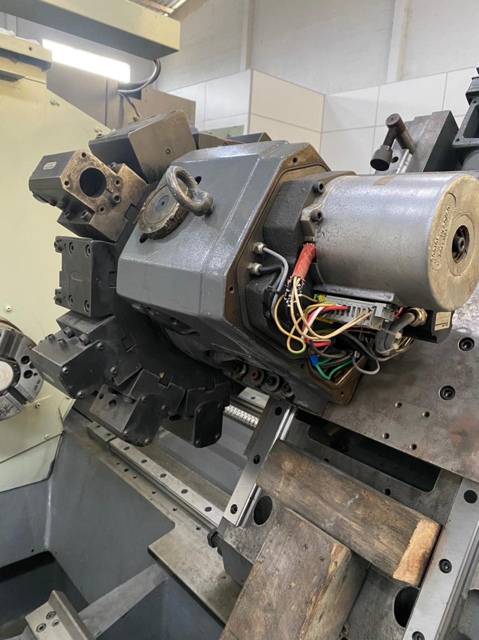

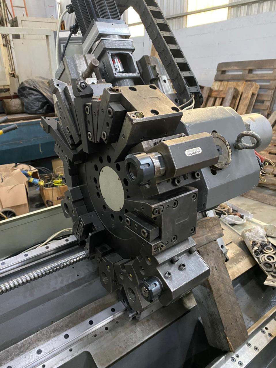

- Ingo
- Posts: 114
28 Jul 2021 01:11 #216089
by Ingo
Hello,
Follow the photos on my ATC. Tell me something your turns only to one side and reverses the rotation to lock?
Ingo
Ingo
- RobotMatic
- Posts: 199
- Thank you received: 25
28 Jul 2021 16:03 - 30 Jul 2021 16:21 #216129
by RobotMatic
Replied by RobotMatic on topic implement 8-tool turret on lathe
one direction , all Hidraulic !!
video Turrent
