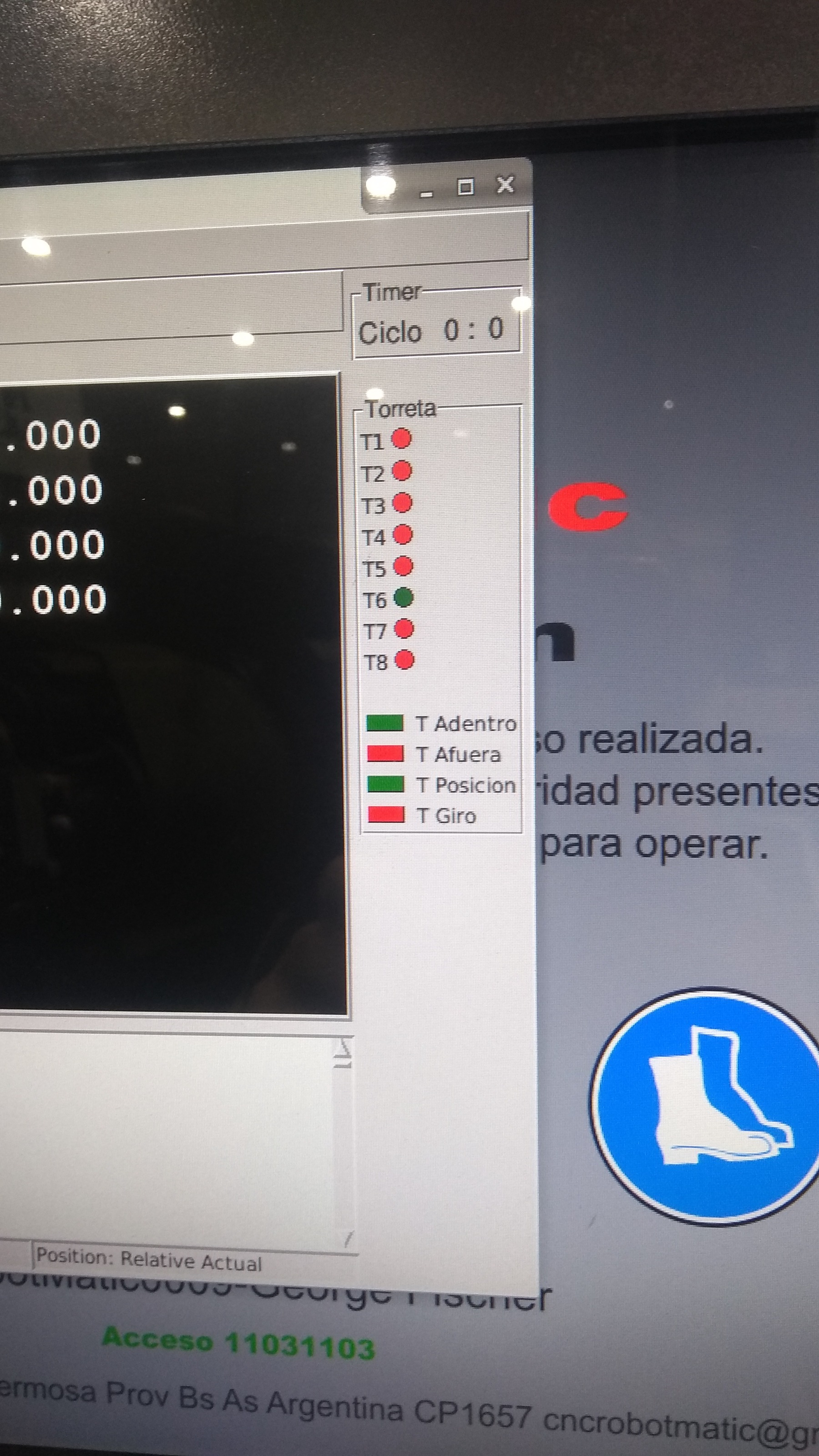

11 Sep 2021 00:50 #220177
by RobotMatic
Replied by RobotMatic on topic implement 8-tool turret on lathe
TURRET WORKING
I leave here the turret working !!. Although it could improve the programming, it was a challenge for me to do it and I will surely do so in the future. Just thanks to everyone who always helps me in this forum, Thanks Linuxcnc for being a great application that allows me to do these things !!! I will continue now with other challenges !!! thanks to all

11 Sep 2021 00:53 #220178
by RobotMatic
use panel programming PyVCP
