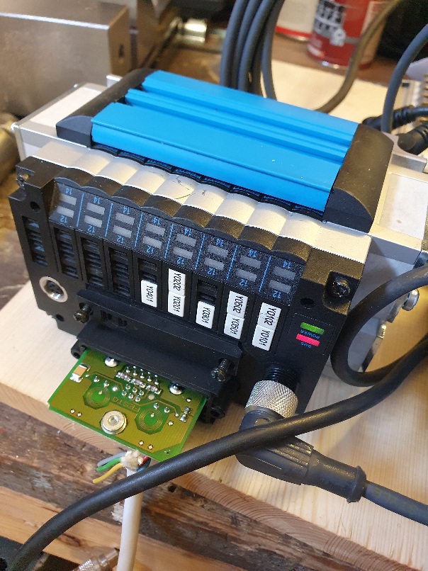

This is a quick demonstration of a Festo CPV10-GE-DIO2-8 valve block connected through Profibus-DP interface using the PC-serial port. This uses the 'pyprofibus-master' found here:

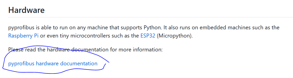

Looking through the GitHub, I would have no idea where to start to use this widget. Im not a complete idiot (I hope), but there is no clear thread in there which would give an indication to a low level user, which of the large number of files need to be downloaded, where they need to be installed, how to integrate them into LinuxCNC, or how to use it to control a profibus device.
The link to hardware is broken.

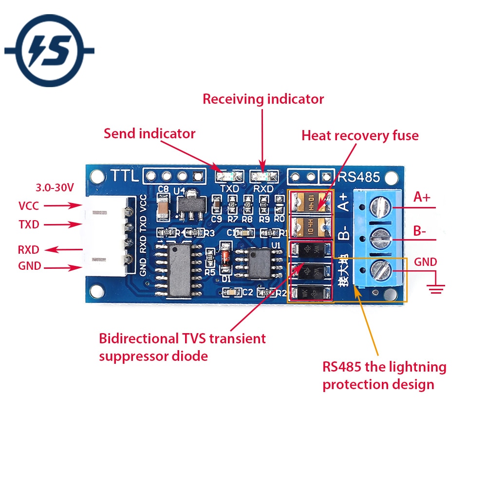

The author doesn't recommend using a usb to RS485 adapter, because of the time lags that can happen with USB, although I did quickly try with one and it seemed so be working well enough. The recommended way is to use an RS232 port with a TTL to RS485 adapter like this:
I use a serial port on a pc that can be configured as an RS485 in the BIOS. In any case you just need to connect the two data lines to the device, no other connection is needed.

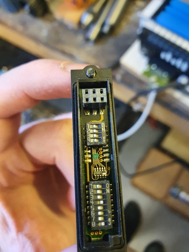

Getting the configuration right takes a few steps. First you need to get the .gsd (german) or .gse (english) files from the manufacturer website as these contain the required parameter settings for the device. (note that if you use the .gse file it will need to have the extension changed to .gsd). There are some demos for linuxcnc included. Basically the file 'pyprofibus.conf' needs to be modified to set up the profibus connection ( ie port and baudrate, bus address of all the slaves and the number of input and output bytes for each of them and the path to the respective .gsd files).
One problem was that the current version of 'pyprofibus' did not support devices that don't send data back to the master during communication. The valve block only sends an acknowledge byte back and that was not recognized as a response leading to timeouts and the master shutting down. I reached out to the author on his github page ,he's really quite responsive and helpful, and got it working.

A little update on this. To try the extension capability I bought a 8 channel digital output module and a 16 channel digital input module to connect to the CPV valve block on ebay for less than 30$. All works quite nicely:

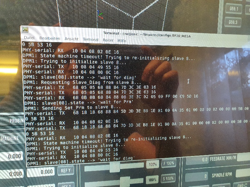

Hi! I am trying to get the same setup to work.pyprofibus is running, but no communication to the cpv is possible. Perhaps my output module is faulty(no Power led). But even with only the cpv connected I cant establish connection. Dip Switches set accordingly and modules in config delted and pins # tagged. I am using an usb to rs485 connector currently. Tomorrow an serial to rs485 adapter arrived. But I thought it should work a bit with usb(maybe Just some interruptions).
@Aciera: can you help me with troubleshooting?

First you will need to get the cpv module powered up. Do you have 24V on pin 1 and 0V on pin 3 of the 4-pin M12 connector?
Once you have that fixed you should launch linuxcnc from the terminal to get more debug information on what the profibus master is doing.

Cpv has Power on logic and valve pin.red led is blinking once a second. [/code]

DPM1: Trying to initialize slave 8...
PHY-serial: TX 10 08 02 49 53 16
PHY-serial: RX 10 02 08 00 0A 16
DPM1: slave[08].state --> 'wait for diag'
DPM1: Requesting Slave_Diag from slave 8...
PHY-serial: TX 68 05 05 68 88 82 6D 3C 3E F1 16
PHY-serial: RX 68 0B 0B 68 82 88 08 3E 3C 02 05 00 FF 00 C9 5B 16
DPM1: slave[08].state --> 'wait for Prm'
DPM1: Sending Set_Prm to slave 8...
PHY-serial: TX 68 13 13 68 88 82 5D 3D 3E B8 1E 01 00 0A 35 01 00 00 00 82 00 00 00 7B 16
PHY-serial: RX 10 02 08 02 0C 16
[qtpyvcp][INFO] Logging to /home/cnc/qtpyvcp.log (logger.py:97)
[qtpyvcp][INFO] QtPyVCP Version: v0.3.19 (opt_parser.py:199)
PHY-serial: TX 68 13 13 68 88 82 7D 3D 3E B8 1E 01 00 0A 35 01 00 00 00 82 00 00 00 9B 16
DPM1: State machine timeout! Trying to re-initializing slave 8...
PHY-serial: TX 68 05 05 68 88 82 7D 3C 3E 01 16
DPM1: Trying to initialize slave 8...[code]

Replied by Aciera on topic Linuxcnc and Profibus
Ok, so they are talking.
I noticed that in your pyprofibus.conf you have:
Which is incorrect. Since you have only the base module (with 16 digital out) your slave transmits 0 bytes to the master and expects to receive only 2 bytes from the master.
So try changing the above section to this:
; The number of output bytes this slave transmits to the
; master in Data_Exchange.
; This usually depends on the modules plugged into the slave.
output_size=2
; The number of input bytes this slave expects to receive
; in Data_Exchange.
input_size=4Which is incorrect. Since you have only the base module (with 16 digital out) your slave transmits 0 bytes to the master and expects to receive only 2 bytes from the master.
output_size=0
; in Data_Exchange.
input_size=2
