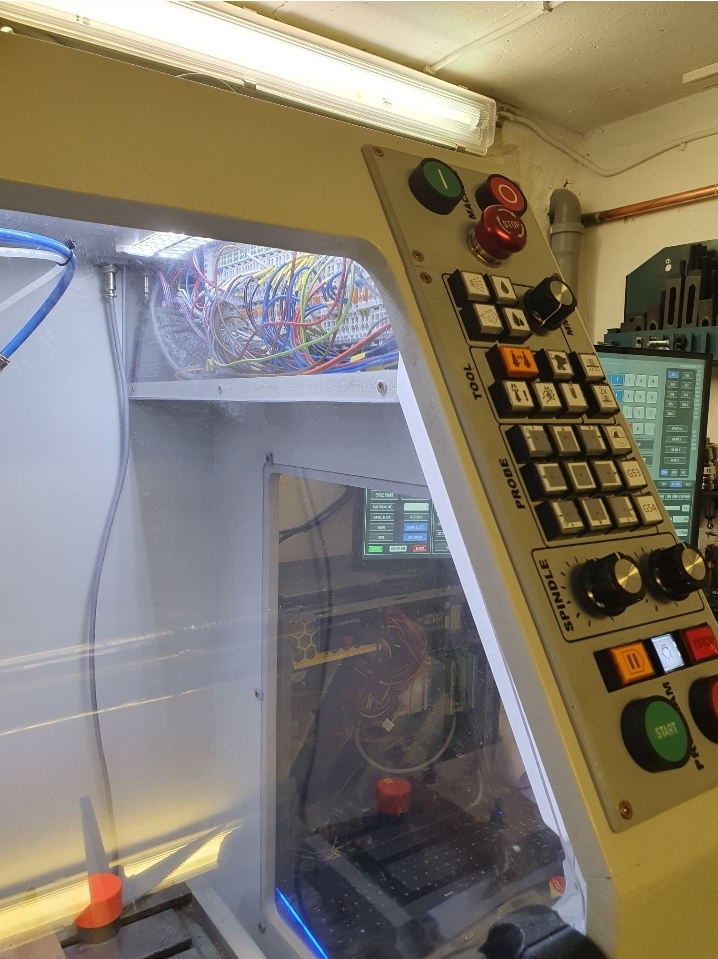

pyprofibus works with wago profibus I/O modules ?

I presume so. Maybe this helps:
blog.rahix.de/wago-750-303/

Yes its working. Even with analog input module. I use them for feed/spindle override
