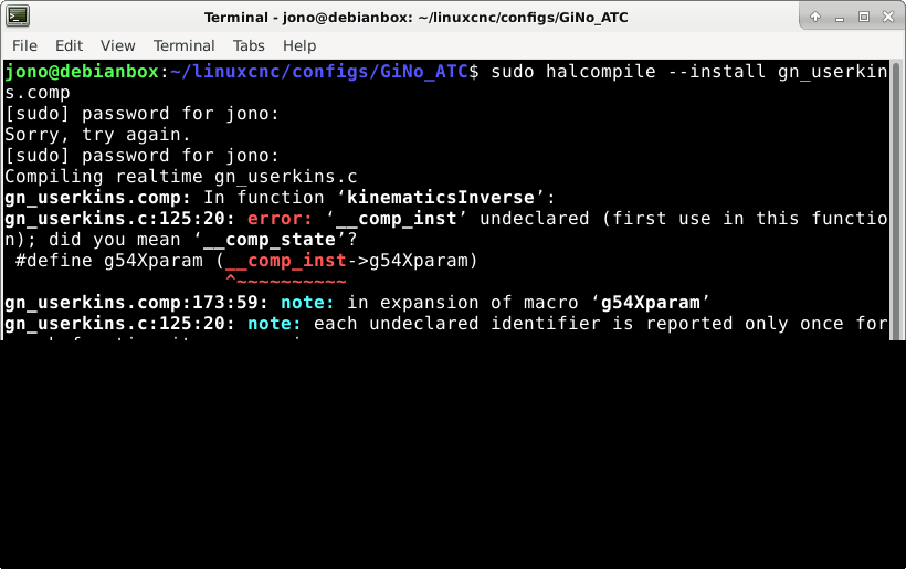

Is it possible to set a value in a switchkins component using a 'param'? In other components we have done we have used a statement such as
param rw s32 extend-sensor-timeout = 5000
in the component .comp file, and then set the actual required value in the hal file using:
setp jntoolchanger.extend-sensor-timeout 1000.
When I try do the equivalent in my kinematics component, and do the halcompile I get the following error. The halcompile error goes away if I do not actually use the value in the kinematics component, but then linuxCNC will not start as the link between the reference in the hal file and the actual parameter is not found.
If this way of setting a value in the kinematics component is not possible, is there another way I can achieve the same functionality?

15 Nov 2021 14:15 #226579
by dgarrett
Replied by dgarrett on topic Developments on my Home built 5C CNC Lathe - Polar interp. and Live tooling
post the file that fails (helpers are not clairvoyant)
- NoJo
- Posts: 180
- Thank you received: 43
15 Nov 2021 15:10 #226581
by NoJo
Replied by NoJo on topic Developments on my Home built 5C CNC Lathe - Polar interp. and Live tooling
Files attached. Last line in hal file. Parameter g54Xparam in gn_userkins.comp
