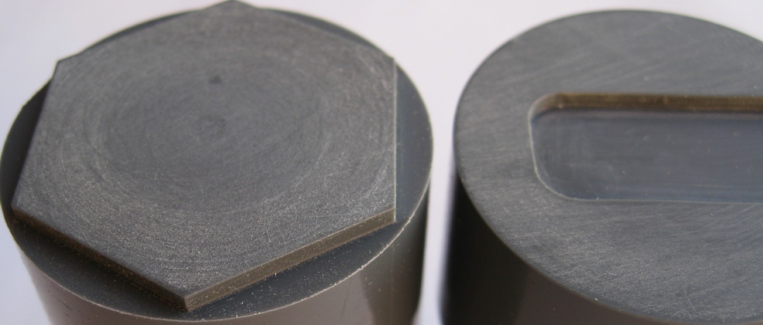

Attached is a zip of all the comps/remaps/ini/hal, etc
C axis mode is entered with G12.1 - this zeroes the C axis as well. L-CNC would tally all revolutions made by the spindle in turn mode, and then on entry to C mode, would unwind all those turns to zero the C axis - not desirable. So look in Caxis.comp and refer comments in gn_userkins.comp for how this is done on my machine.
G13.1 exits C mode back to TURN mode.
G12.1 selects C mode - POLAR mode - no cartesian , but C axis effectively becomes Y axis of a mill, etc.
The ATC is included in the attached files.
This Gcode is an example of that used to do the hex head on the end on the shaft, in two depths, each 2mm deep (final 4mm)

Makes pretty things as in the picture attached..

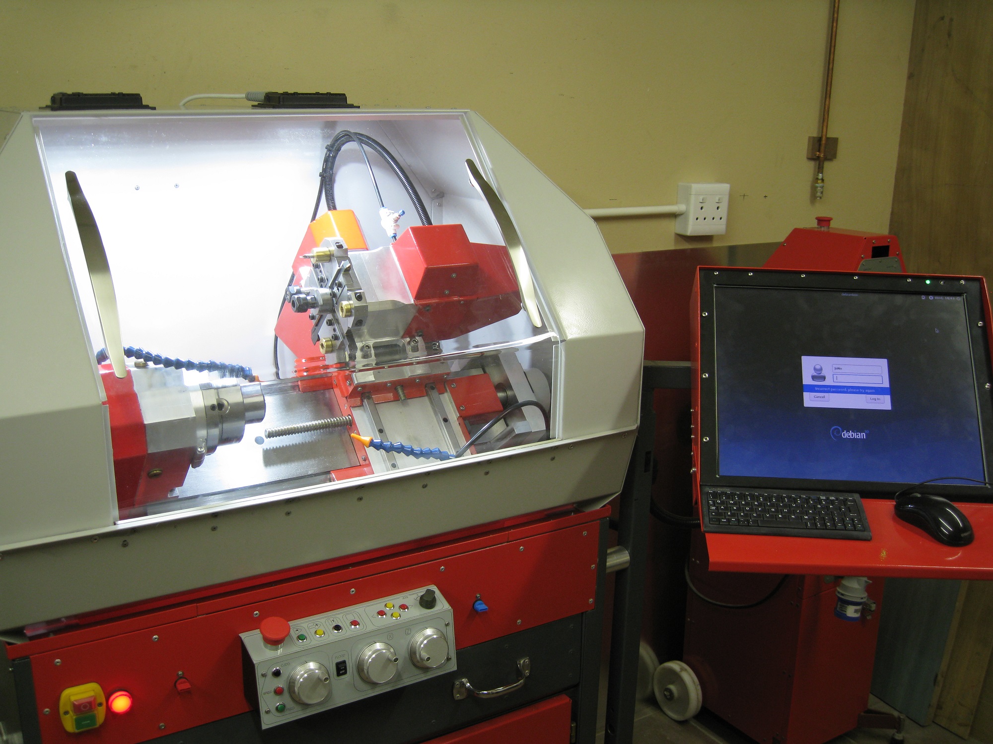

WRT the ATC - If I recall, the basic carousel comp requires the ATC hardware to be able to rotate the carousel, past the tool locate point, a pawn then engages and the carousel is then rotated backwards to lock against the pawl ( EMCO style..)
If you study my ATC you will see it uses a hirth coupling and compressed air to disengage the coupler, a stepper to rotate to the next tool, with opto-sensing of tool position, and then air release to lock using compression spring discs. Also, the ATC has a live spindle as a tool select - none of this is available in the basic carousel comp - if you want fancy, you have to pay in pain..I paid a lot, nearly giving up many times...
I would not have succeeded if it were not for a LOT of help from Andy, Aciera and
DGarrett, and my good Wife, a really good software Guru.
Re the F360 processor - I think you have me confused with someone else - I never paid for F360 anything - I don't use F360, I dislike the marketing model and its Pro price, esp for hobby use...
I use Rhinocad-7 and Rhinocam - the latter cannot do Mill/turn, ie, no C axis capability in lathe CAM. For this lathe I use eCam - an Italian fellow's creation for Mill and Lathe, with a very usable C axis mode - it is very good, free on weekends, and two or three hundred Euro to buy.
I can share the 3D cad files for the lathe/ATC, etc, but it is all Rhinocad format (.3dm) - I can convert to other standards, but that always creates issues...
