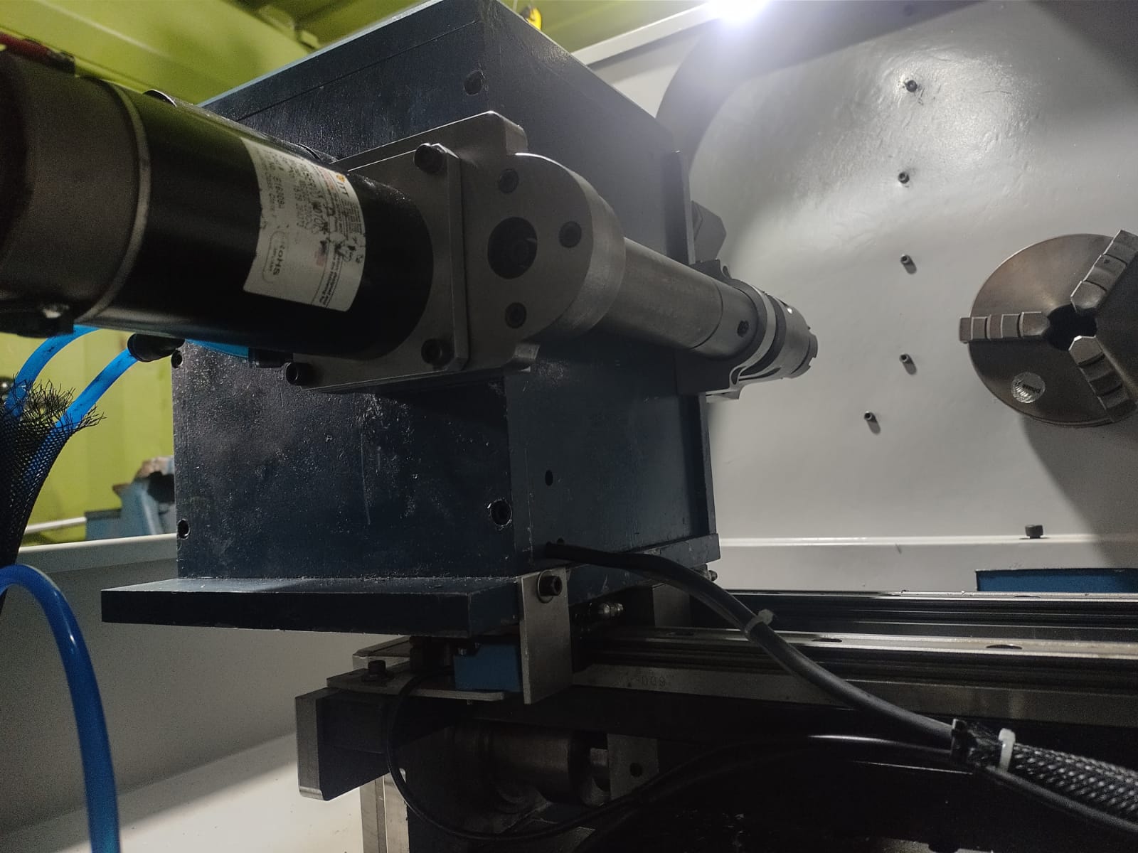

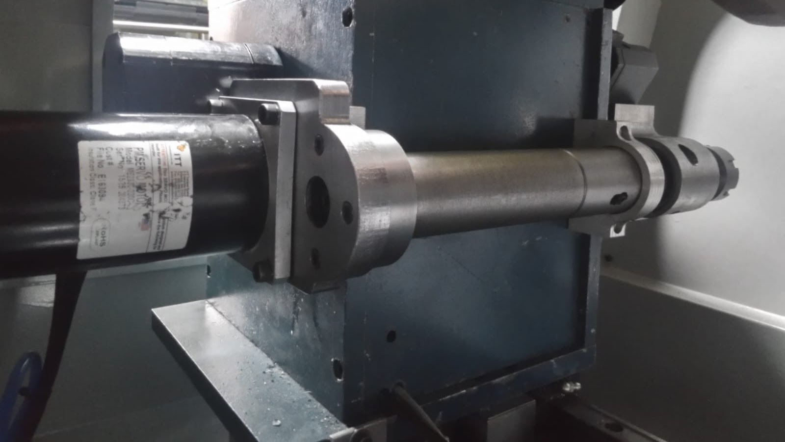

In that sense you are wrong, the carousel component does not do what you say, it rotates until it finds the selected tool through the sensors installed in the ATC, as you can see in the attached video. I used hall sensors configured as gray code, not binary, which are activated by contact with magnets installed on a disk that rotates with the tool changer. I also used a stepper motor but configured in speed mode. And I was careful to install another hall sensor that detects when the turret is unlocked and also another sensor to detect low air pressure and through an AND activate the stepgen that controls the ATC engine motor. I did all the implementation with the help of Andy, who developed this component and as he himself indicated to me, for a lathe the implementation was simpler than for a milling machine.
A live tool was also installed, but since the turret was already built, it was decided to use one of the tool pockets to install it using a coupler that disengages from the live tool motor when the turret is activated by the pneumatic piston, this is Taken from a YouTube video of someone who implemented it like this and who also uses LCN
