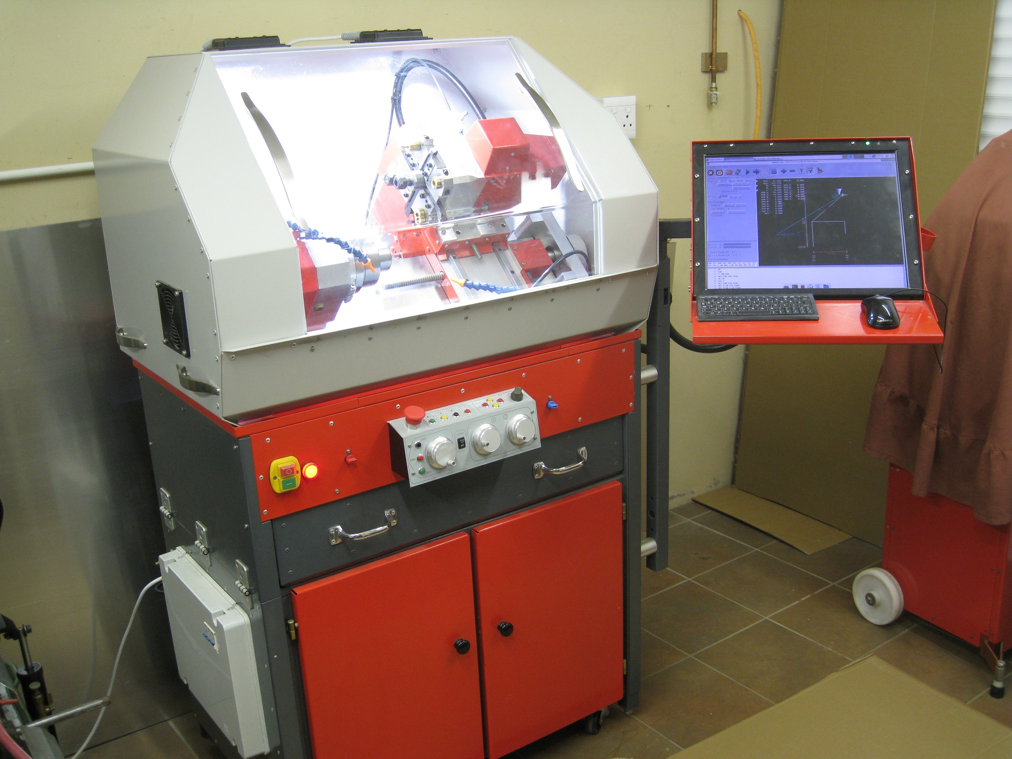

BTW - Once the lathe sits on the mantelpiece, you need to consider how you will create G code for it - C-Axis capable Cam software that leaves your wallet somewhat intact is scarce. RhinoCad/Cam, Alibre, and most of those of similar ilk don't do it. I eventually found two packages - neither take a file directly from your favourite cad package, although they can take a DXF type file, etc. They tend towards 'conversational' style Cam, which is not bad, since most 'simple' C axis ( single live spindle only) operations are very easy to program that way. (Also, your lathe needs a live spindle of some sort too...Axial or Radial..). The packages I used are Kipware ( USA - Google them, if you can stand the OTT 'in-your'face' attitude of the web site and its operators) and an Italian fellow selling E-Cam ( Google e-cam.it) The latter is actually quite good, and is fully functional free to use on weekends
- Posts: 4819
- Thank you received: 2176
23 May 2023 16:40 #272026
Replied by Aciera on topic Developments on my Home built 5C CNC Lathe - Polar interp. and Live tooling
Yes, Gcode generation often comes as a bit of an after thought.
What I'm personally most interested in is how you managed to switch from lathe spindle mode back to c-axis mode in Gcode (presuming that your config can actually do that). Running it in lathe spindle is too fast for linuxcnc to keep count of the encoder position so going back to the rotary mode requires to somehow "rehome" the rotary axis.

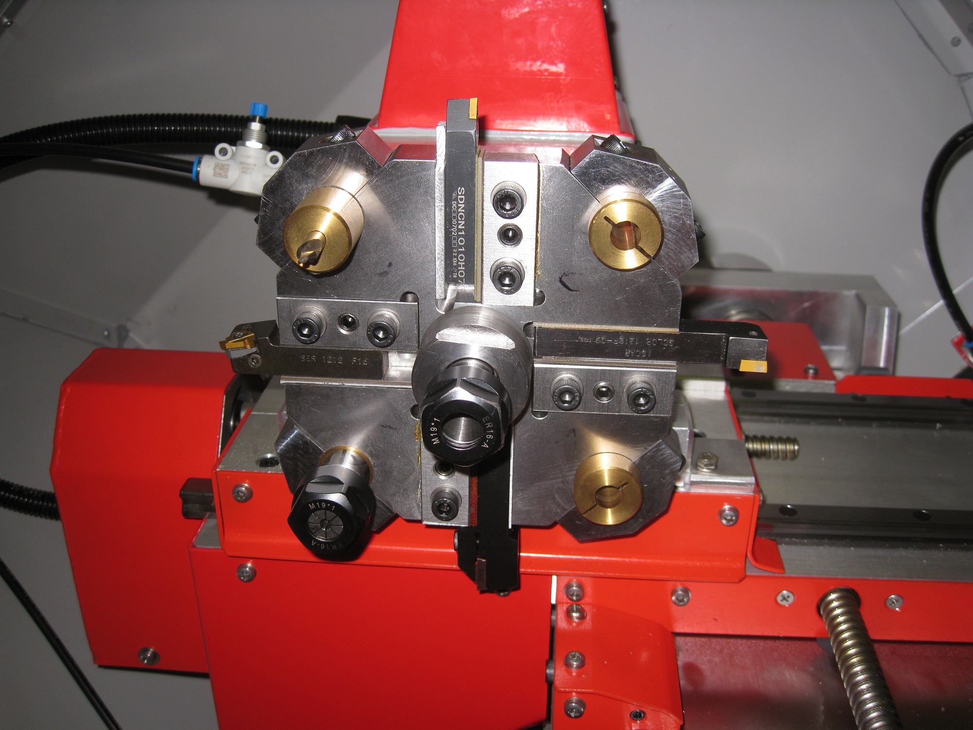

I've got a Kipware seat - never used it as I couldn't stand it once I bought it.
However, as I've mentionend elsewhere, F360 will handle C-axis lathe work just fine. I have a post processor that works for both radial and axial tools, as well as synchronized live-tool motion (tapping).
I paid for the post, but I'm happy to share it with anyone - especially if someone wants to have a go translating it from Fanuc dialect to LCNC. I'm not a post expert so will need some help if I do more than C-axis indexing.
Because there is no continuous 4th or 5th axis movement, you don't need the $$$ manufacturing extensions. The free/student/startup/standard licenses all work for 3-axis simultanious and 3+2 indexing.
My particular challenge will be integrating a separate axis. Think 2nd, independent, slide attached to the head for a parting tool and/or a live tool. I'll probably have to hand-code that one and treat it as a U/V/W axis.

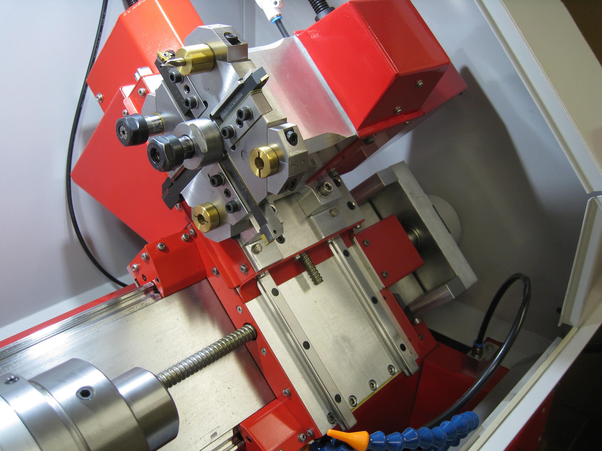

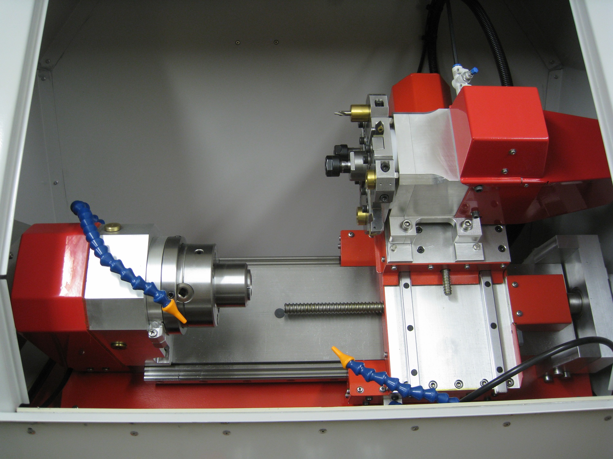

Ralph and Interested Parties...Braved the cold Shop and begged the Good Wife to dig out all we did.I have not given all the bits and pieces - such as the Toolchanger component, which is very specific, etc
The attached zip file contains the relevant components we developed and use on the Caxis, specifically :
(1) caxis.comp - hugely assisted and developed by Andy Pugh : controls the spindle as a Caxis
(2) gn_userkins.comp - functions related to kinematic switching. This was developed based on the provided millturn example.
Associated with this are the g12.1 and g13.1 gcode remaps and M128 and M129 mcode files
(3) hal file
(3) hal file
The following user(s) said Thank You: besriworld, Aciera, spumco

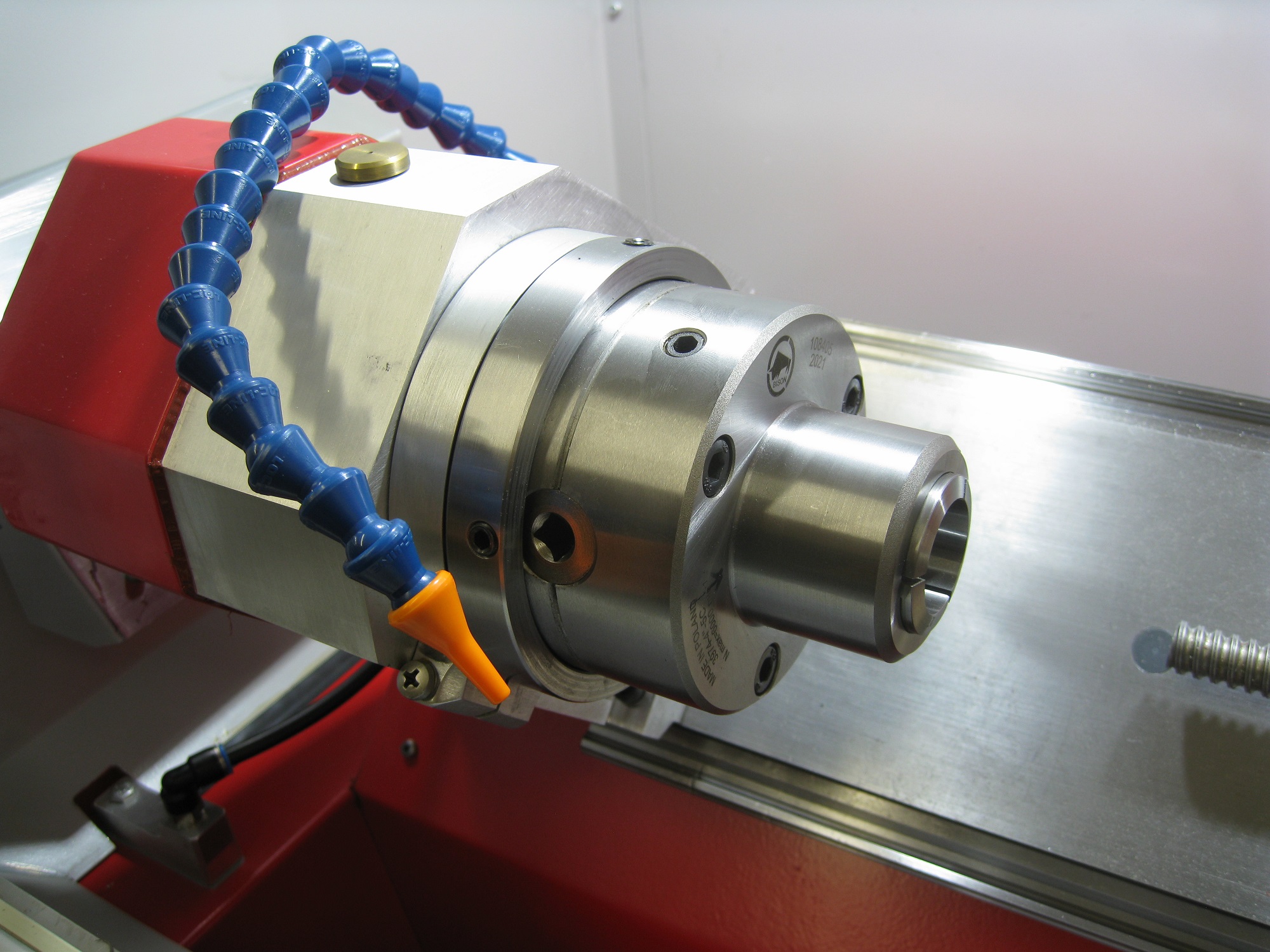

Not sure what the belt is called - its flat, 25mm wide, about 7 or 8mm thick and has 8 V's on the inside. The pulleys on motor and spindle are self made, 80mm O/D with the V's machined in.The spindle motor is a servo motor ( of sorts..) - its from TEKNIC, a Clearpath NEMA-143 motor 240/315VAC 3 phase, driven by step/direction inputs, 2800rpm max, 33NM, and with positioning accuracy of 0.03deg - pdf attached. Ratio is 1:1.
The C axis accuracy is still not where I want - The encoder I use I made - it is a magnetic encoder with a 4096 PPR output, which is around 0.09 deg. Since the servo does 0.03, I would prefer am 16000PPR encoder, with 0.023 deg position, and with a dead band or 2PPR - gives me around 0.04deg position repeatability, which would be 100% better!
Why have I not pursued that? Well, for me the C axis is a live one,ie , I intended to use is in milling shapes on the ends of a shaft type of thing. That means the C axis is moving all the while, synced with X/Z, with no brake on C. But...That 25mm flat belt has 'some' elasticity in it and on a large OD workpiece - say 40mm, taking a respectable cut near the edge of the periphery with a 14mm end mill, rotates the workpiece 6 or 7 hundredths of a degree...which negates the Hi-Res encoder. I can limit it to less than 2/100 of a deg by REALlY putting tension on the belt, but thats hard on the bearings. The belts has ( I think) nylon thread all its length, which is no good - I am looking for one with steel wire, or preferrably, carbon fibre or Aramid/Kevlar.
So, you get started on this and you will go down so many paths its not funny.

Oh wow, 3kW spindle . I've only got a 750 W servo on my (planned) lathe/rotary. It has a brake (though that is not 100% without play) and i wont be doing much simulaneous milling. I'm planning on a 12 groove mini-v belt (what you have, but a bit wider) I was contemplating a toothed (timing) belt but I fear the noise.
Really I could have done with just a normal 3phase motor on a VHD as I mostly aim to be able to do lathe work on my mill but as usual the want is bigger than the need.
Just out of curiosity, how cold does it actually get where you are?
