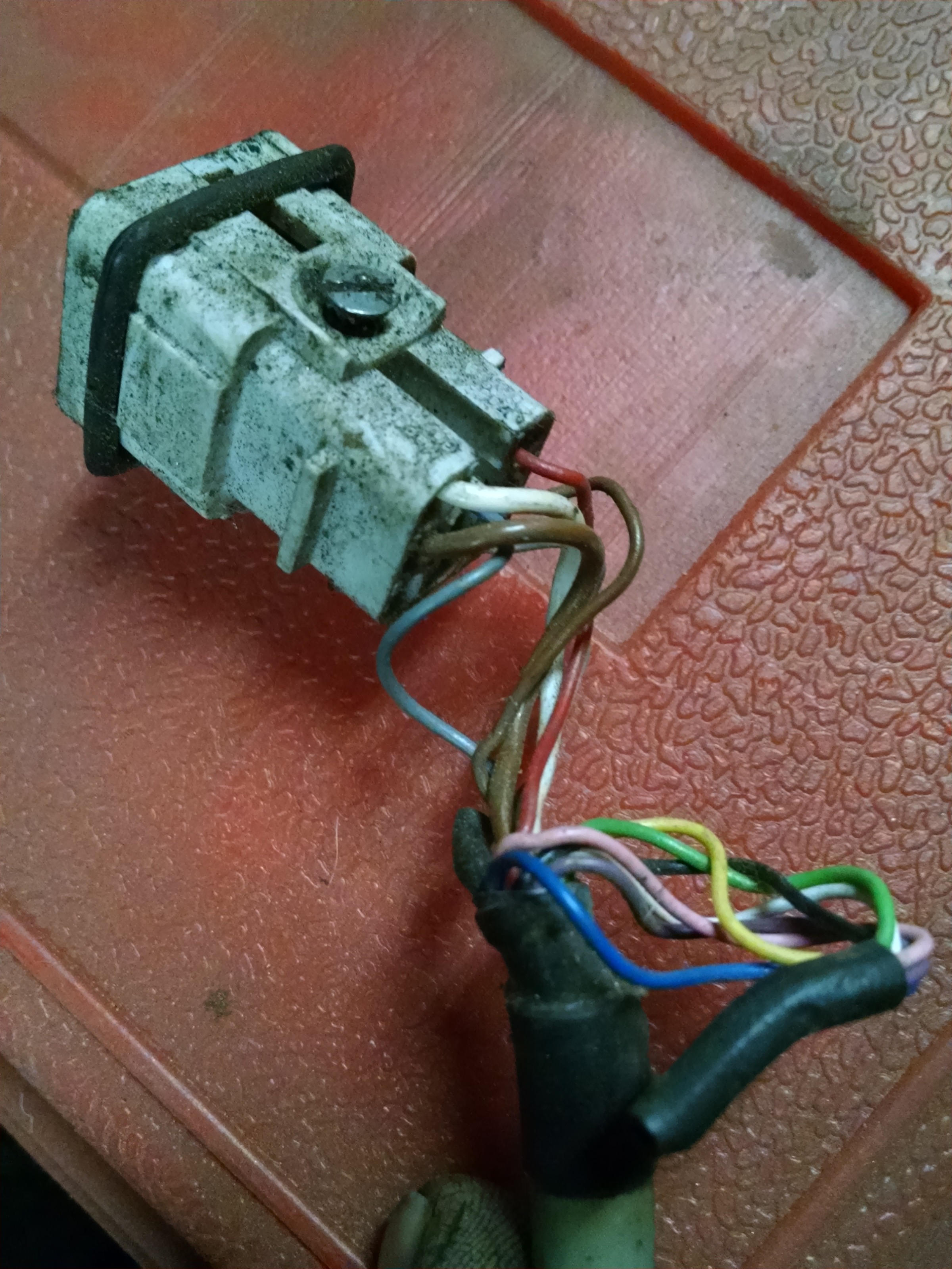

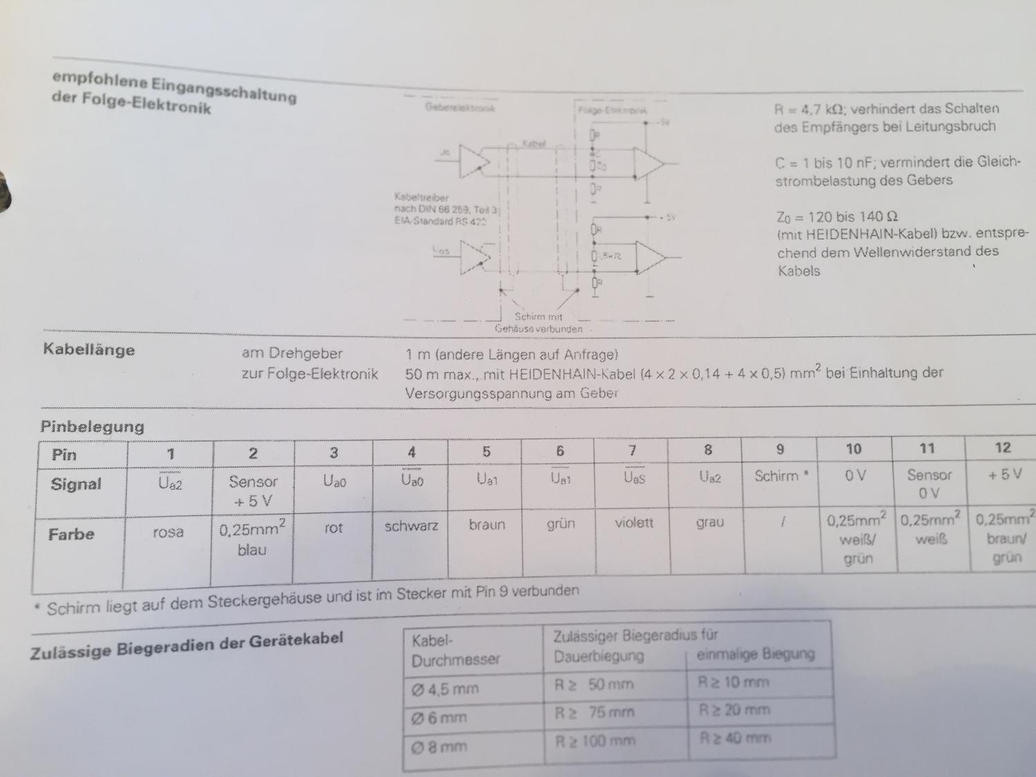

I still have not figured out a way to get a digital read out on the screen showing the position of the rotary table. Mine also has the rod271 encoder. My machine is a mh600c and I am running a 7i77, 5i25, and the original servo drives. I got some documentation on the rod271 but the wire colors do not match what maho used. Don't want to connect wrong and fry encoder. Need help with wiring and ini please.

My thoughts are it would help others , who may have a answer, if you could post your ini. file an the ROD 271 doc. I think the ROD 271 has TTL output so should be able to wire directly to your 7i77. Meaning that it doesen't require a Exe-Bd as your Heindehain scales do. Your documentation will note what the TTL voltage level is. Might be useful to get a Photo of the dissembled connector showing the pins an pin wiring. Darn pastel colours an OEM parts can be a bother.

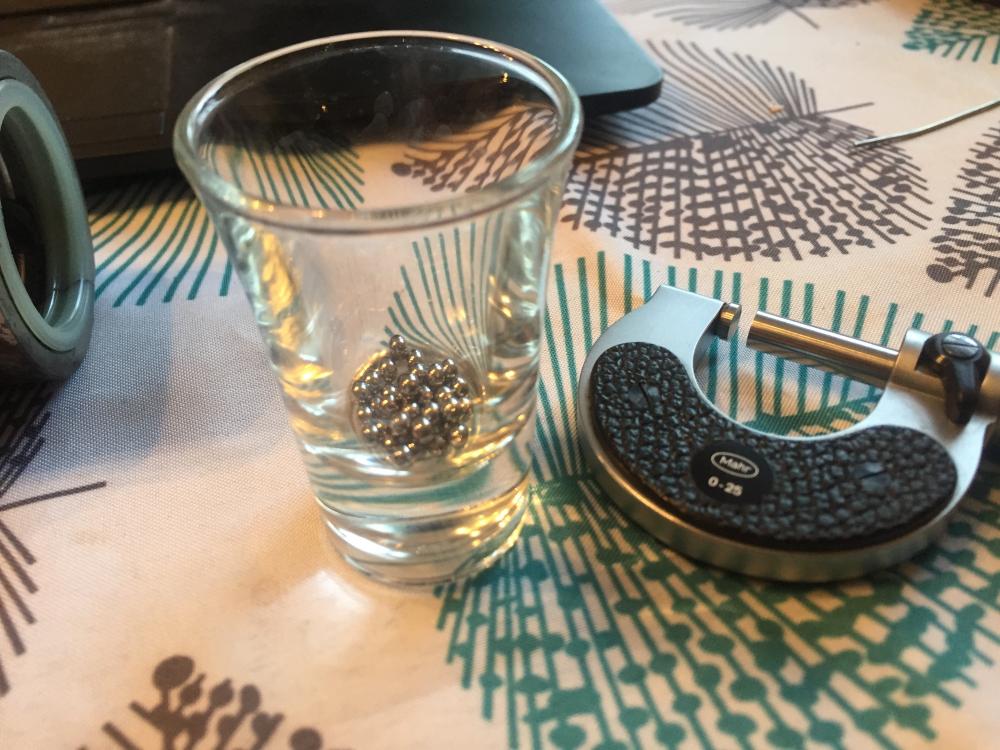

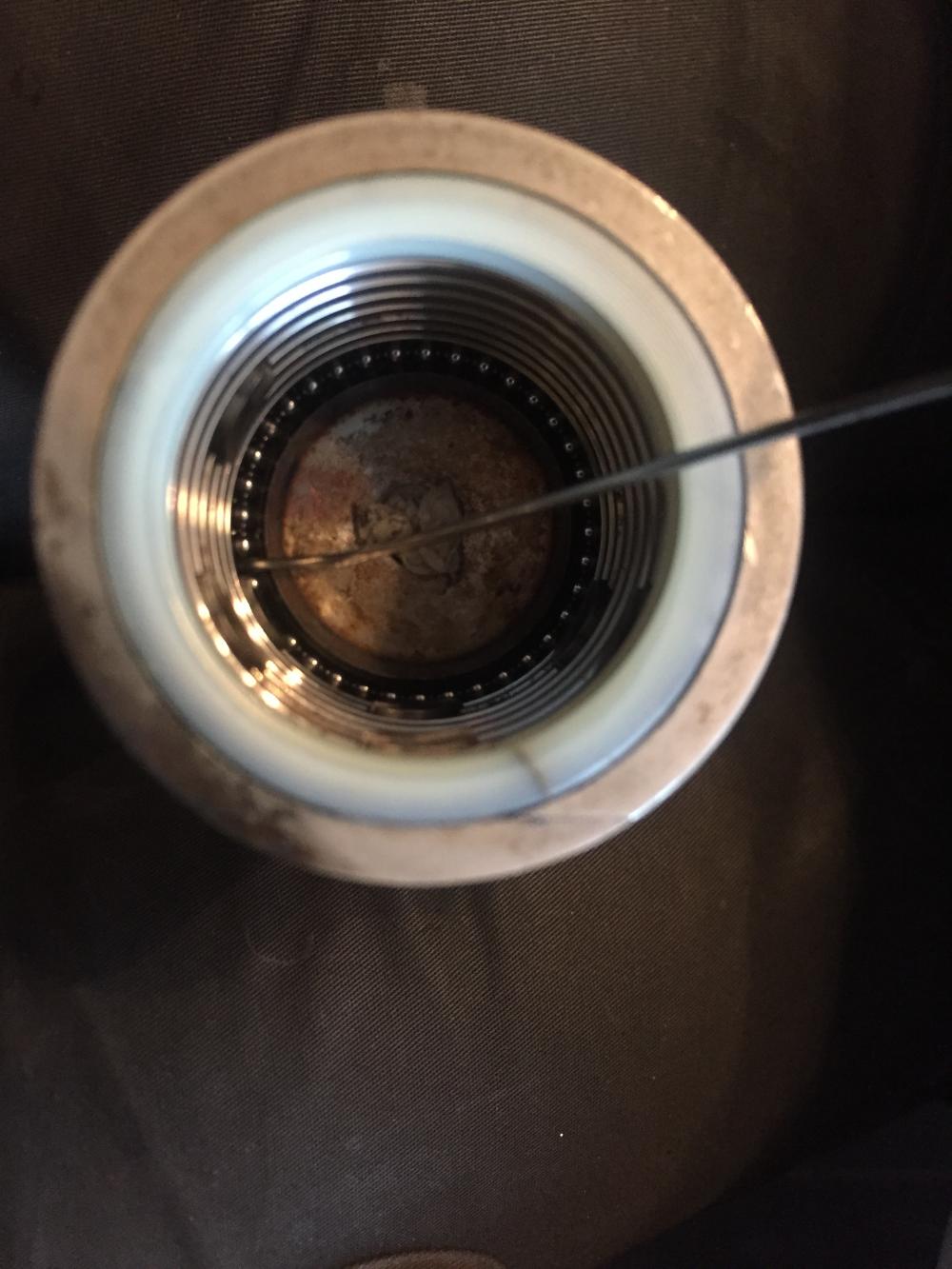

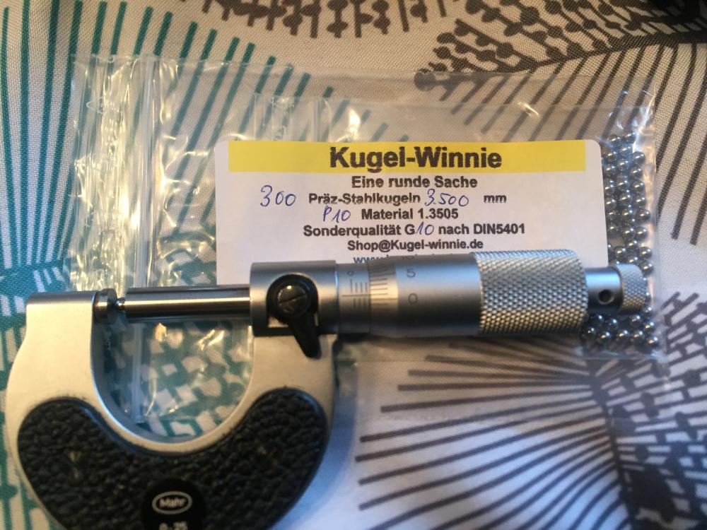

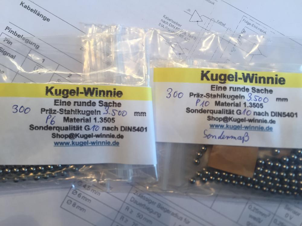

23 Jan 2020 10:19 #155522
by hanmon
Replied by hanmon on topic Retrofitting a 1986 Maho MH400E

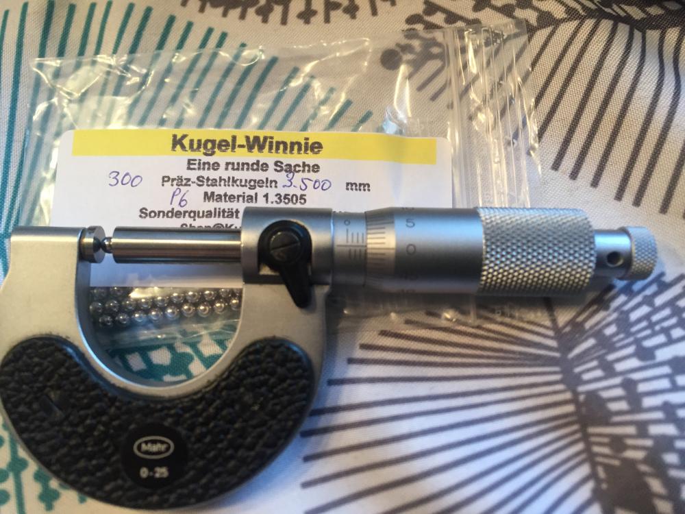

First of all no more jokes about my balls
37 per line is the correct number which gives a gap of 1.5mm.
The whole operation takes approximately 10-15 minutes and does not need any lubrication or auxiliaries.
- Count 37 balls in a jar and pour them into the nut having turned to a point where they can fall into the correct turn.
- Find the sweet spot where they just fit into the deflector.
- Use a non-magnetic needle, wire or screw-driver and push them all in.
- Turn the nut to the next pitch and continue
In my opinion it is perfect now with the P10 balls with diameter 3.51mm.
I can now still turn it with two fingers and sense a little pre-load, a little.
I think that someone has fiddled around before and filled in too few balls which lead to a jam that cracked one or more balls at the hardened deflectors.
The 240 balls before weren't enough, I'm sure. Now I have 259 in total.
(You can never have enough balls, lol)

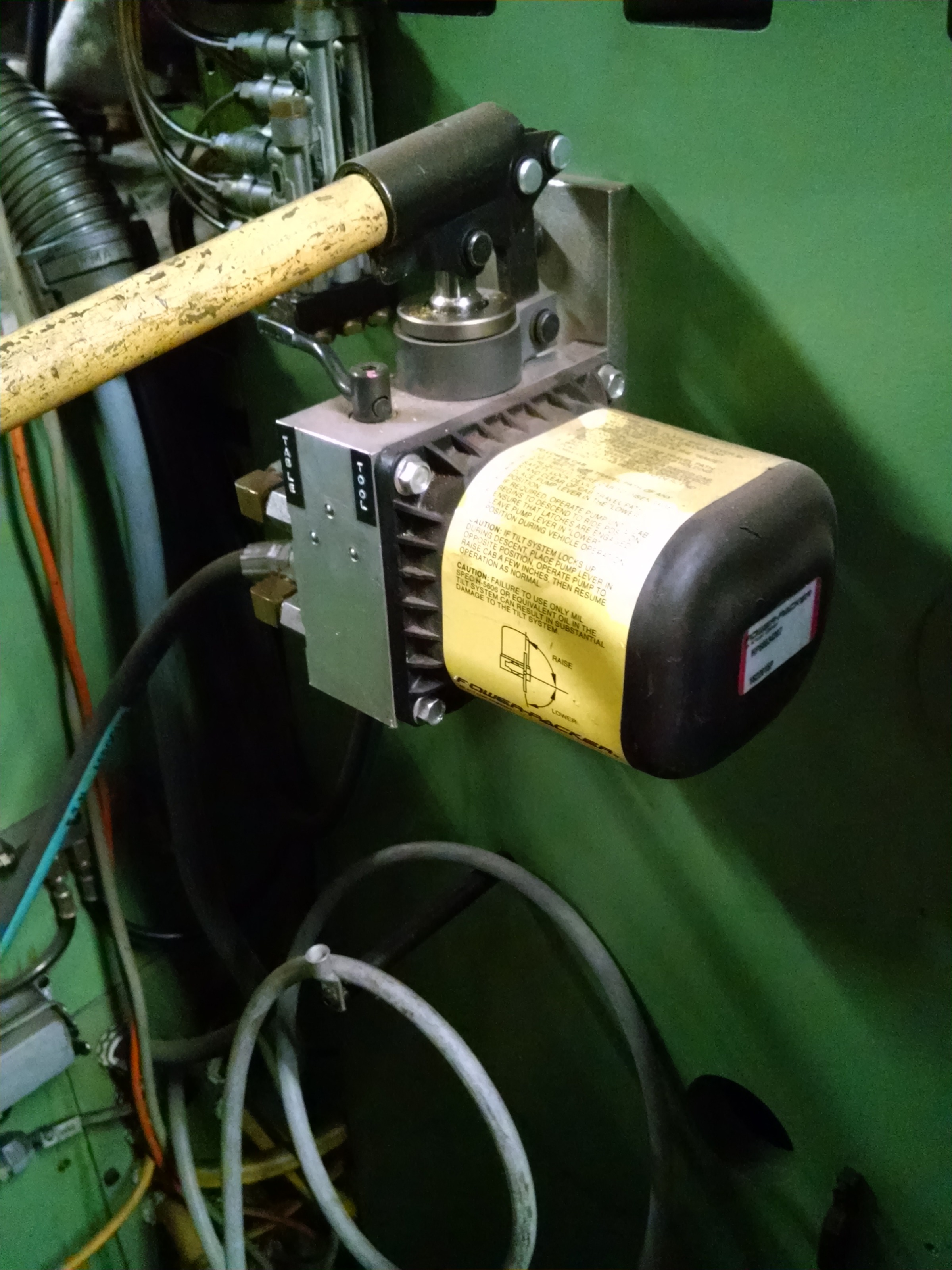

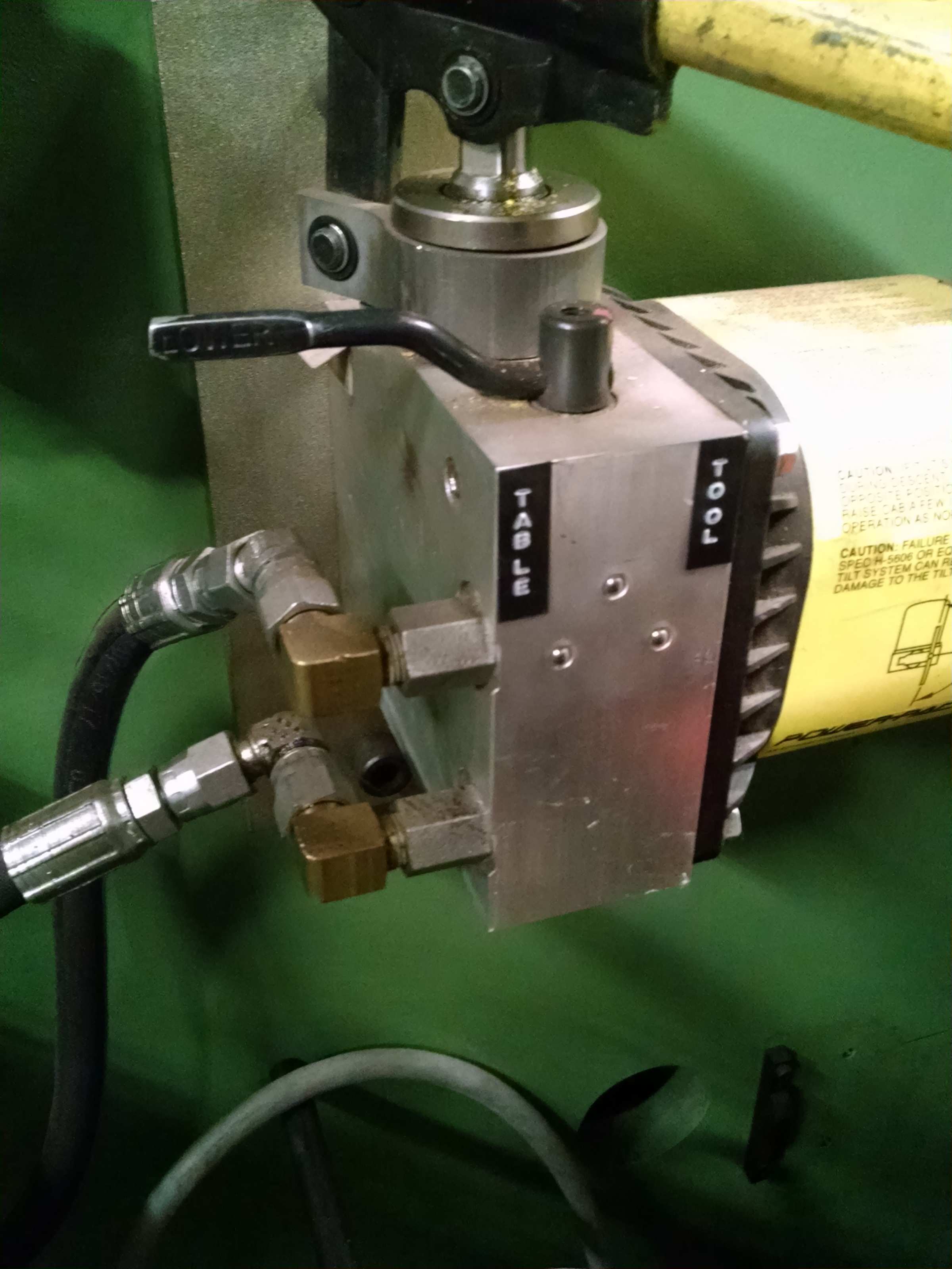

It is a manual table. The hydraulic release for table and tool have been changed to manual pump (originally designed for duel acting cylinder to lift a truck cab). Scales where Philips and I changed for Chinese 1um Sino brand scales. Working great. Have not even started ini or Hal for table encoder. I am not good with that stuff. Most of my Hal and ini where cut and paste from examples.

Looks like brown is +5v, white is 0v. What are Ua0, Ua1, and Ua2? I'm assuming ref, A, and B.
I don't mind not using a reference. Want to be able to manually home table to 0 degrees and have DRO function separate from cnc functions.

On Heidenhain linear scales, Ua 0 is the reference, so that is probably consistant across evrything they do.If you have the ref signal you may as well input it to LinuxCNC. If you input that to LinuxCNC, you could probably quite easily have a workflow to manually zero that axis with a lot less hassle than setting up a DTI, and probably more accurate and repeatably.
