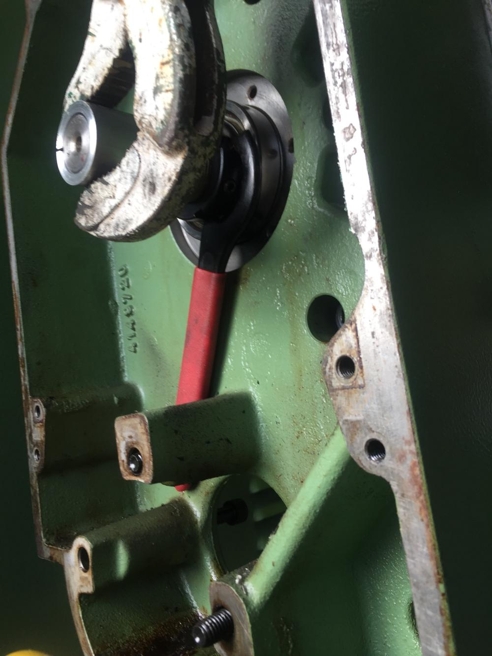

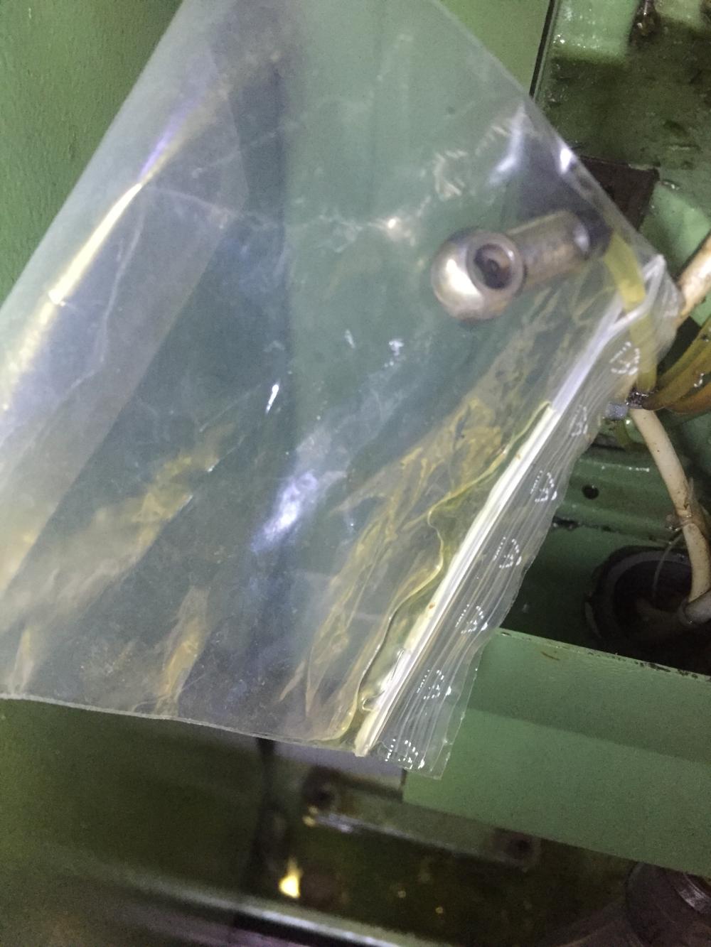

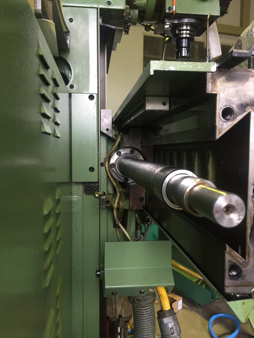

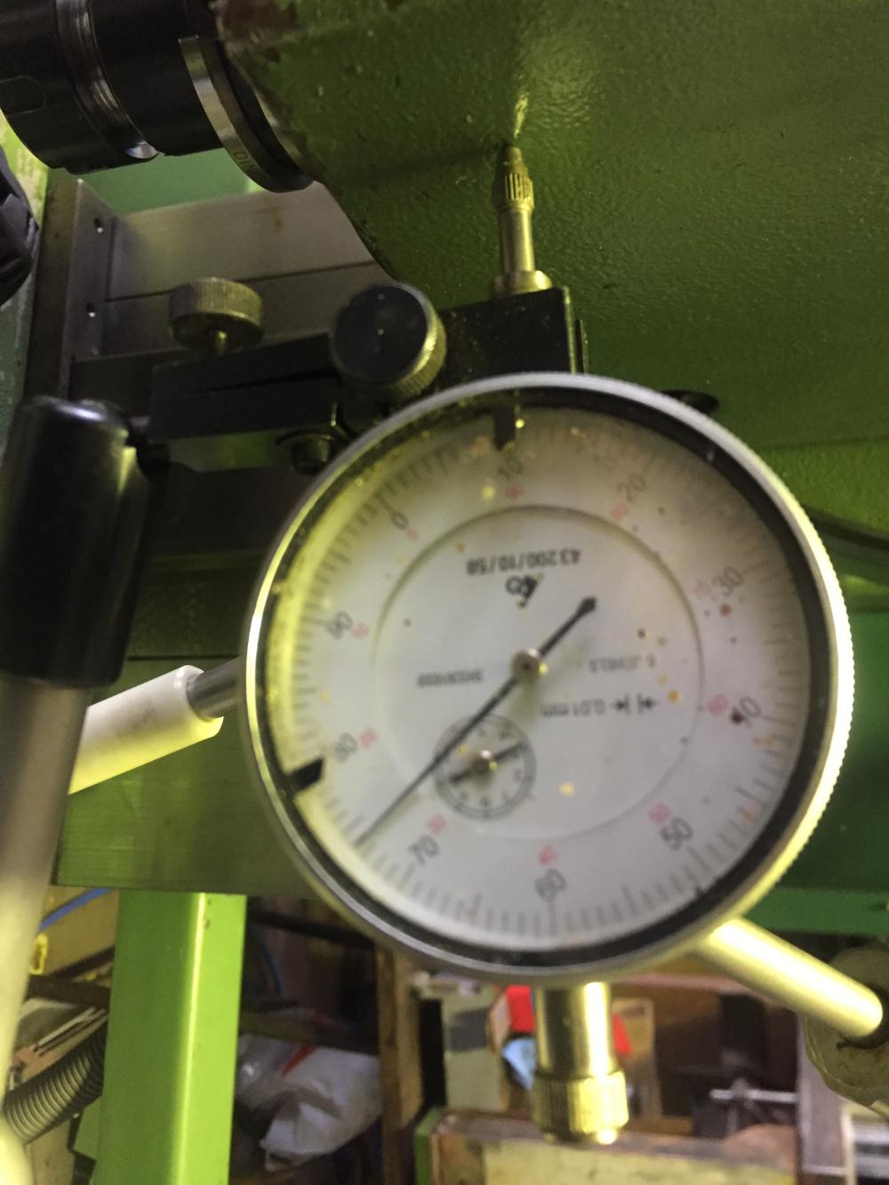

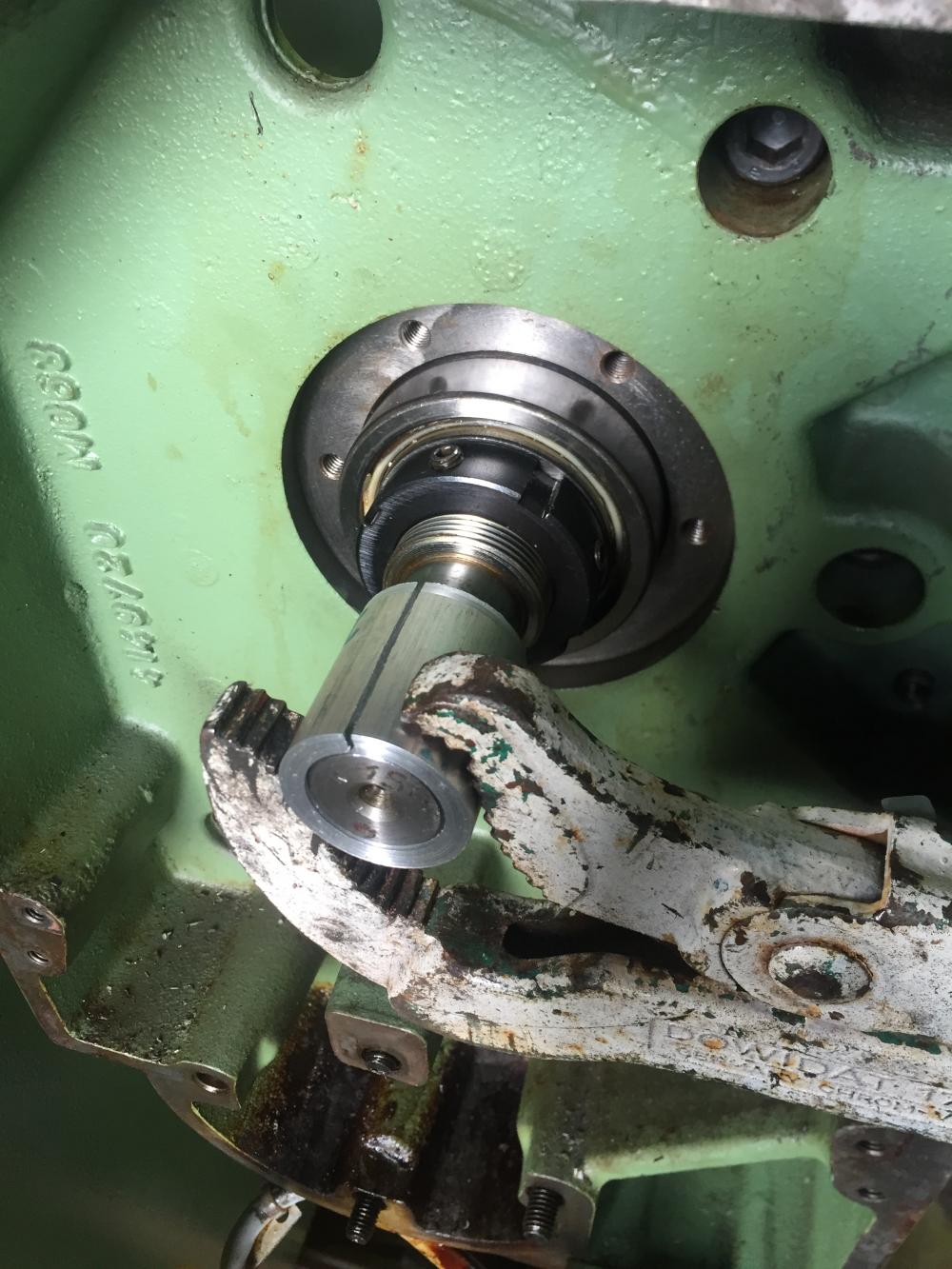

@Mark: literally ROFL

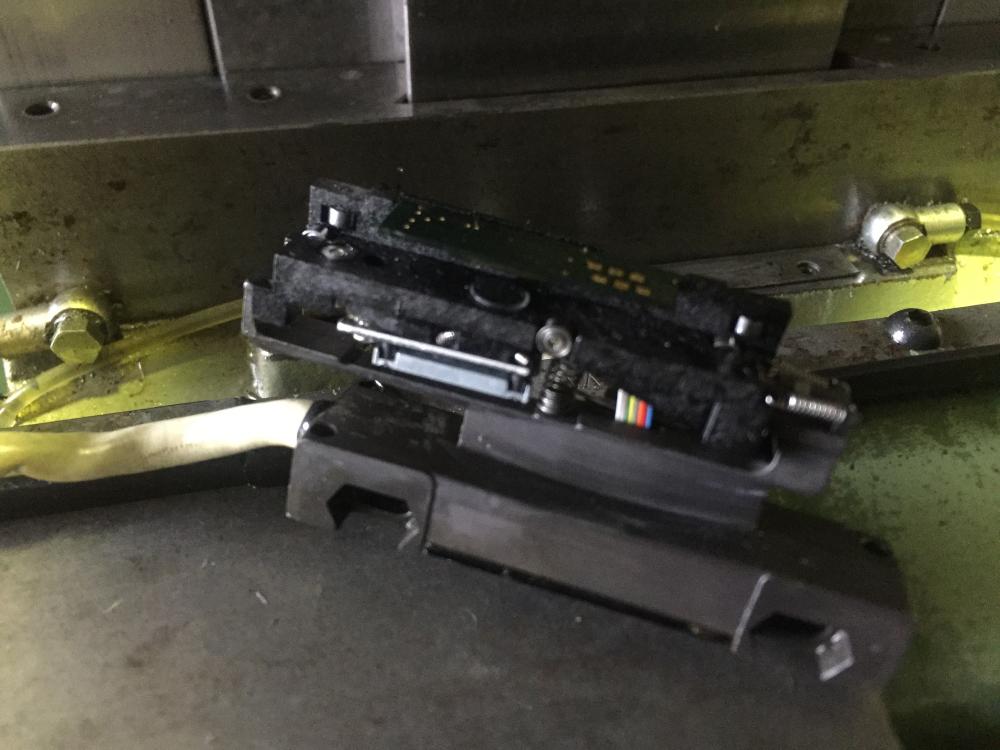

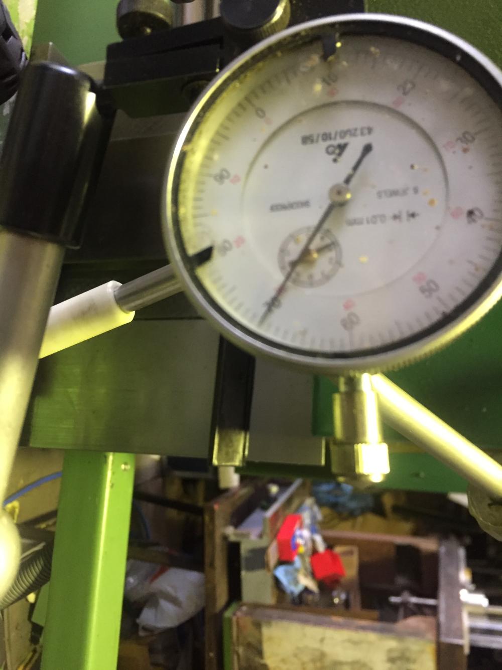

I'm really excited.
Put everything back together and the Axis works like a charme.
It runs MUCH smoother than before and even the 1/1000 digit doesn't wobble anymore.
Of course, here are the pics.
Do NOT lose the soft inserts (Aluminium):
Ballscrew back in place:
A LOT of oil pured out of the cable-tube:
Torque-wrenched the screws to 15Nm,
I don't trust the regular 10Nm for M6 8.8 :
Turned an Aluminium protection bushing:
Scratched a marking:
I'm really excited.

I'm seriously considering changing the balls in the other spindles, too.
I will check and adjust the wedges, measure a lot and then decide how to go on.
For now I'm really happy !!!
