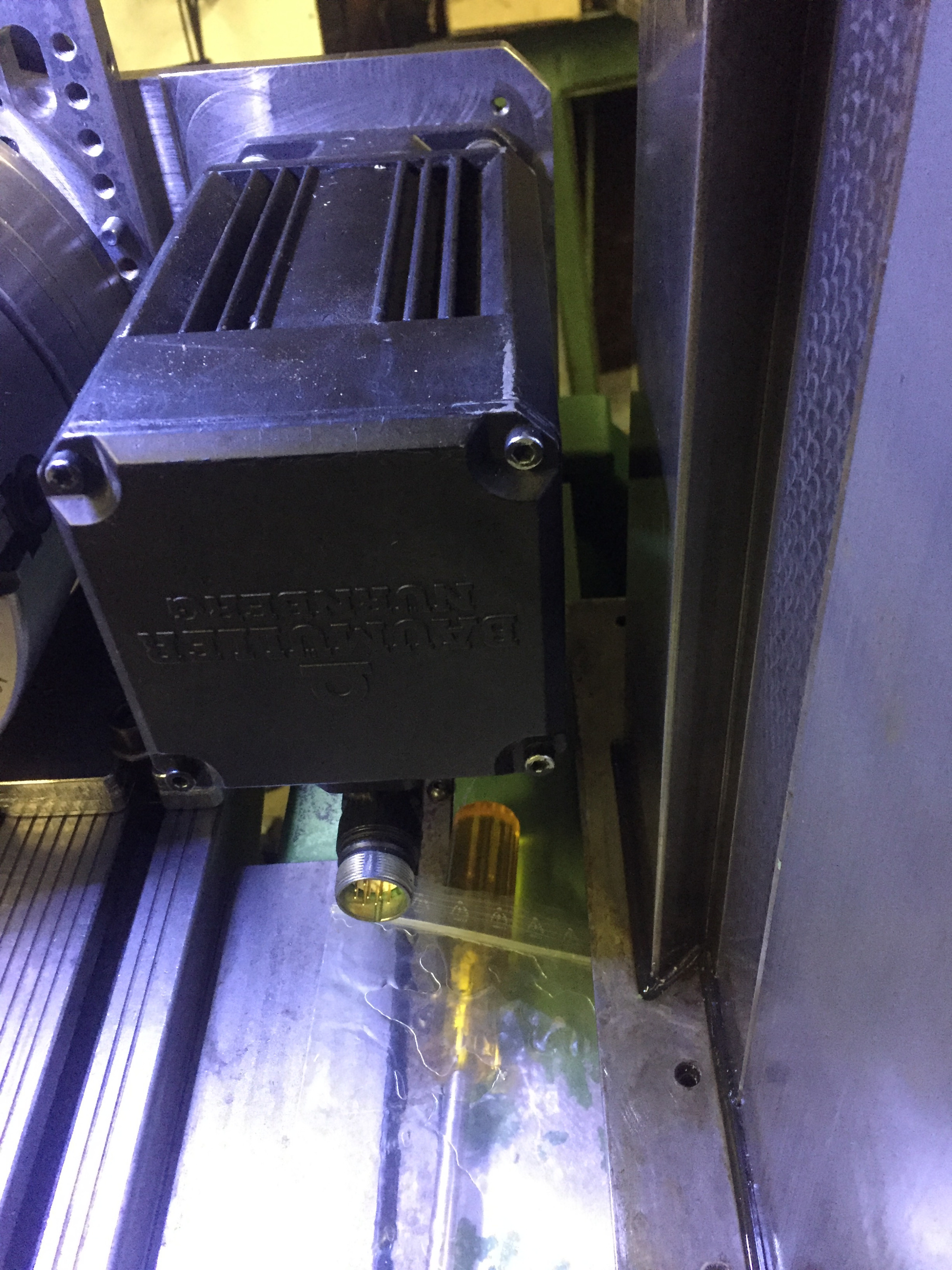

Hi there,
did some little adjustment to the table.
It was almost perfect just sitting in the fitting-keys.
The cleaning of the contact surfuces really did it.
cloud.monschan.de/index.php/s/xzb9BMs4T2wRaKi
cloud.monschan.de/index.php/s/yH5qHWQ7cepm8Ap

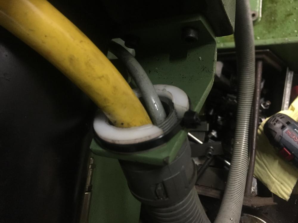

First fit:
The original plastic nut literally turned to dust.
Don't know if it is correct, but I made the thread M38x1.5

Hi Mark,
your videos are really nice. Tutorial like,entertaining, showing the essence of your work. Exactly how I like them on youtube.
It is almost zero, more like 0,005mm which seem to be the factory tolerance.
The table and the X-axis are perfect now according to my estimation.
Does anyone know the specs MAHO delivered their machines with?
How are the specs on such machines, generally ?
Z is hard to measure, as the weight continuosly pushes down but stabilizes on the other hand.
Y is easy like X and I will adjust it soon.
I'm currently connecting the A-Axis and tuning the Servo-Controller.
