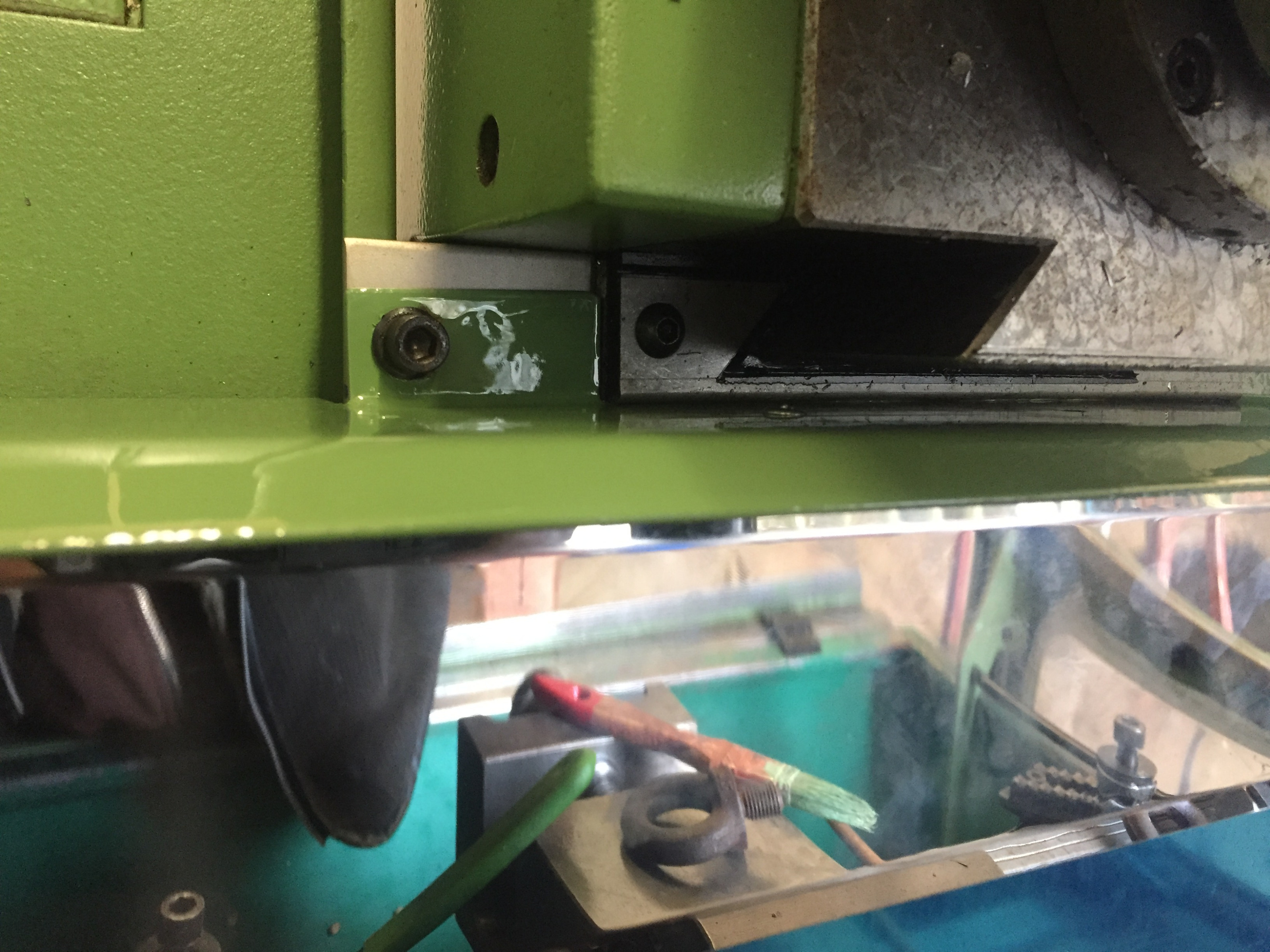

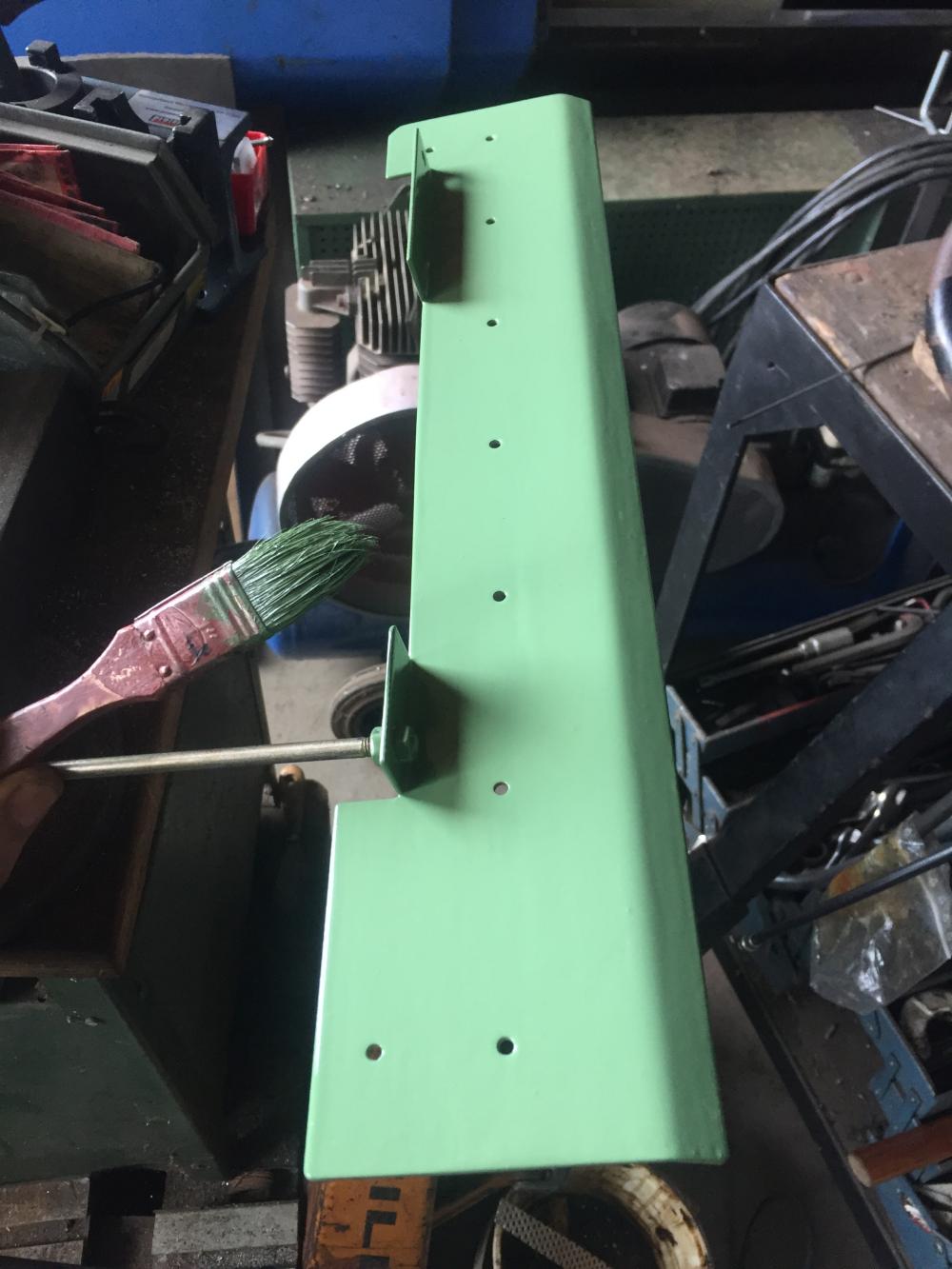

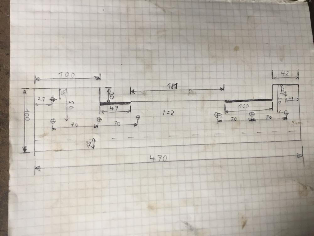

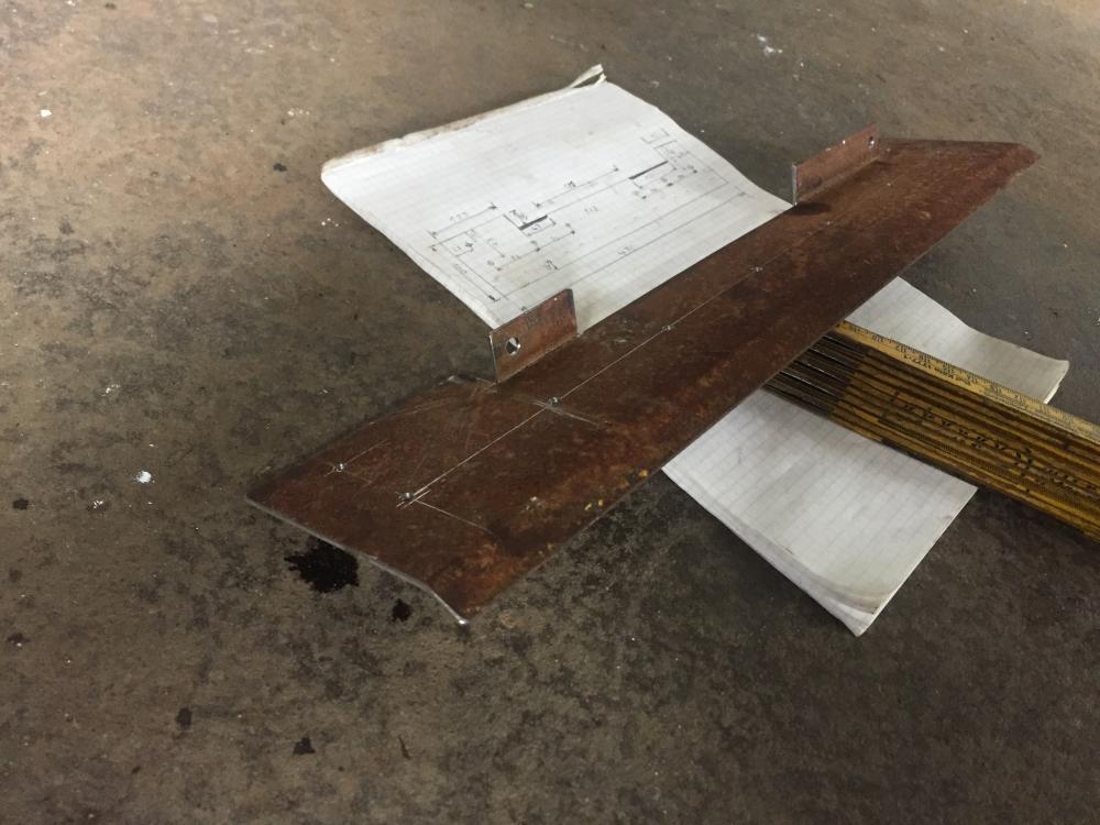

12 May 2020 14:05 - 12 May 2020 14:47 #167526
by hanmon
Replied by hanmon on topic Retrofitting a 1986 Maho MH400E
Hi everyone,
I've been very busy the last couple of months due to Corona.

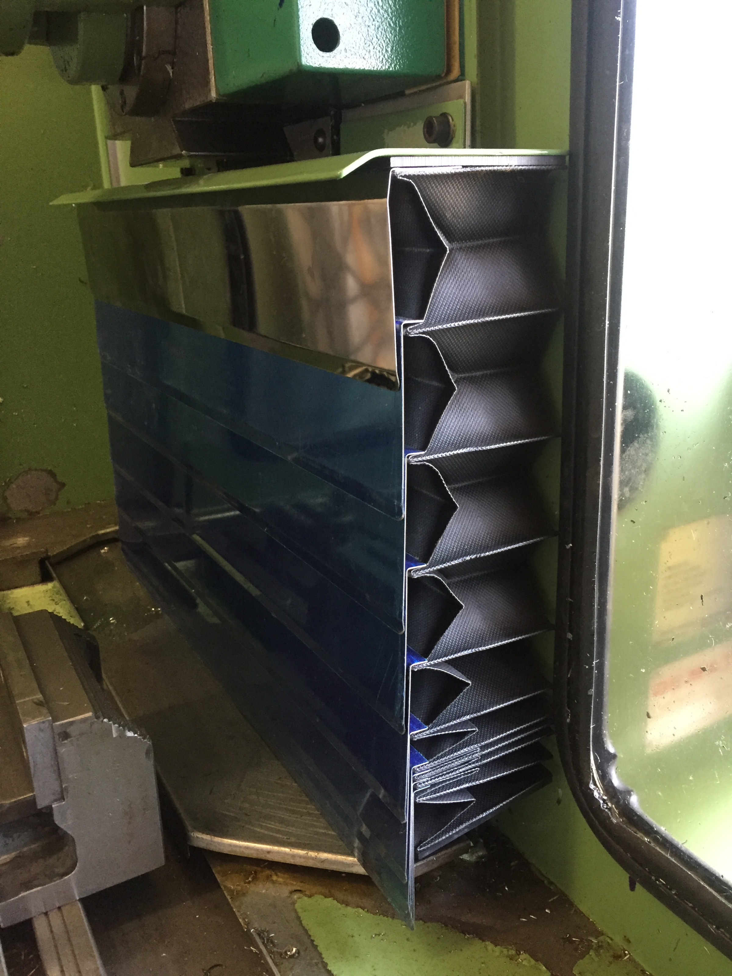

Here are my latest protective measures
The cover was half the price last year:
www.aliexpress.com/item/32386329085.html...1.0.0.52034c4duhsWhv
A picture of the full assembly will follow tomorrow, as the paint is still wet.
Cheers
Hanno
Cheers
Hanno
Last edit: 12 May 2020 14:47 by hanmon.
The following user(s) said Thank You: J Green

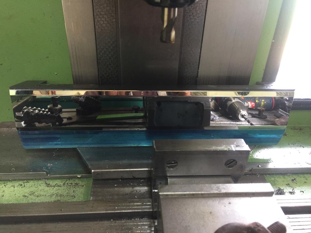

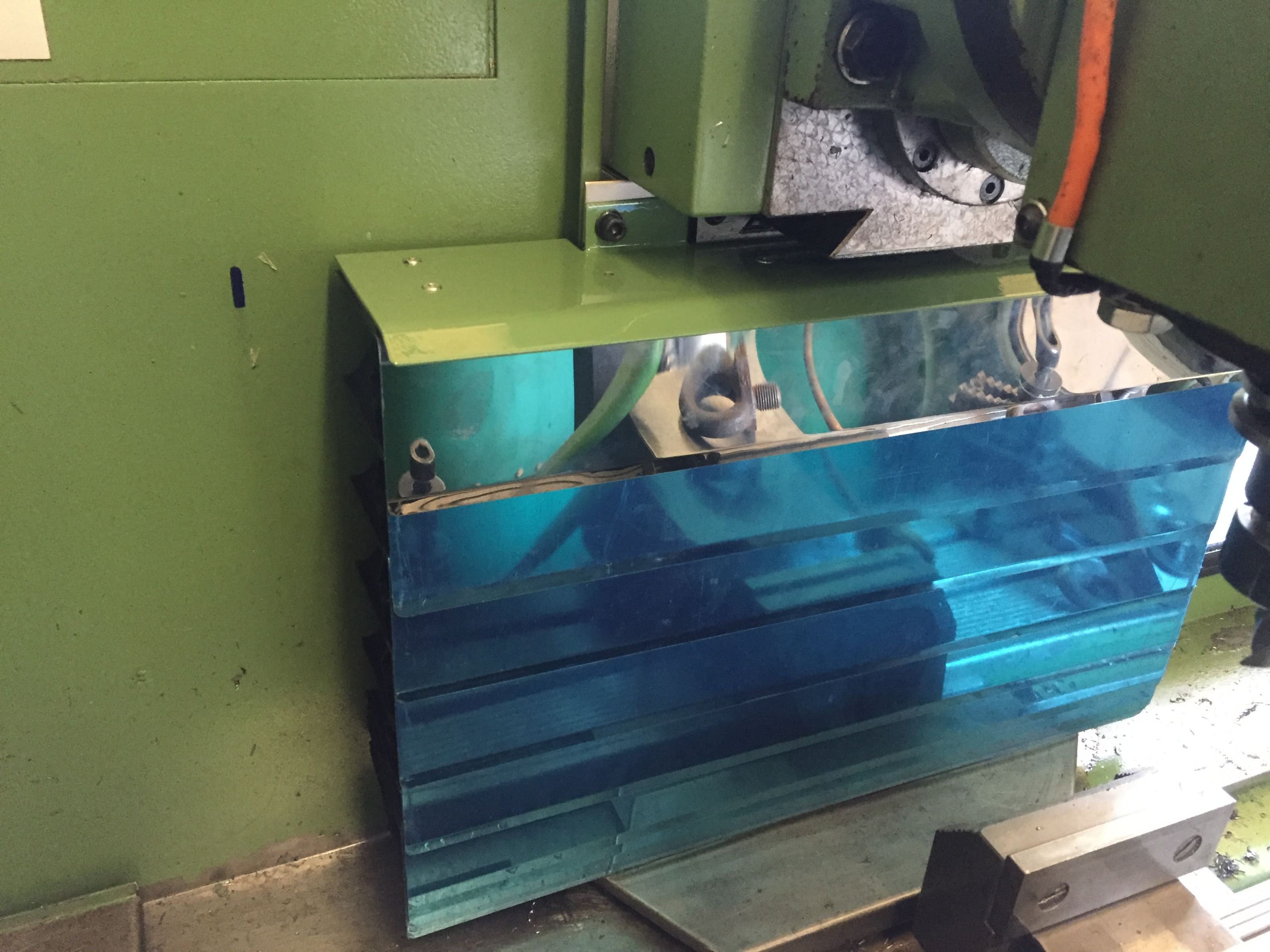

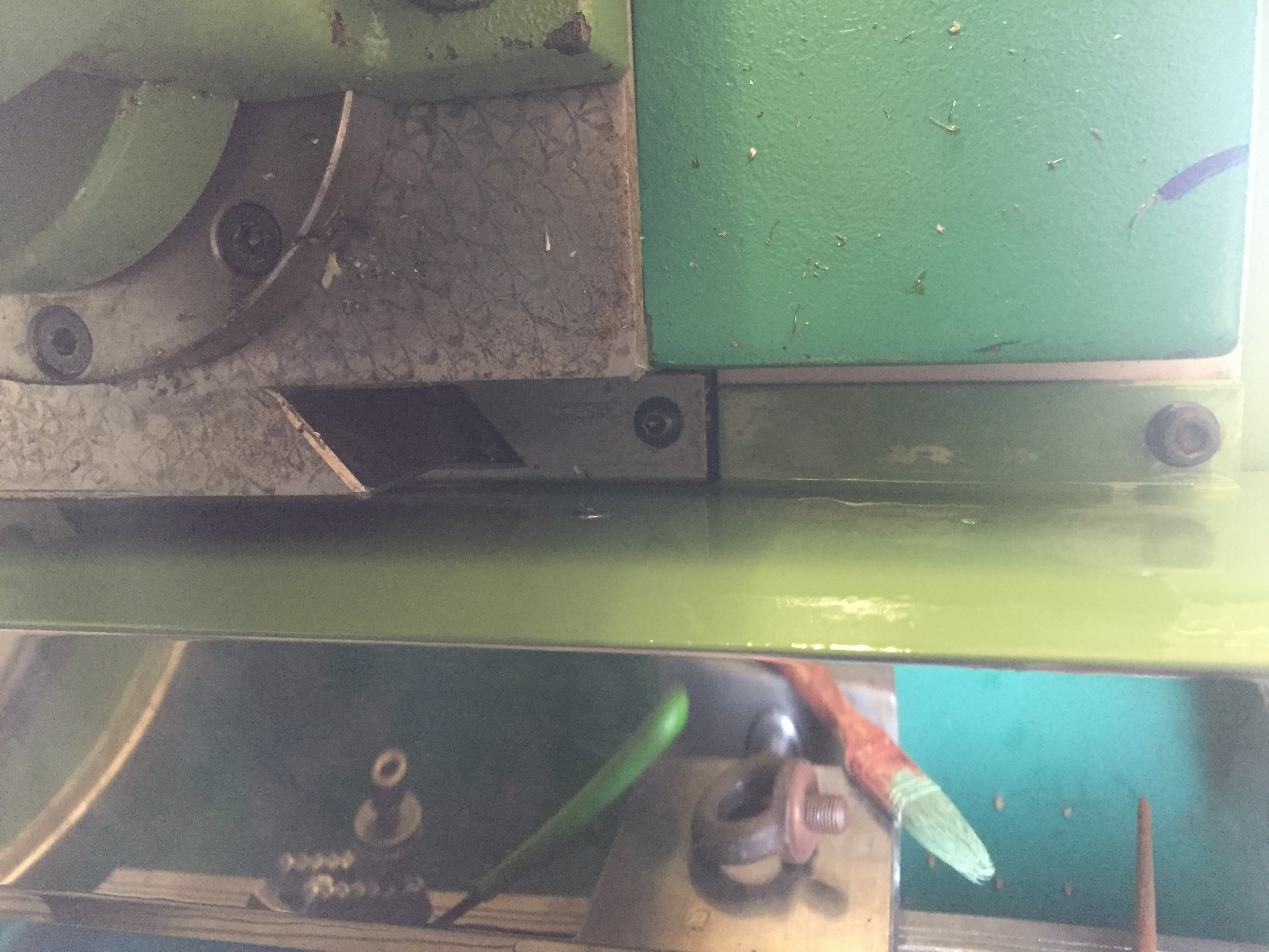

13 May 2020 09:52 #167638
by hanmon

Looks as if you guys have been productively busy. Hanno - thanks for including the extra details, the bellows cover looks great. What is the latest on the rotary axis?

Are those Z axis bellows covers MAHO parts, or did you get the chinese to make them for you? My Maho could also do with a fig leaf to modestly cover her exposed parts

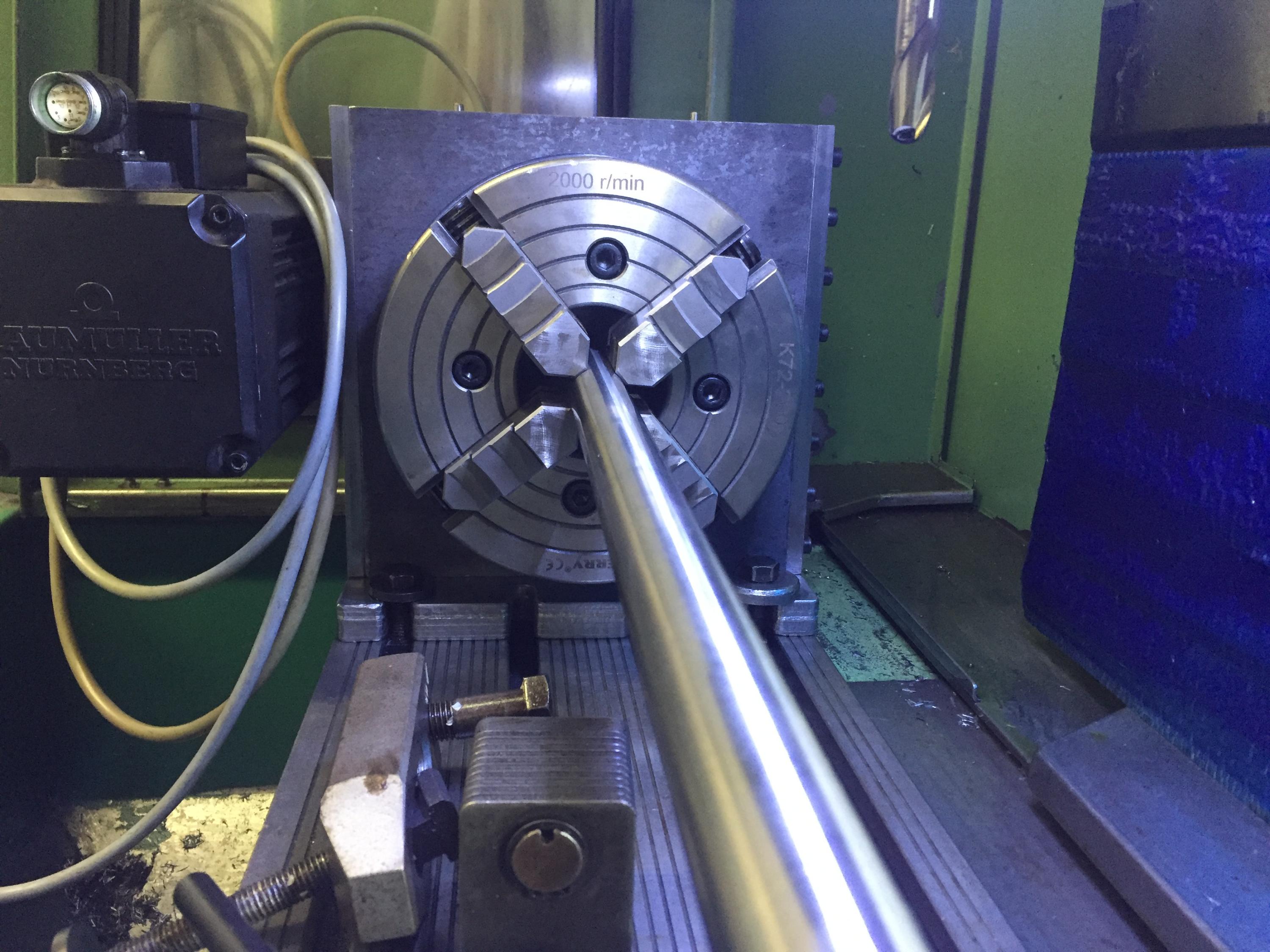

- hanmon
- Posts: 73
- Thank you received: 23
20 May 2020 15:44 #168387
by hanmon

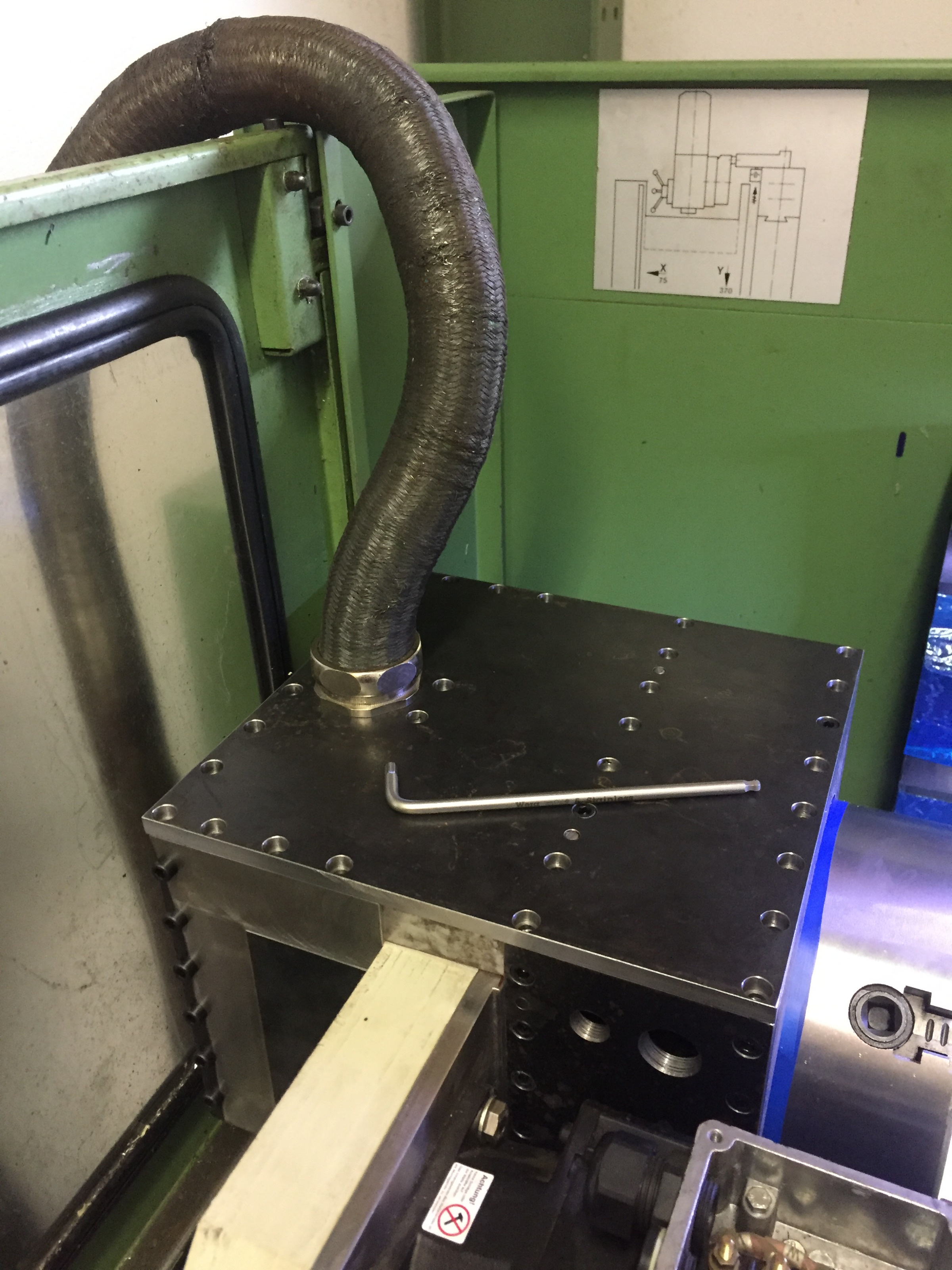

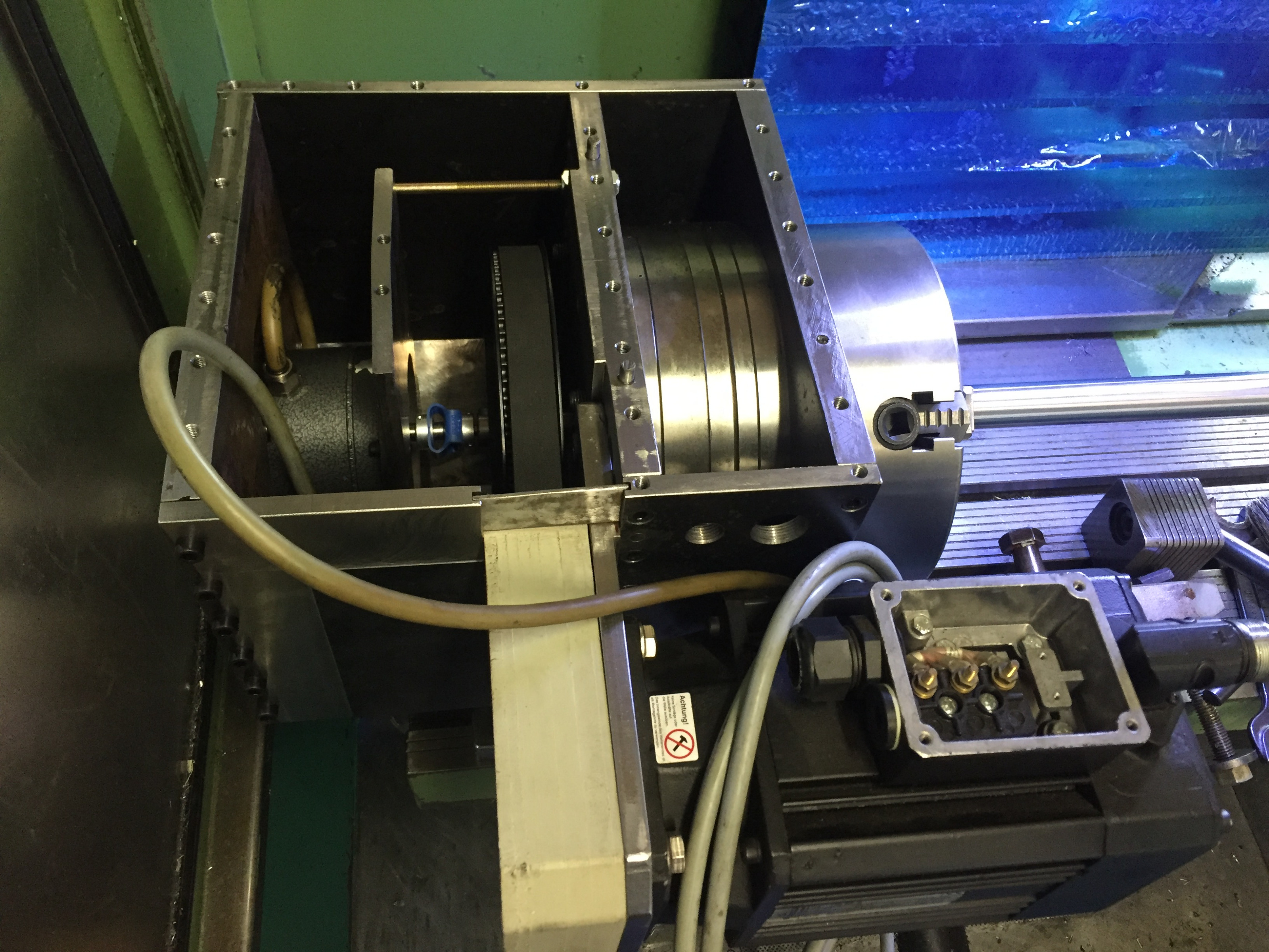

Axis:
I had to swap the servo to the front-side, as the bellows cover was a little too big unfortunately
Now the servo is a little bit in the way, when adjusting the chuck.
I mechanically adjusted the Gear/Chuck etc. to be perfectly parallel to the table yesterday and installed everything.
Next step is to wire everything up and finally paint it green.
